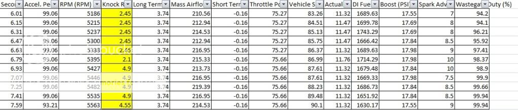

i'm still learning this stuff but your a/f's look alittle crazy here and there. and they seem to be all over the place.
for instance, plot 13,17,and 23 the a/f's jump pretty high. lean that would be, i think. but your still making boost.
also you should log ltf's.
knock looks fine though. oh, and you should mention what you did. i.e. 3rd WOT.
yeah, i noticed that too. fuel was a little rich as well. thats the first i've seen knock in any of my logs. but now that i think of it thats the first i've touched 5th gear in a log.

how is this format?
That's a million times better, lol. AFRs in rows 13, 17, 32 are high because that's where he shifted, and AFRs hit 29ish during shifts. Next time log Accel Ped Pos% and LTFT so we know when you're dipping into WOT, and when your ECU is calling for WOT afrs. The KR looks great.. ignore anything at .35... the KR sensor goes deaf at high rpms, and .7 is nothing I'd sweat at ALL. Your fuel pressure looks great too, but don't get too comfy with it. My fuel pressure was just as strong with the stage 2 map too, but I caught it trailing under 1,200 and 1,000 PSI a few times, and upgraded to a hpfp. Was my stocker keeping up? Yeah, most the time.. I guess... I wasn't logging everytime I went WOT. Am I happier now with my hpfp that holds 1700-2000 PSI always from 3K to redline? Damn straight! One less thing I have to worry about!

Just installed the Denso ITV22's on my 07 MS6 and took it for a spin today. Now noticing KR spikes of around 4.9 in the upper RPM's. At one point under sudden load, the AP said I had a KR spike of over 8 for a quick second, but I wasn't logging at the time. I'm 100% stock except for the AP with the Stage 1 93 1.03 installed. I ordered a COBB SF, and I'm waiting for it to come in since it's currently backordered from COBB. I was hoping to get these knock issues pressed out before I put the new intake and map on.
My Denso's are currently gapped @ .030. Do you guys think I should back the gap down to .027 or so??

The three most common answers to KR usually are:
Run better gas
Pull some timing or
Back off the boost.
What are your throttle request loads at?
Run better gas
Pull some timing or
Back off the boost.
I'll do some more logs later this morning and record the TRL. I'm just running the stock 93 map on MD 93 octane, and I wasn't having this much knock before with the FoMoCo stock plugs. I'm gonna close the gap some and see if that helps too.
