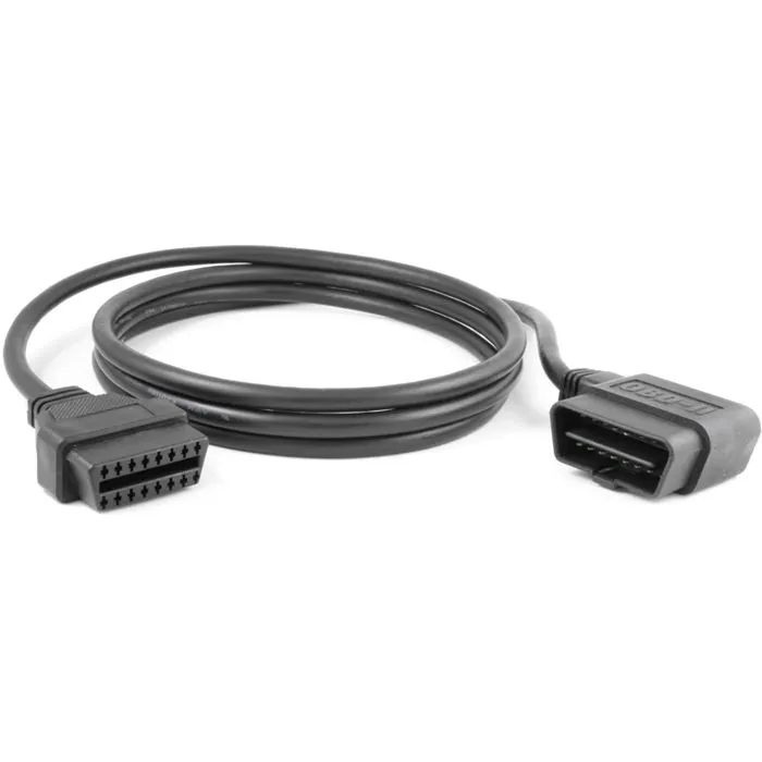

i switched to cobb's v102 93 and 91 maps, and have experienced knock in both, is it recomended that i switch back to a v101 mzdspd map instead? i have very minor mods to be pinging, although it is 90+ degrees out. i cant tell if its just the heat or not, i cant log until i get a solution to the dongle being in the way of the brake pedal.
I'm having a similar problem with the clutch pedal in my 8. This is what I am thinking of using. Sorry if it is a repost just trying to help. It took me a while to find, mostly because I didn't know what to look for.
http://www.obd2cables.com/products/obd-cables/obd-ii-cables/?p=2
I think the one pictured below would work pretty well for me at least.
