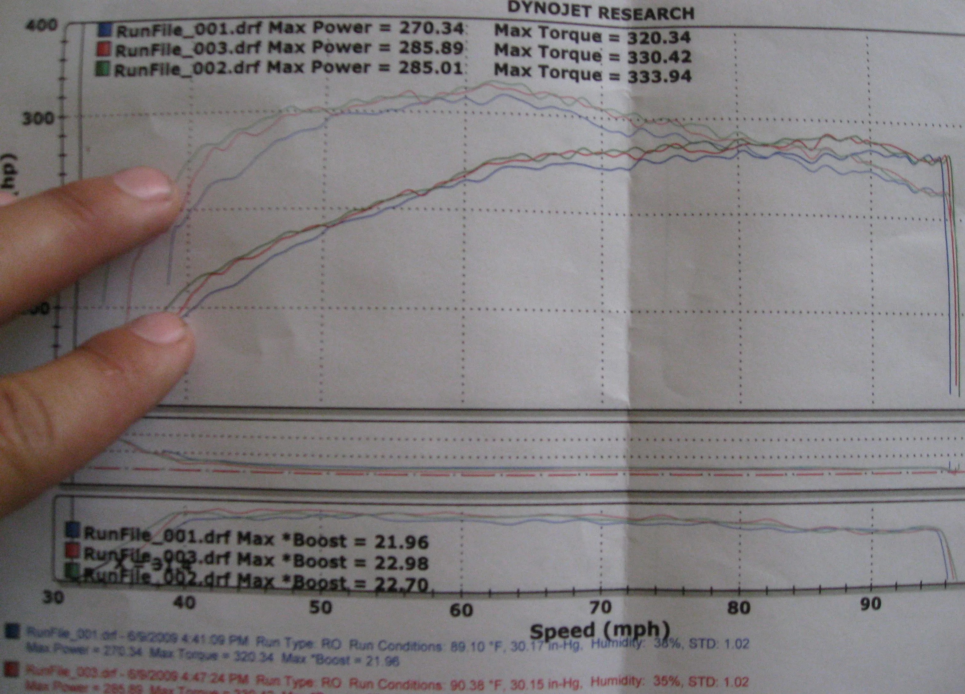

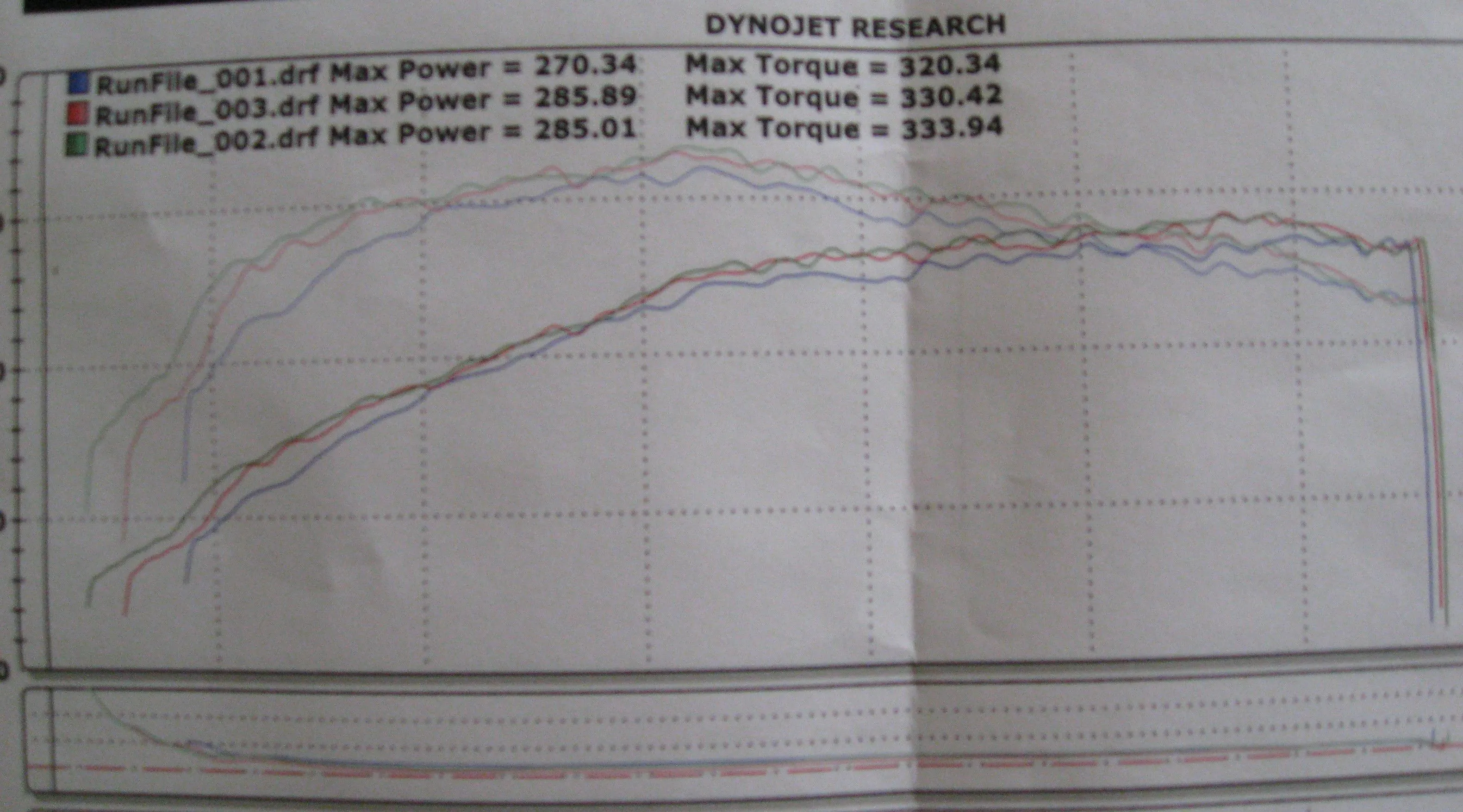

4th gear pulls: first is stage 2 TMIC 900 idle second and thrird pulls are the changes i made... i point out the changes i was after making more peak torque way sooner trying to play of that dinky little turbo...
stage 2 alone 270 awhp 320 tq (4th gear)
stage 2 changes 285 awhp 333 tq (4th gear)
