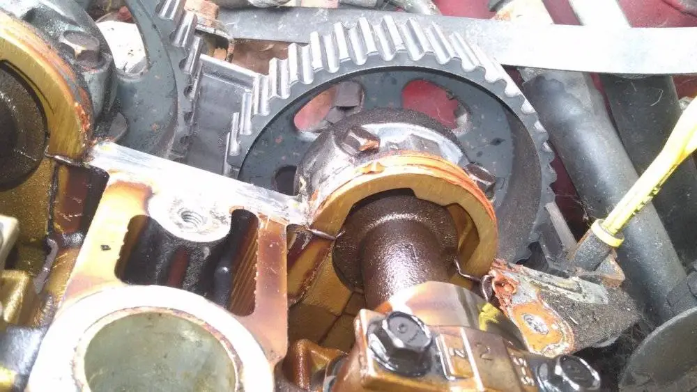

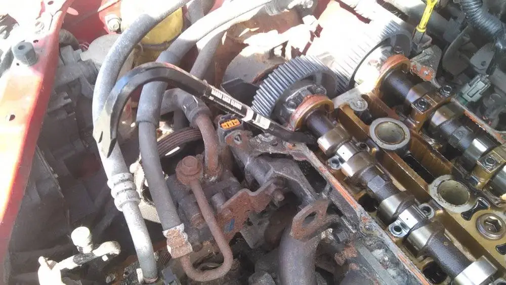

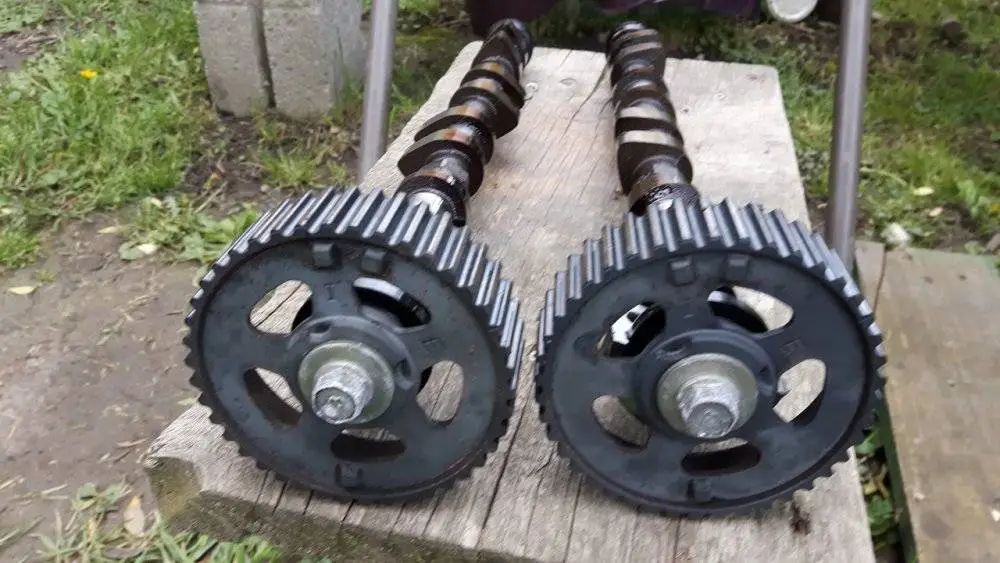

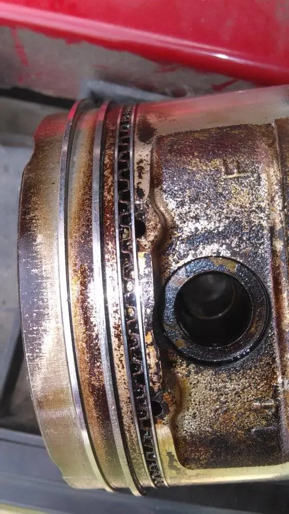

CTt3P5 was one of those people who bent a valve when his timing belt snapped.

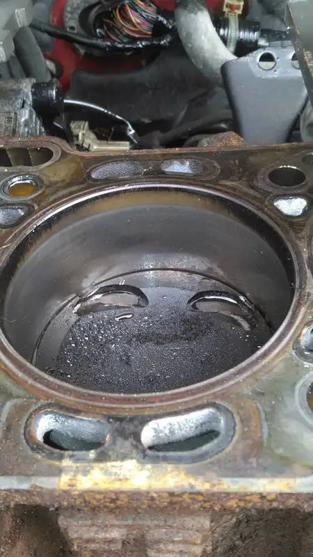

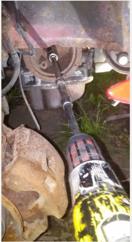

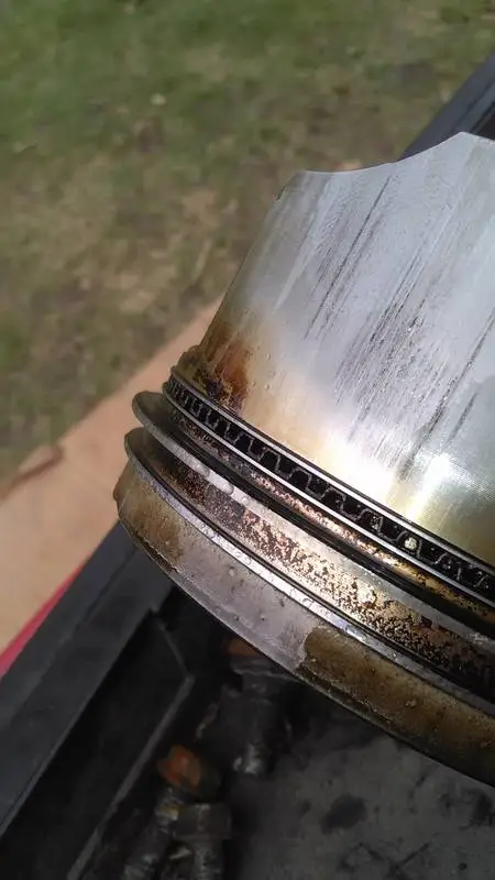

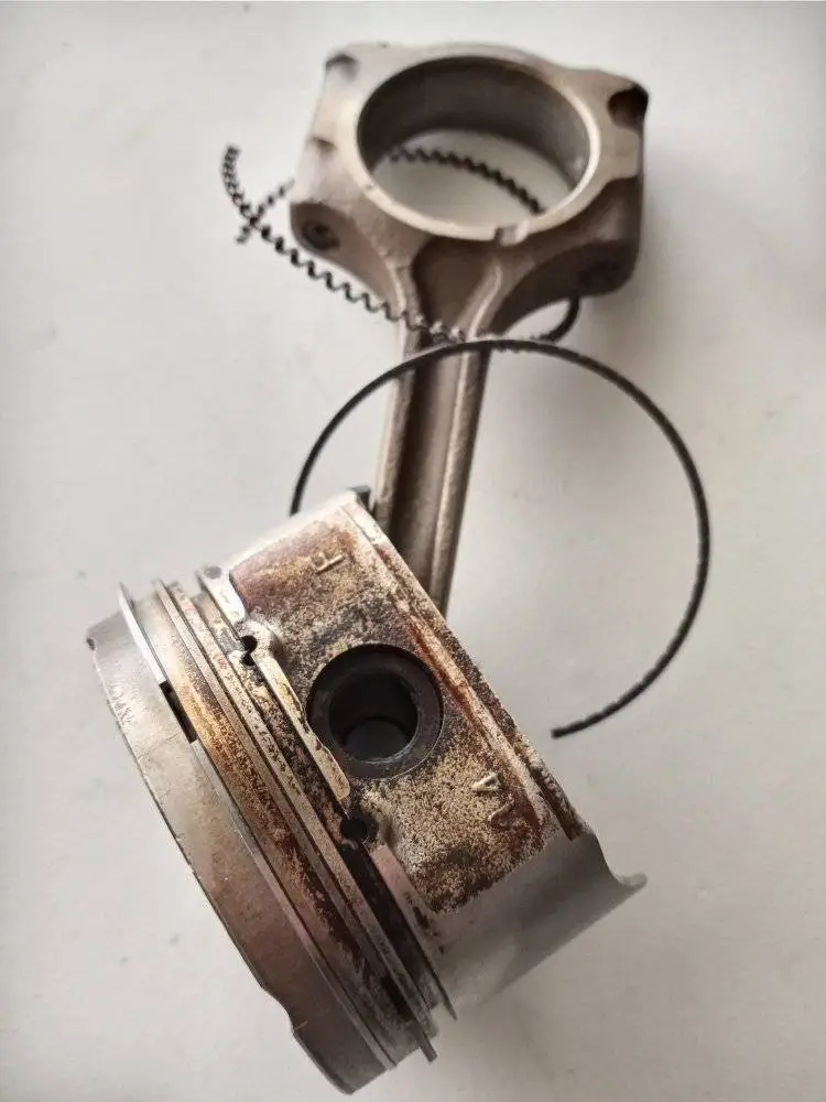

I did open the engine on my parts car to investigate and remove a piston.
View attachment 308105 View attachment 308106 View attachment 308107 View attachment 308108 View attachment 308109 View attachment 308110 View attachment 308111 View attachment 308112 View attachment 308114

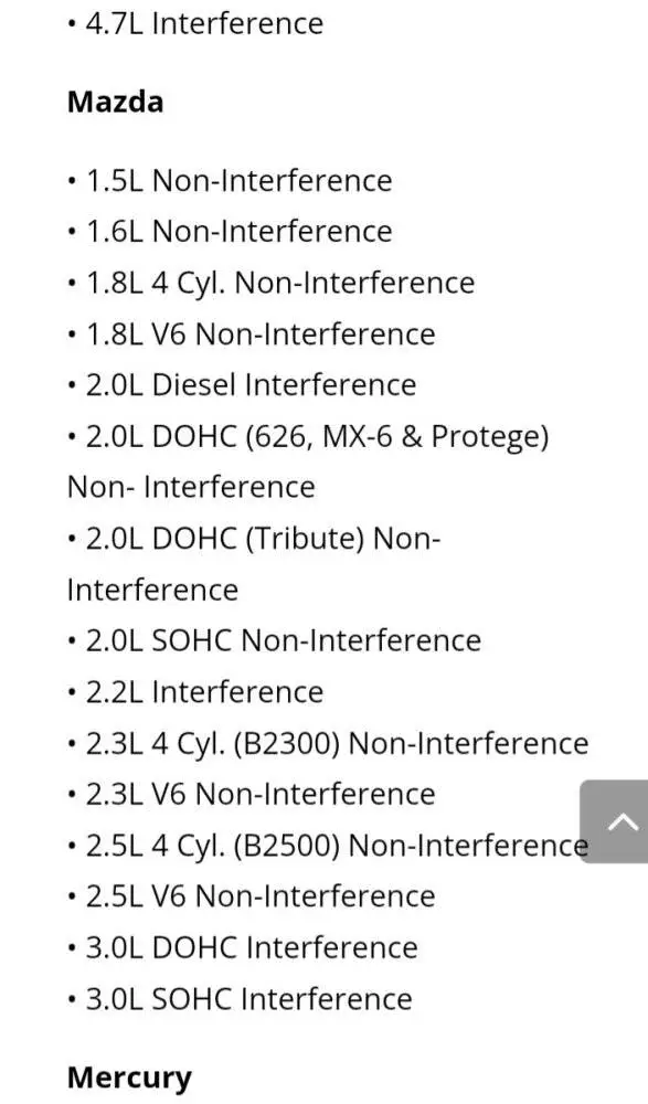

All Protege5's in North America have the same engine.
And as mentioned our engine is supposed to be a non-interference engine.

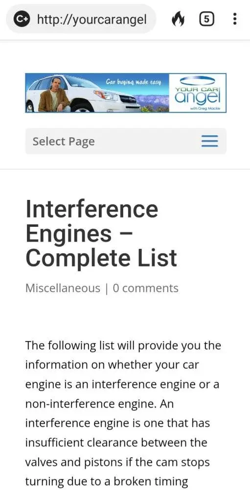

I Googled this,..
Make sure that you can trust your mechanic.
There's a lot of BS surrounding this issue.
Maybe send your mechanic this link before he does the job.
There is a lot of useful information.
