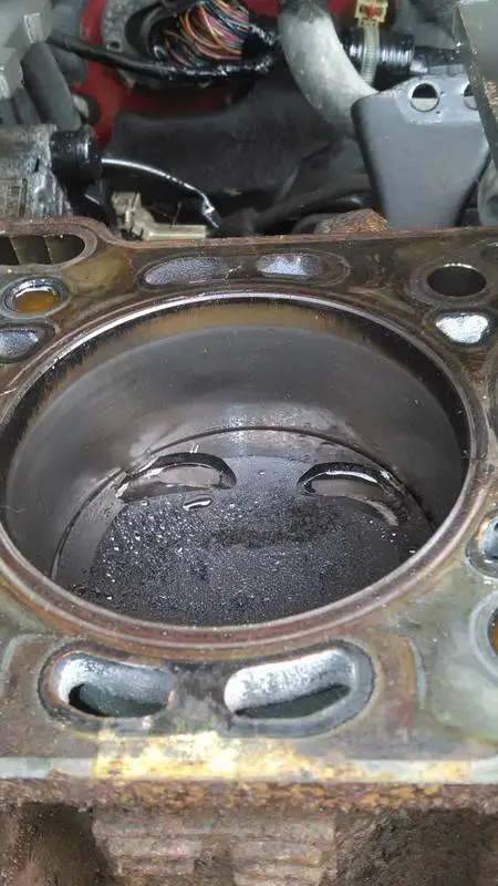

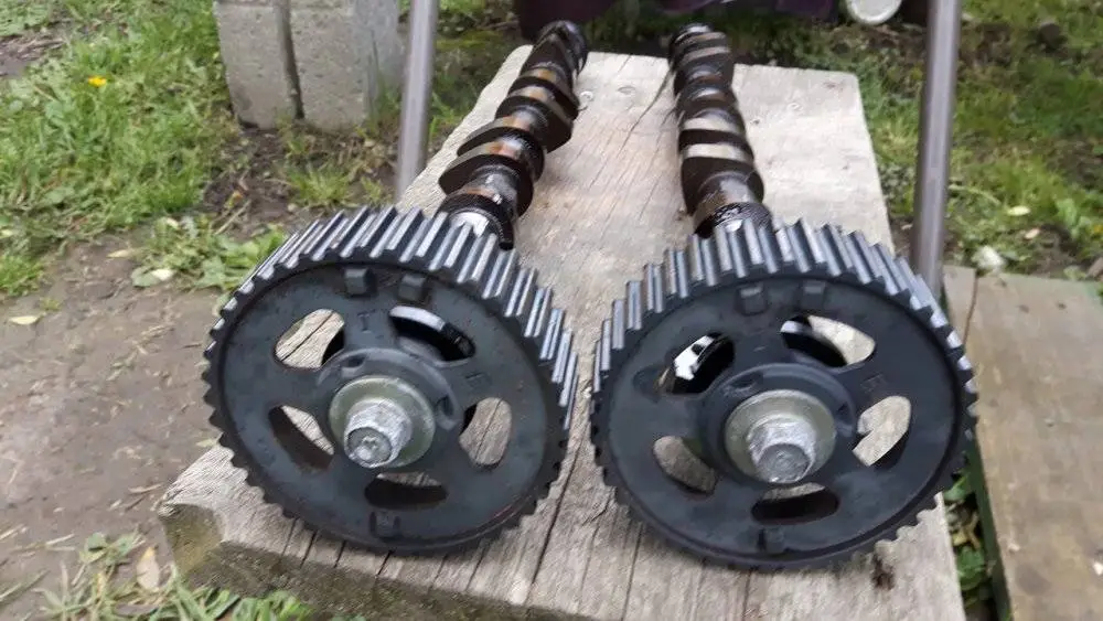

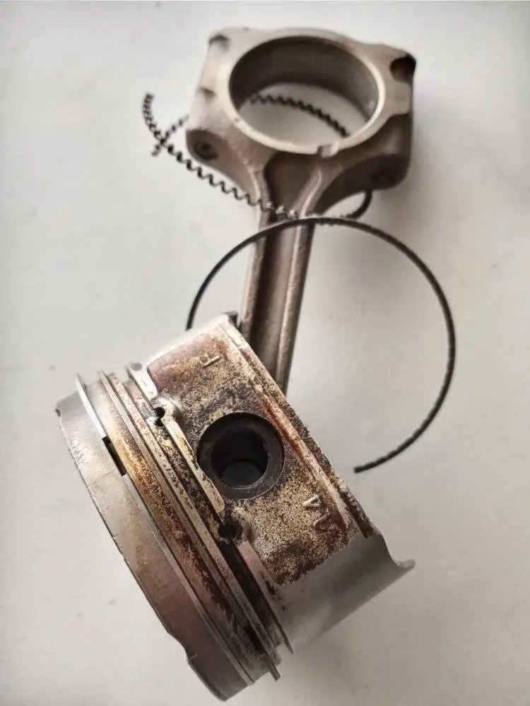

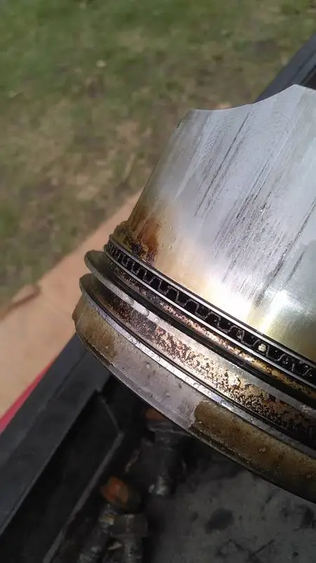

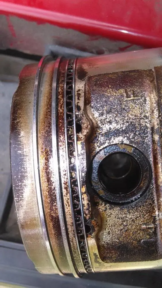

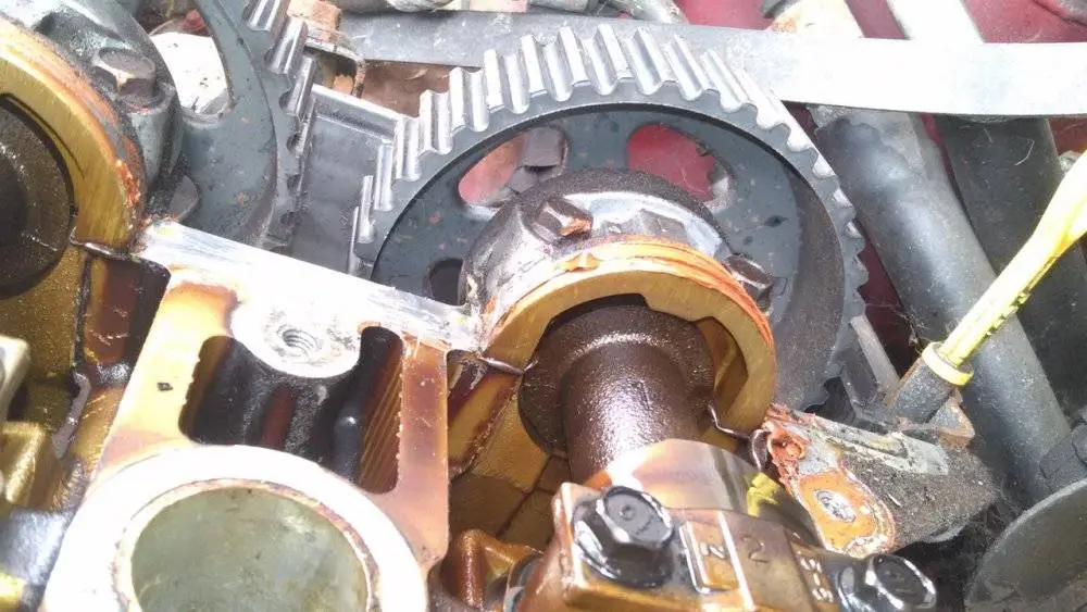

When I bought my car in 2009 I looked into a new timing belt and all the suppliers listed our engine as an interference engine, so I changed my belt right away.
In an effort to see if our engine is an interference engine, I cut the timing belt on my parts car and put a drill on the crankshaft, then I slowly rotated each cam shaft and there was no contact.
The only thing that I could think of that could explain how some engines could bend valves is if the connecting rods were worn from poor maintenance and hard driving ?

CTt3P5 was one of those people who bent a valve when his timing belt snapped.
I did open the engine on my parts car to investigate and remove a piston.
