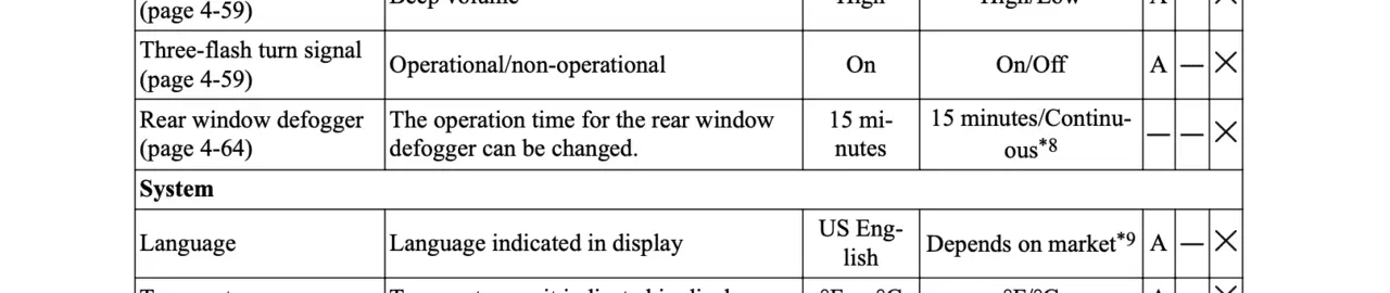

Is it possible to change the factory setting of the rear defrost from "15 minutes" to "Continuous" without going to a Dealer? For reasons unknown this is a personalisation setting that exists, but can only be performed at a dealer. Is there a button press combination that will get me into the secret menu to change this? Excerpts from the Owners Manual showing the option does exist. For the type of driving I do "Continuous" would be far more useful, mostly for the fact it would keep the heated front wiper defroster on continuously in snowy/icy weather. (2017 CX-5 GT Canadian)

If the manual says changing the rear window defogger setup can only be done by the dealer’s Mazda MDS computer, that should be it. You can either know this in advance and ask the Mazda dealer to change the desired setups for free during the car purchase, or you may have to pay the change afterwards.
Until someone developed an software to access Mazda’s MDS system like the VAG-COM VCDS developed by RossTech for VW / Audi which is the Interface to log into car's ECU diagnostics computer and do all the setup changes, not much we can do for these dealer-only setup changes.
