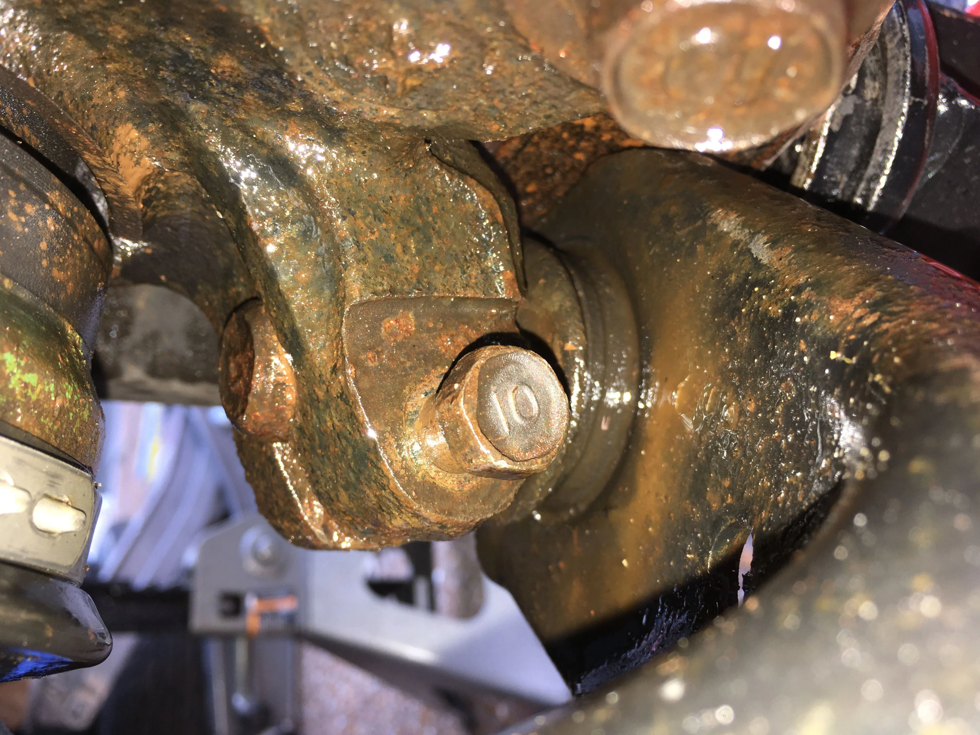

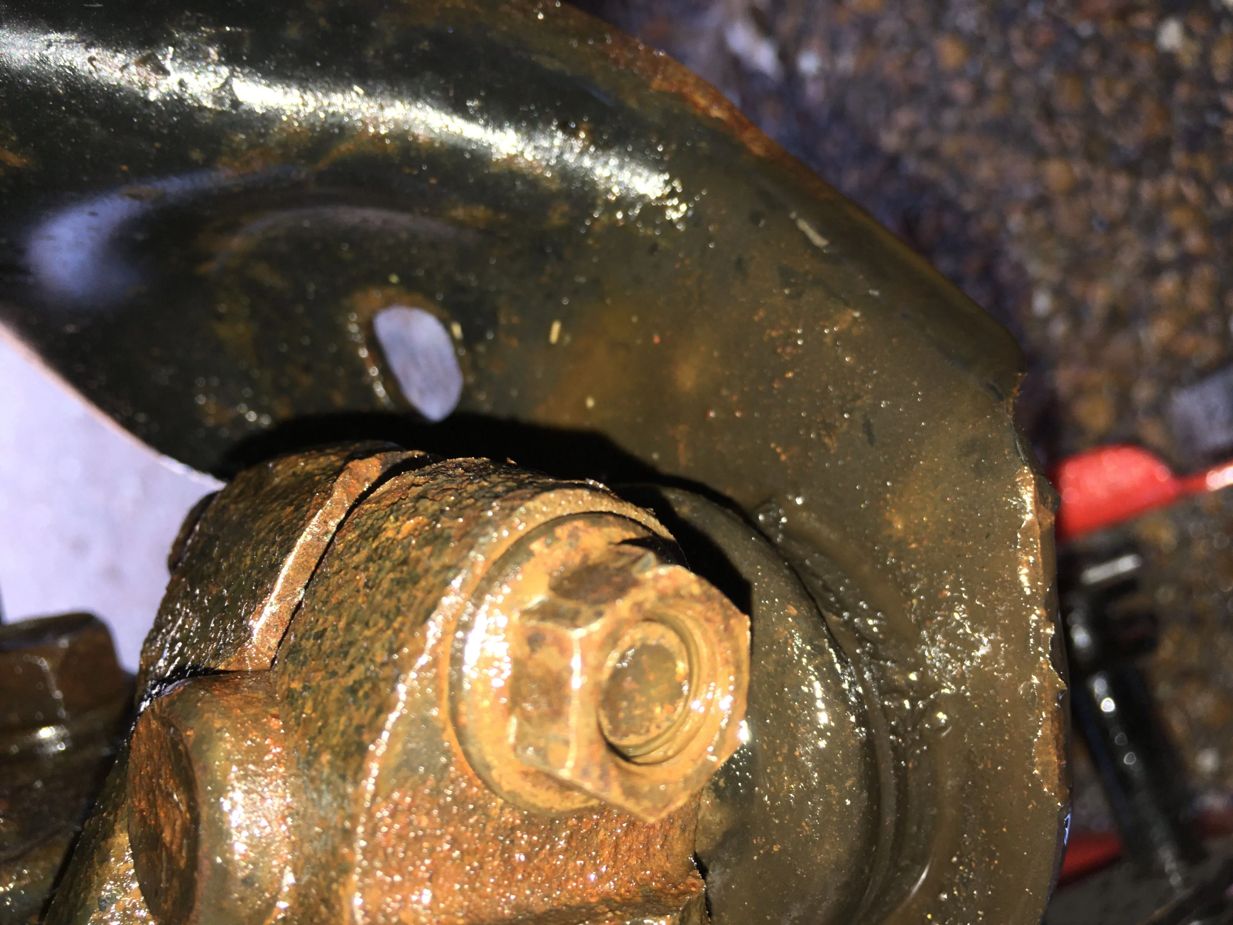

The clamp seems to be open a decent bit but
Ohhh...... well I feel stupid. I didn’t remove it fully because I figured it’d be a pain to get back in

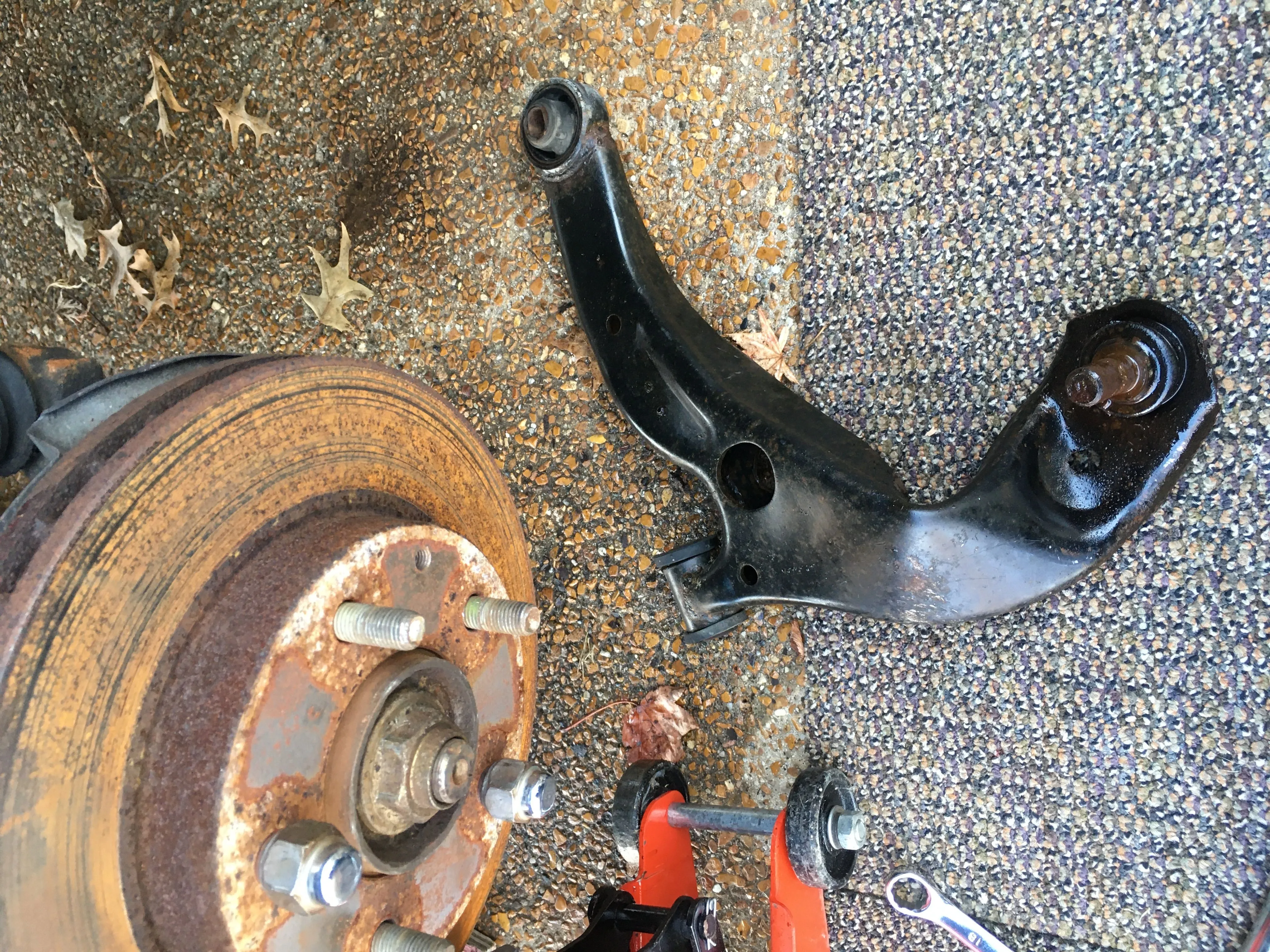

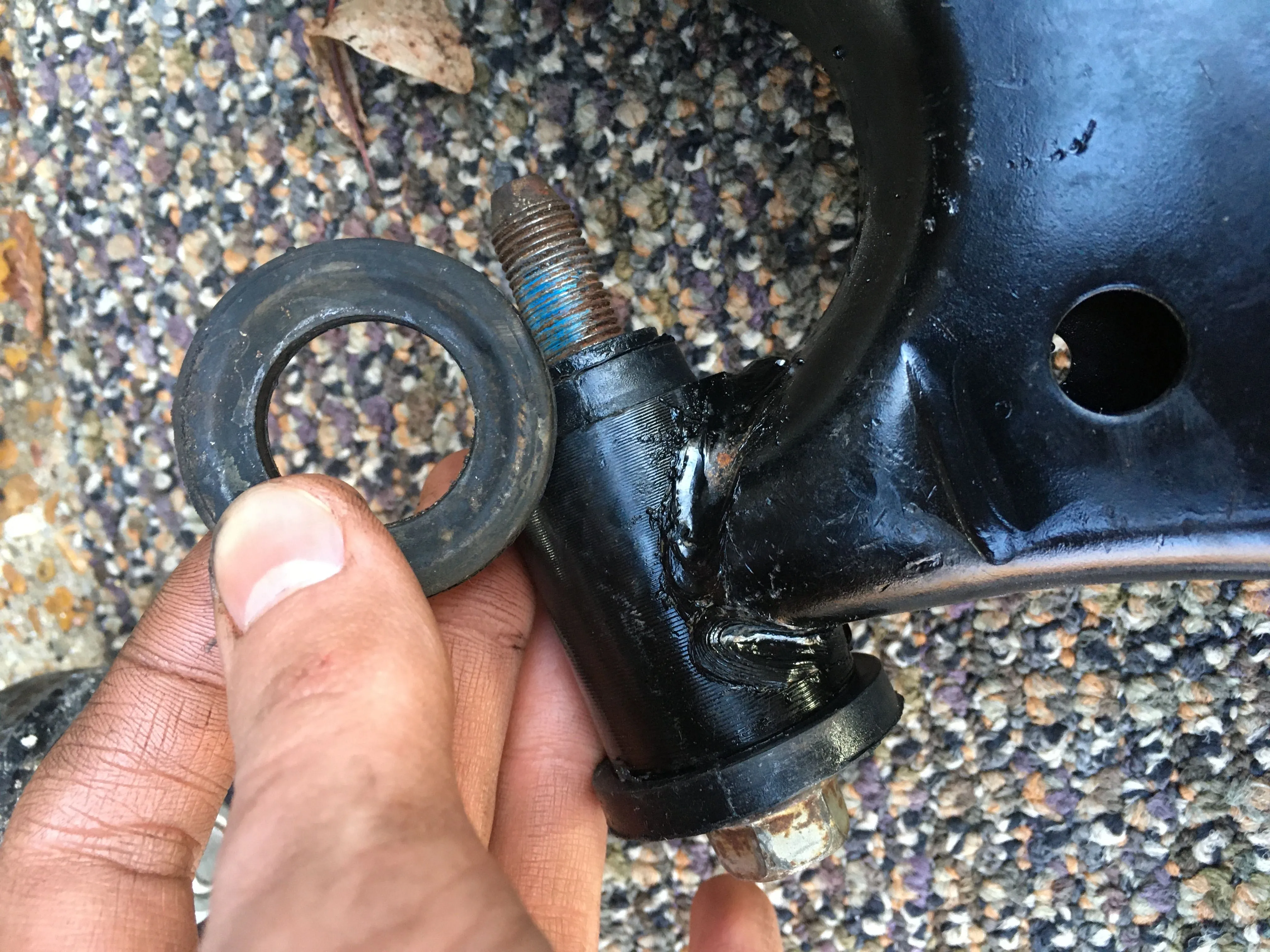

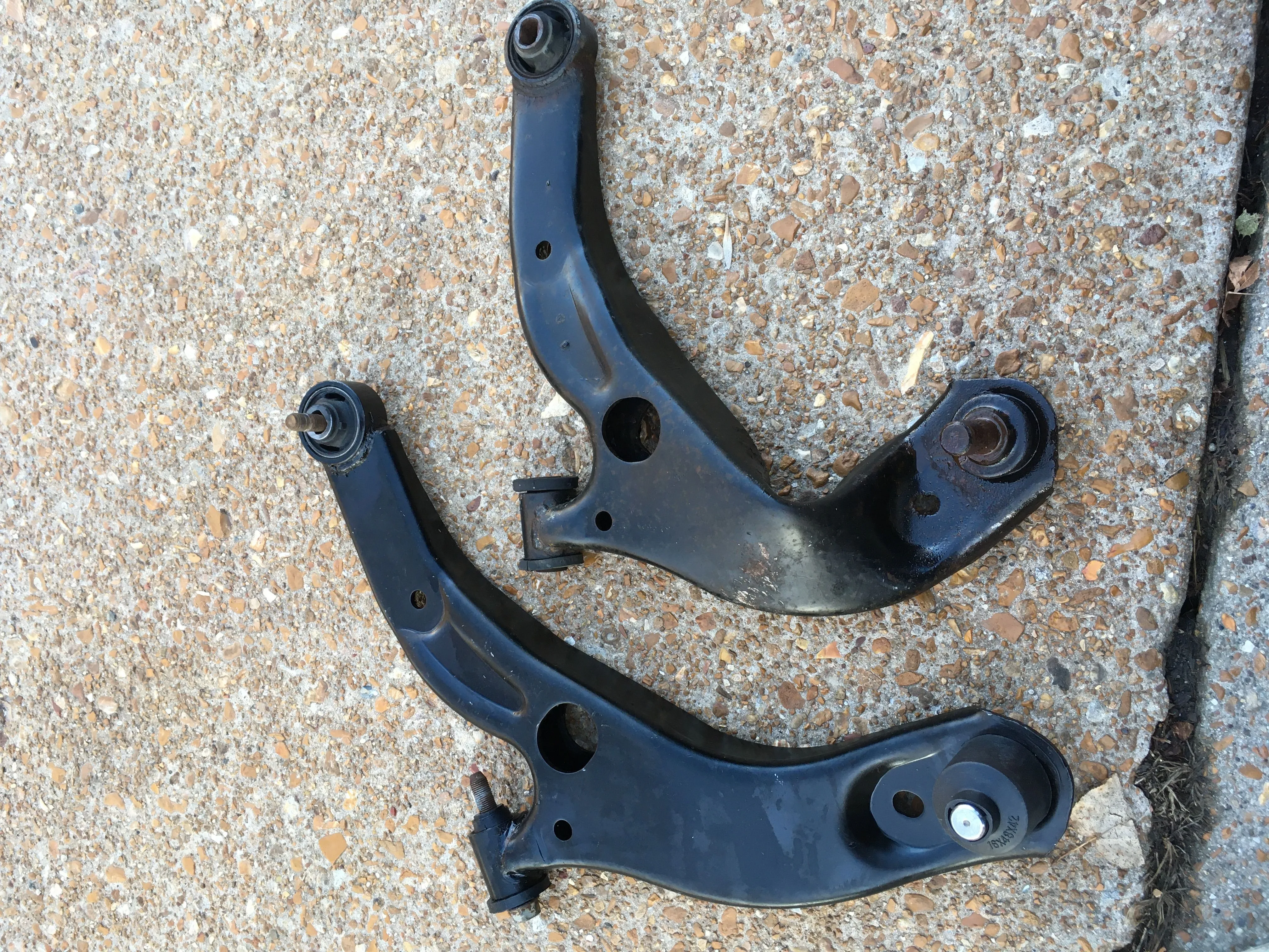

Do you think I should transfer over this rubber bushing/washer? The new one didn’t come with one
I never use it personally.
I use anti-seize because of all my rust issues.
