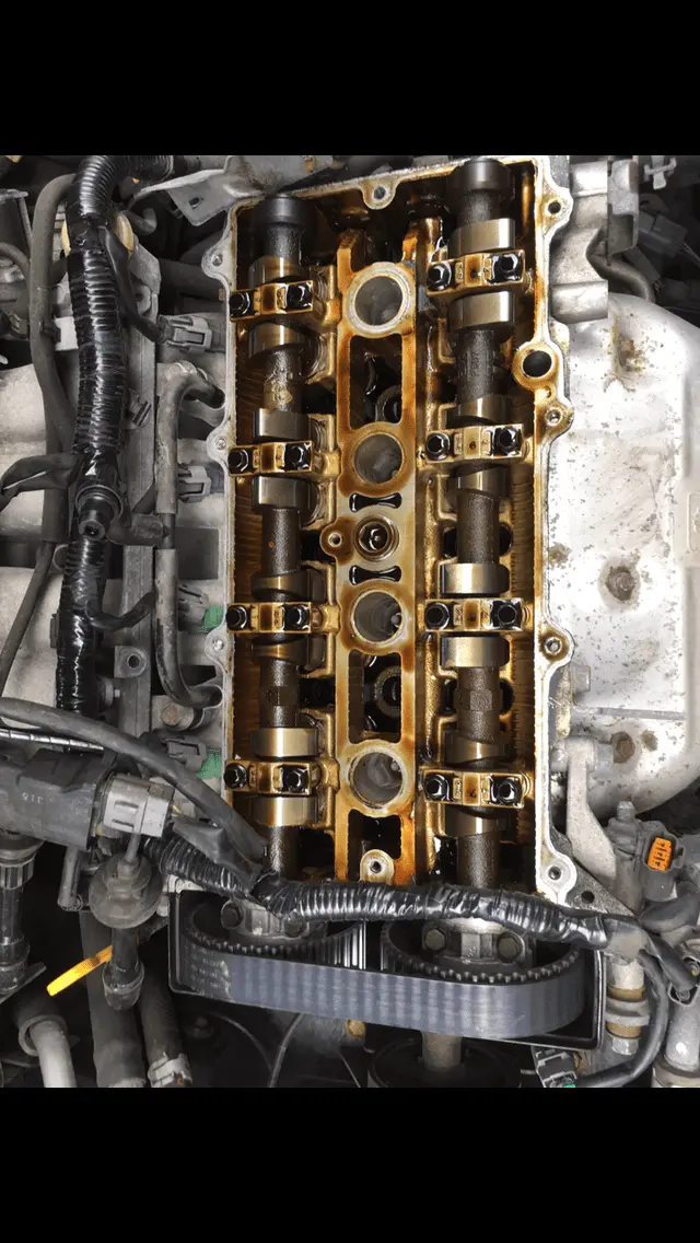

I found the pictures from when I did the valve cover gasket in 9/18. How's everything look?

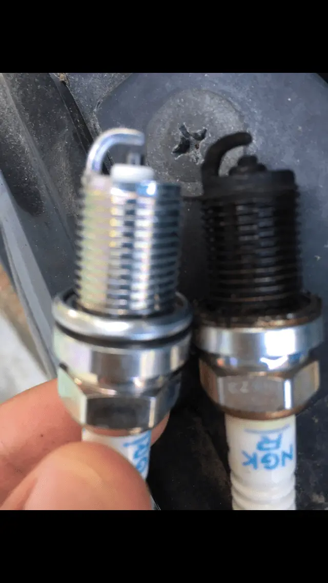

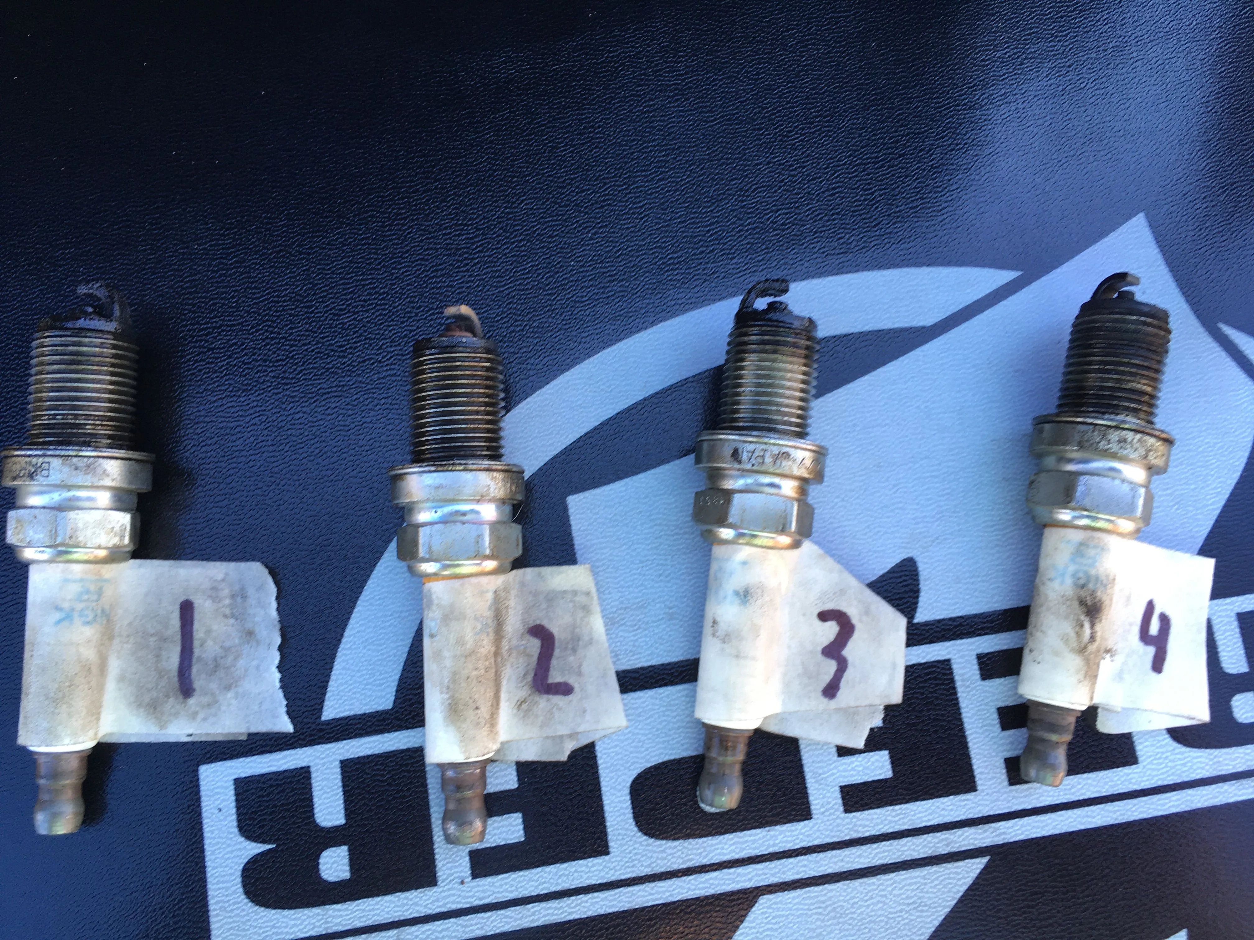

Here’s the old spark plug when I did them as well
Here they are now with only 4,000 miles on them

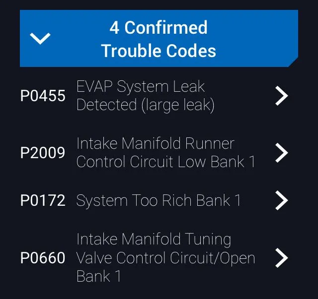

What are your CELs?

The P0455 means your fuel/vapor system has a big ole leak.
The P2009 is not listed as a code for our car.
The equivalent is theP0660 code.
That is the solenoid valve.
They do wear out over time.
I had to replace mine.
(I swapped in the one from my parts car)
The P0172 is the system running rich which could be related to the VICS solenoid malfunctioning.

I think it's this one but I'm not sure...
They're all the same but different...
The same part different names/descriptions...
Compare the picture to your solenoid.
The proper Mazda version is $50-$100.
2003 Mazda Protege5
My scanner said the common fix was the VICS but I didn't want to pay the $50-$100 and was unsure of the quality of the Rockauto specials. I'll look around and order something. I'll look for any visible gas leaks while it is up on jack stands.
