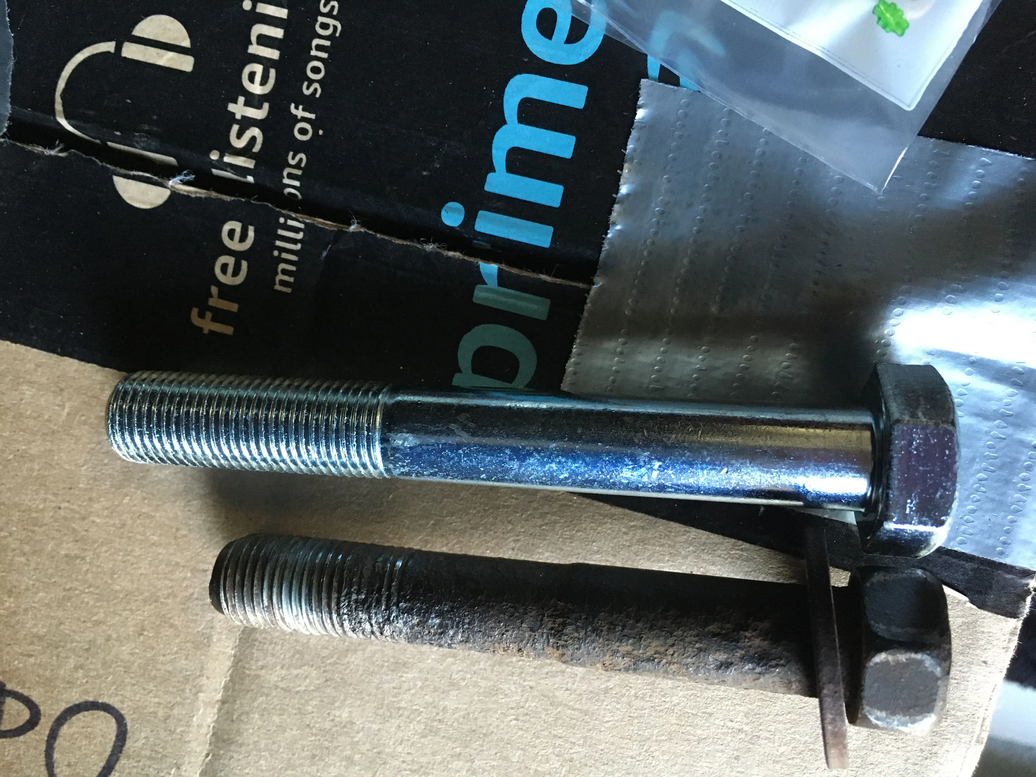

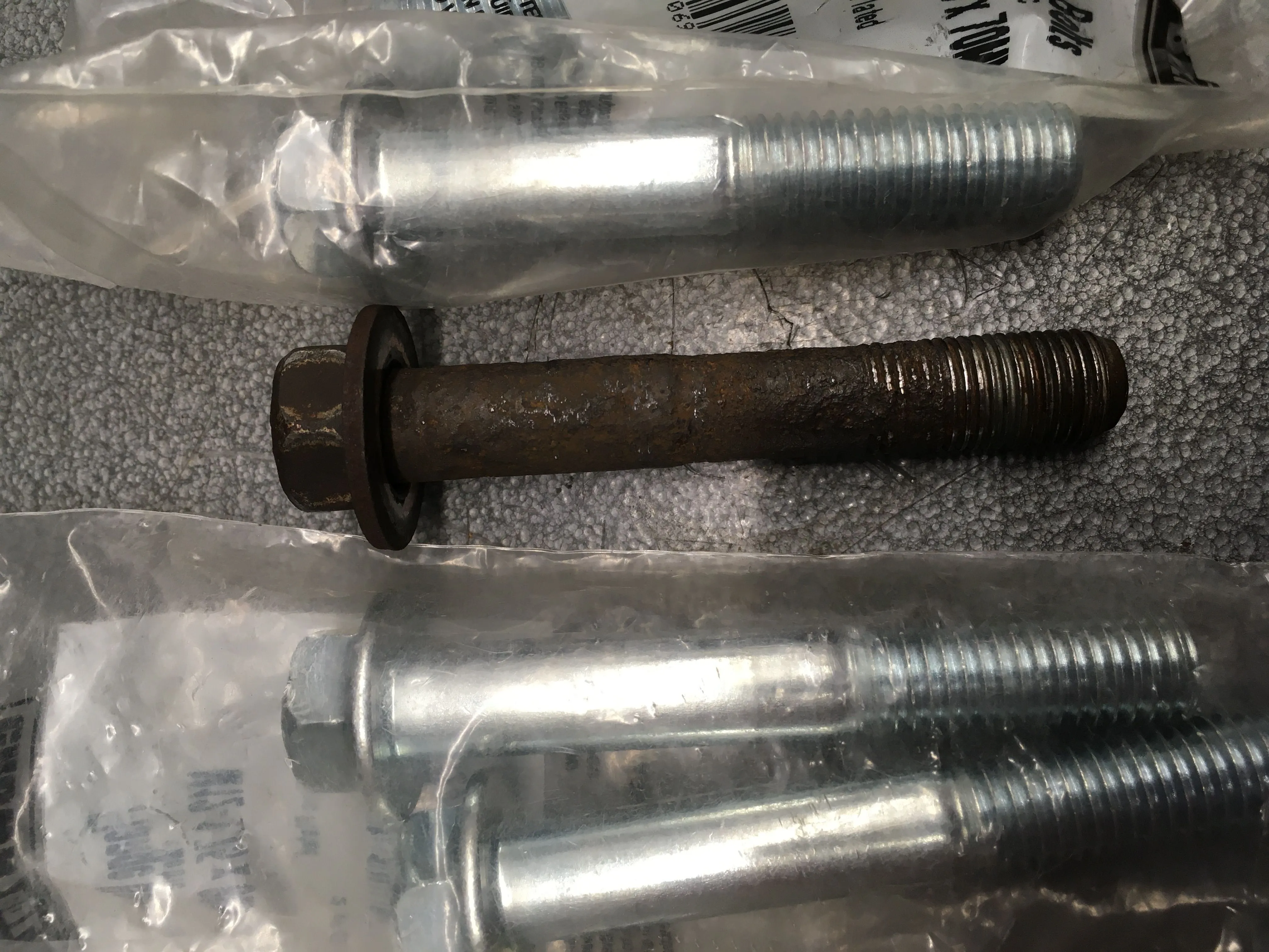

I’m think I’m gonna have to go get replacement bolt for part #8. Any ideas on the size? So I don’t have to aimlessly wander the hardware store.
Idk if not enough threads or too much is better...
here’s what I got from Home Depot, for others who may need a replacement. It’s a little shorter than the stock bolt but hopefully it’ll do the job.

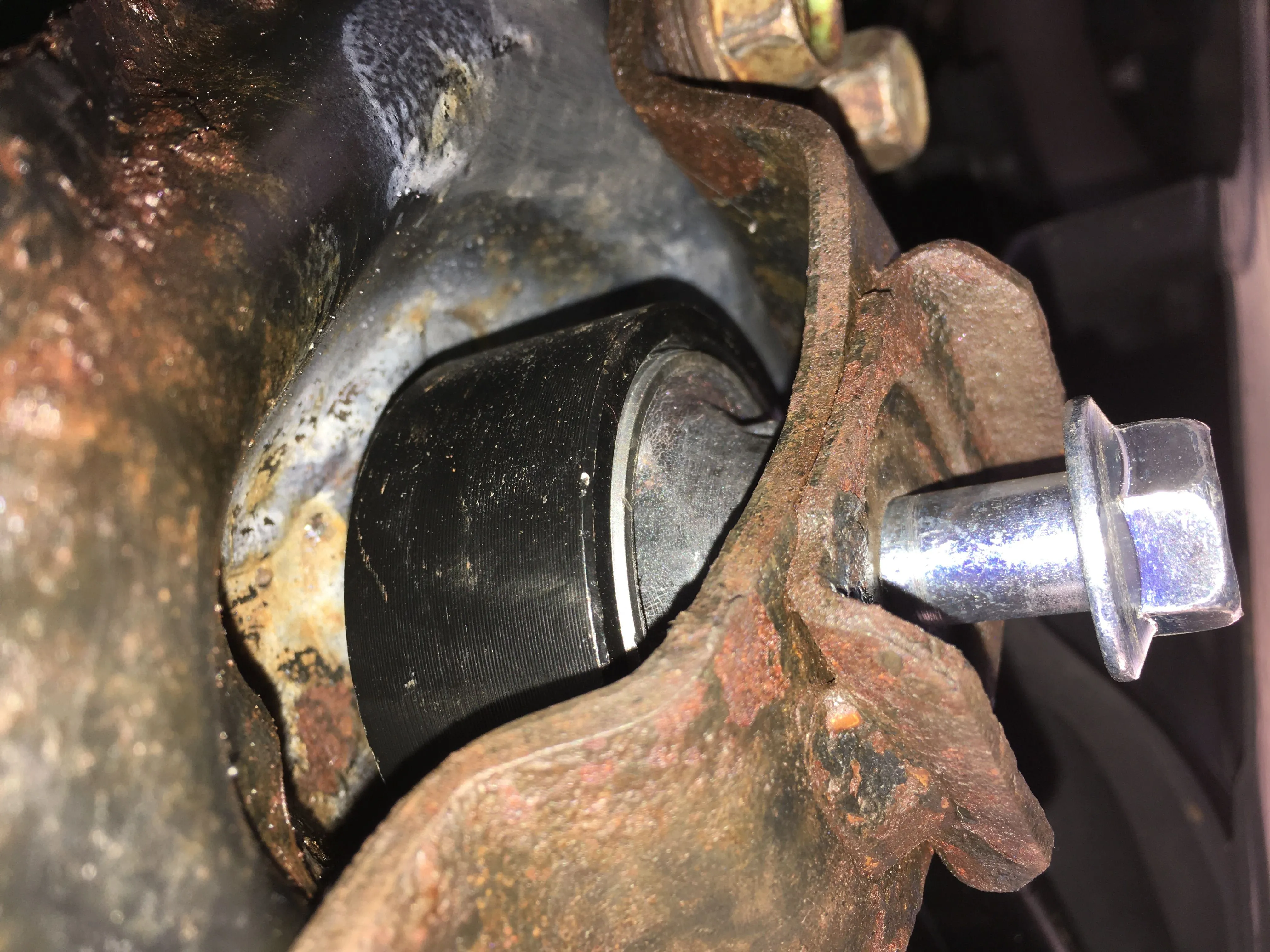

I got the bolt into the control arm and bracket but can’t get it to thread into the hole past the control arm
How much did you have to lift on the control arm? I’m lifting a good bit and I don’t want to bend it
I had to back off the bracket bolts quite a bit to give the bracket some room to move.
The control arm needs to be a level as possible like when the weight of the car is on it.

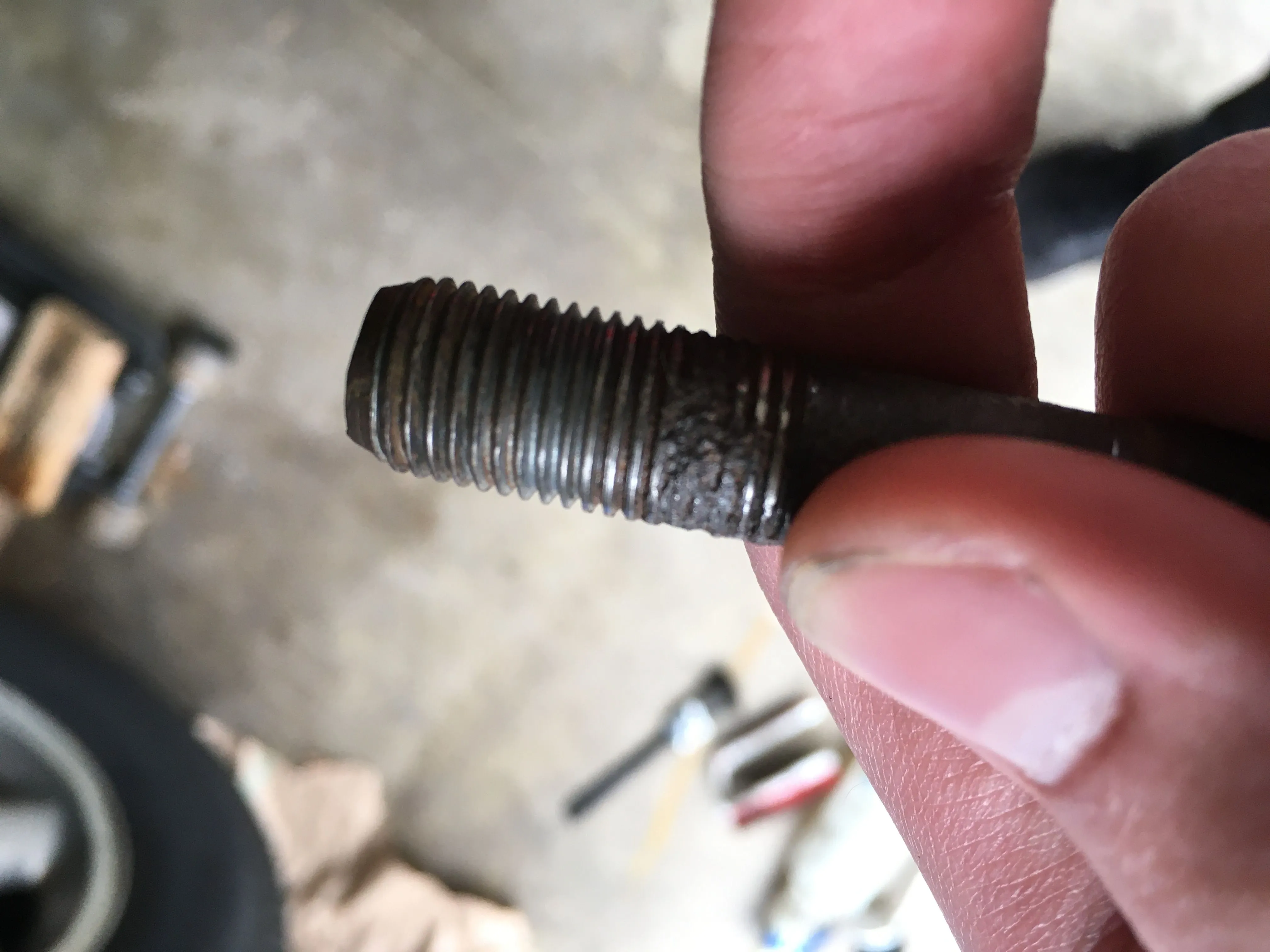

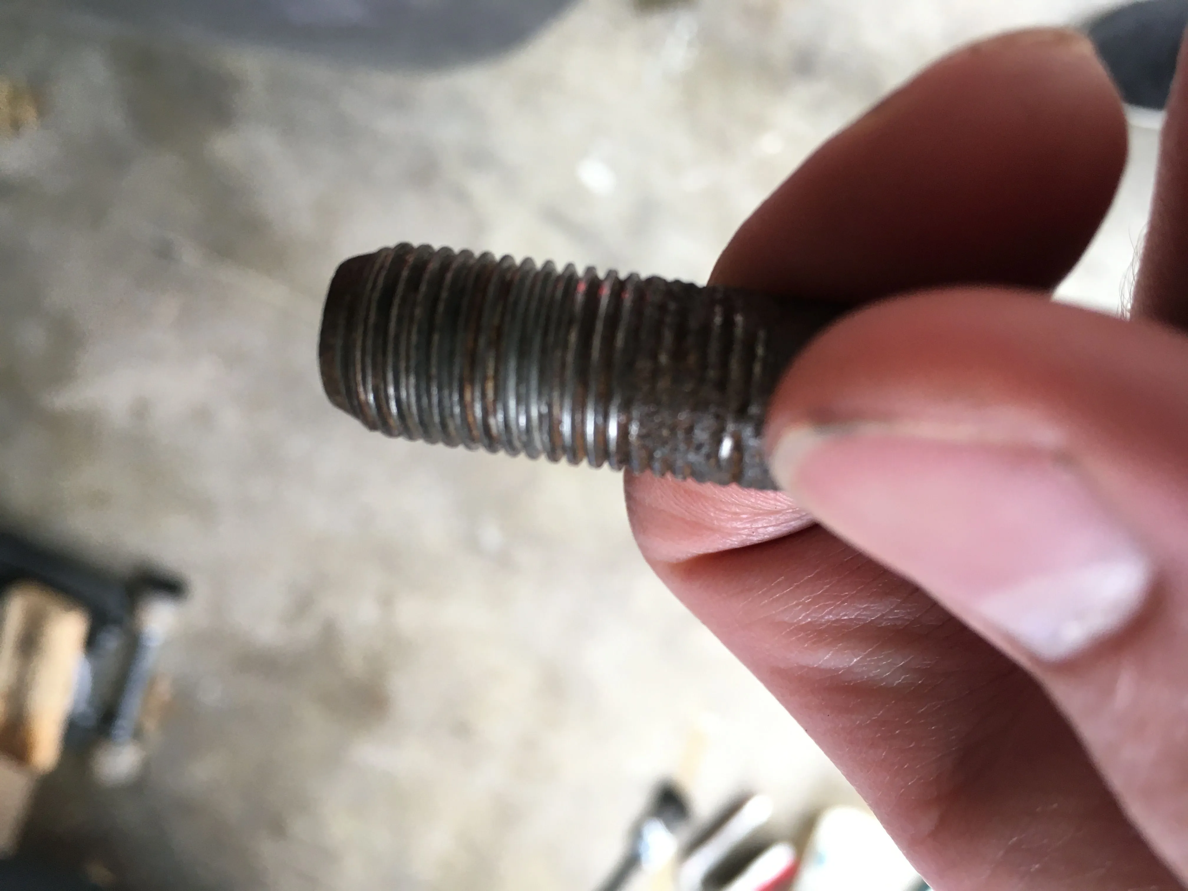

Are you sure that's the right thread??
Are they metric threads??
They don't appear the same in the picture??
Do this with the two bolts to make sure they mesh...
I just read your package and it appears to be metric threading...
It could be just the picture??
You're better off with a slightly longer bolt than shorter as long as the longer bolt doesn't bottom out or hit something.
Yeah you’re right... I guess I’m waiting until I can cut the first bolt I bought tomorrow.
and here I thought I was almost done :(
I got the shorter one because it was only slightly shorter and I didn’t want the longer one to bottom out. But it doesn’t matter I’ll cut the really long one tomorrow
