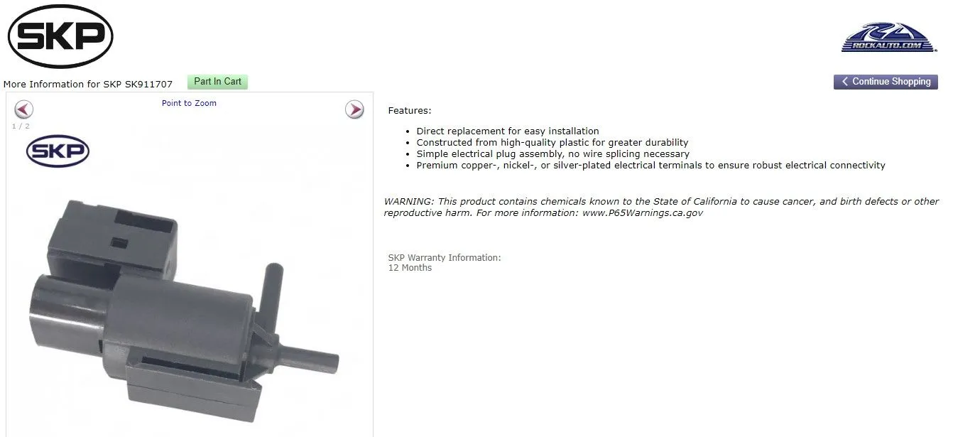

Is the VICS located in the engine bay? I want to check and make sure this is the right part before I order it and I'm not sure where to check. A video said under the rear of the car...
The one under the rear of the car is the canister drain cut valve CDCV
The VICS solenoid valve is located in the engine bay.
Compare the picture to what you have.
The PRC solenoid valve is right beside the VICS and VTCS solenoid valves.
The VICS and VTCS valves are the same but the PRC valve is slightly different in how it attaches to the bracket and the wire connector is slightly different.
A lot of suppliers of these valves have different names for them so it's best to compare the pictures.
You're best off removing the solenoid from your car to compare it to the picture they posted.
All the solenoid valves are almost identical.

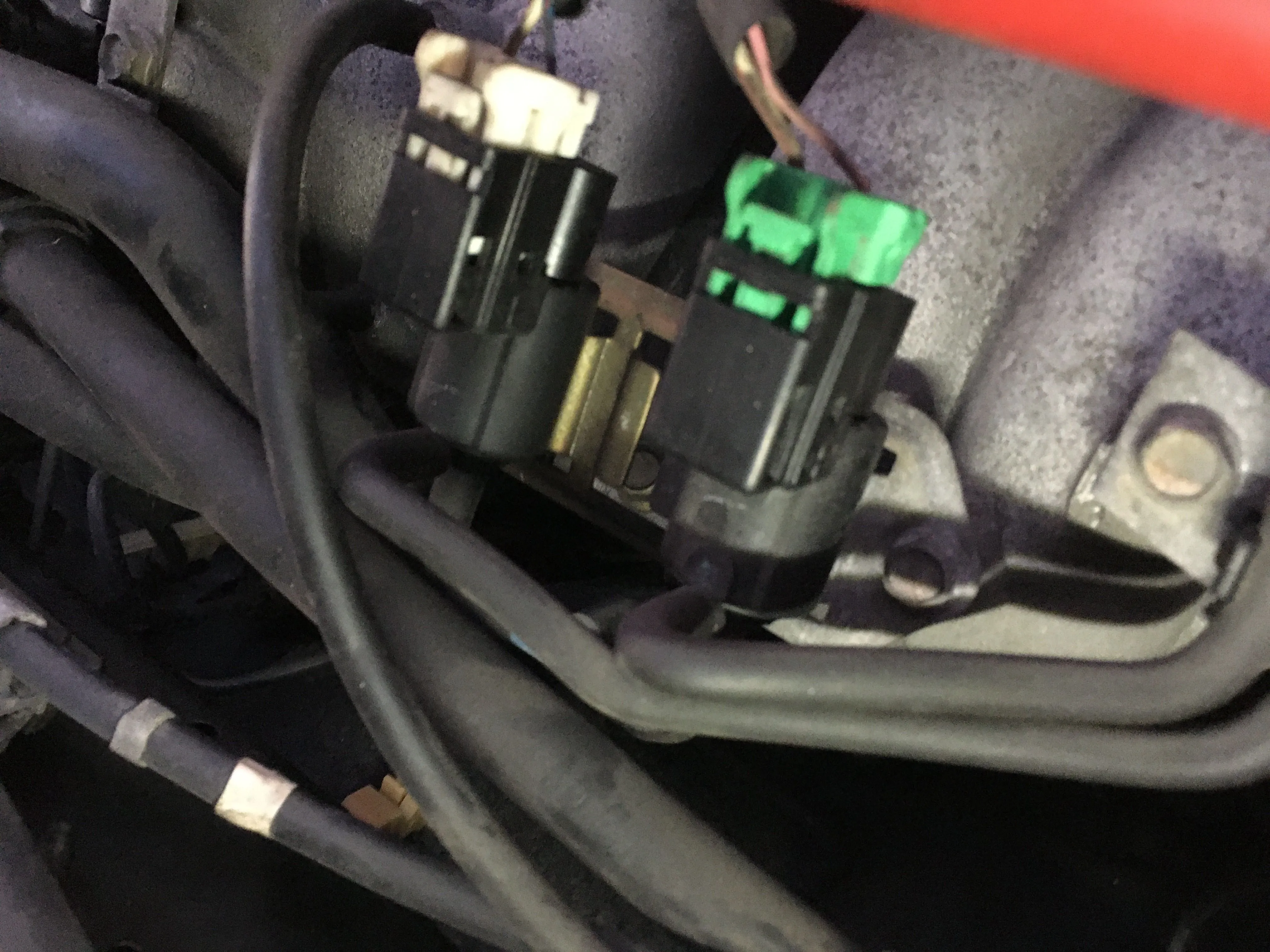

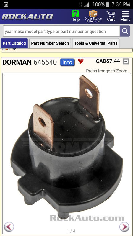

I see three solenoid valves that all resemble the rockauto part. I know you said to remove it but what differences am I looking for?

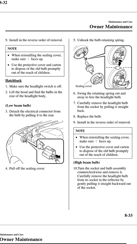

also how does the low beam headlight bulb come out? I want to order new brighter bulbs but some are just a bulb while others have a bulb with a connector/socket. I’m not sure which ones I need.
Yeah, those three all look the same to me...

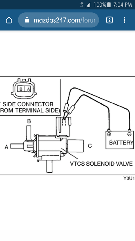

The diagram for the VICS shows the connector standing straight up, but on your car, the connector is horizontal???
I think the Rockauto one is the correct one.
Plus, it's almost always the VICS valve that people have to replace, so that is probably the correct one.

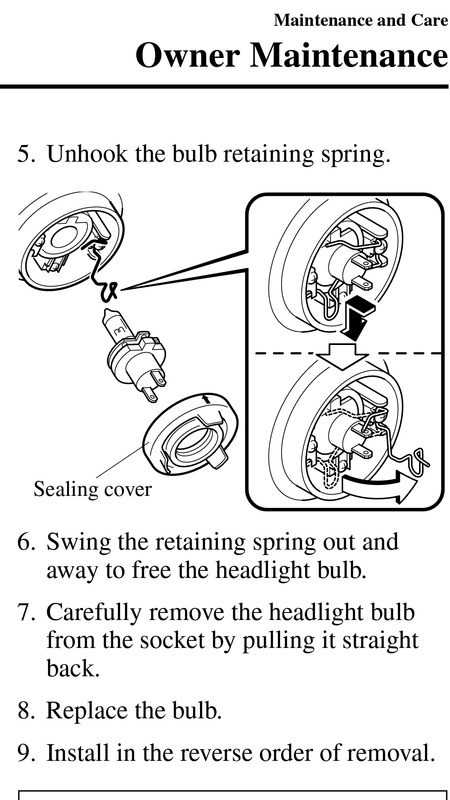

The low beam bulbs are a huge PITA.
The spring-clip is tricky and hard to reach and the low beam bulbs are always burning out for a lot of people.
(although I've had great luck with mine??)
You might want to stick with the regular wattage to hopefully get a more reliable bulb.
Use some dielectric grease on the terminals and you'll get more bulb life.
You might need new adaptors for the bulbs.
They get all burnt and crispy.
Be careful not to throw them out with your old bulbs...

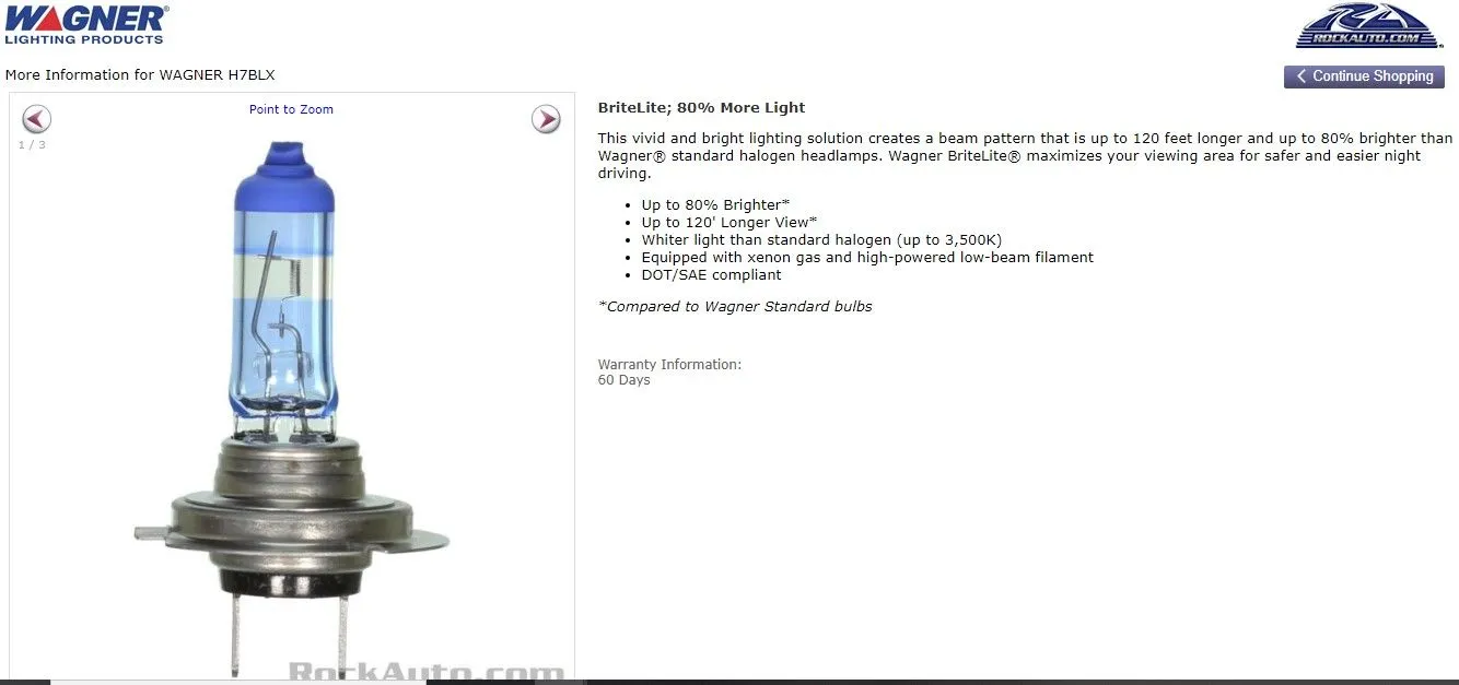

Thanks, I could feel the prongs just wasn't sure how to remove it. So I need the bulbs without the connector and then adapters? Now that I looked again I guess all the ones with connectors are high beam. These are the ones I wanted to get
Oh I forgot to ask what the factory wattage is? I see 65 and 55 although the ones I want don't specify.
Sixty and fifty-five...
The bulbs you want might be more efficient but if you blow them every month, it gets expensive...
Yeah... I just remember barely seeing at night and would like to remedy that but maybe I'll just go with regular replacements.
