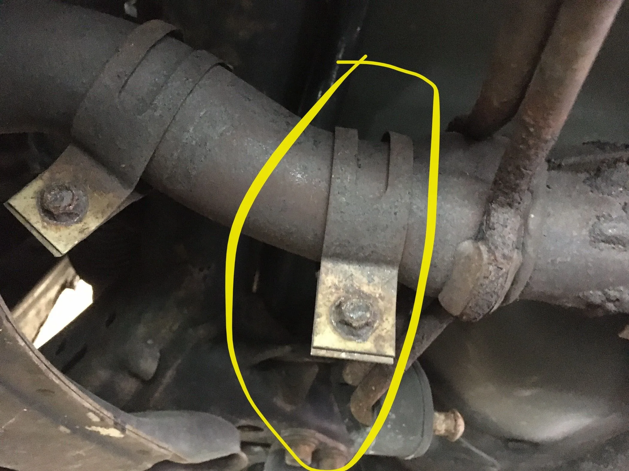

It doesn't matter what it's for.
Remove it, it ain't working no more.
(look to see what it attaches to though)

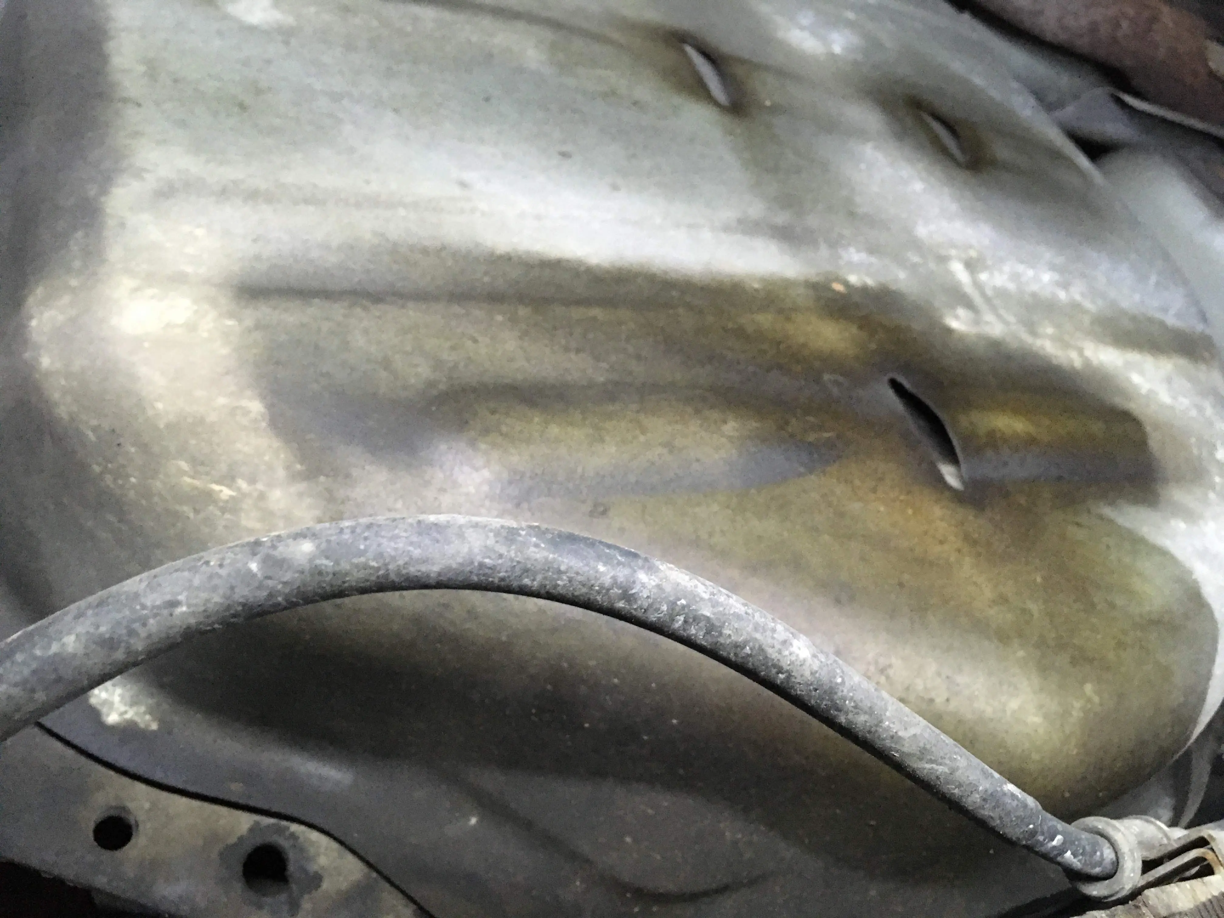

Get a new bolt for your exhaust.
Maybe remove one to compare it at the store.
(a new gasket too... at some point.)
I’ve got a new gasket, upper and lower.

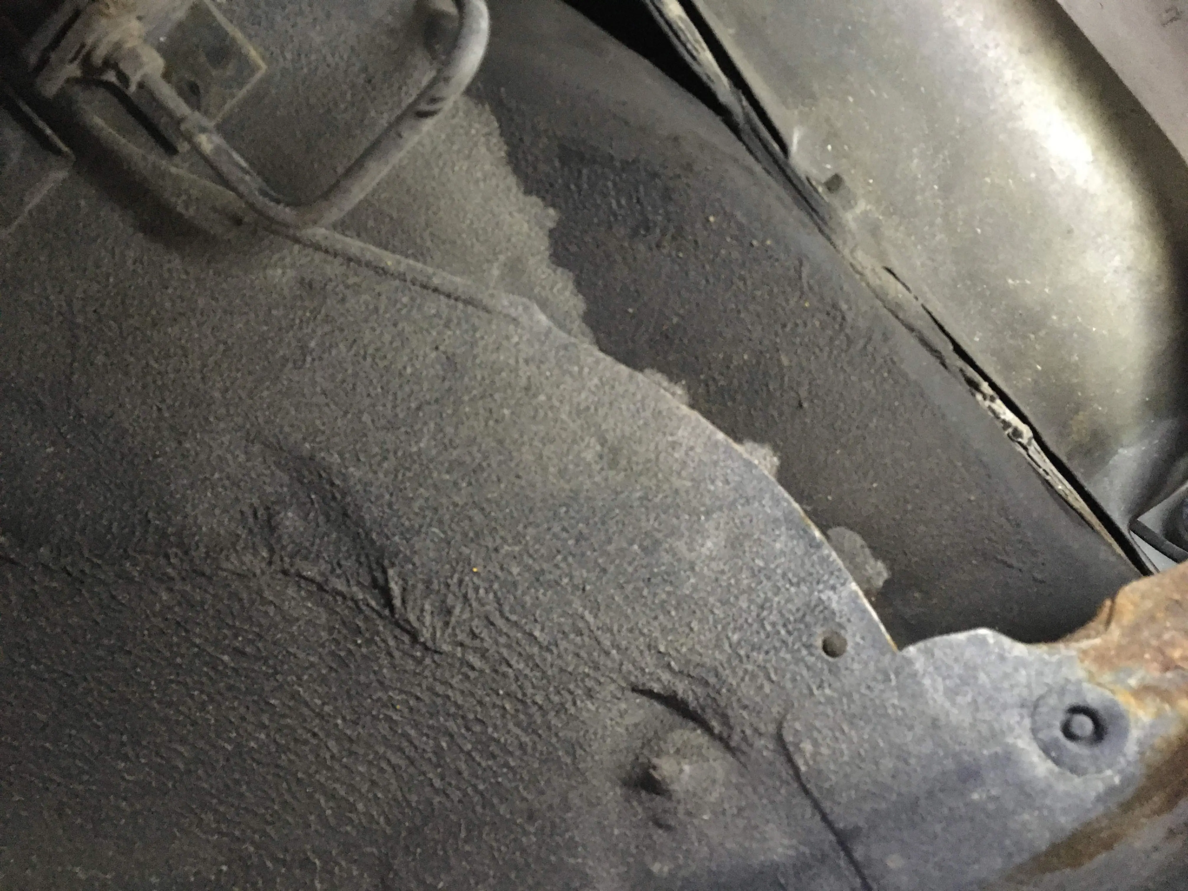

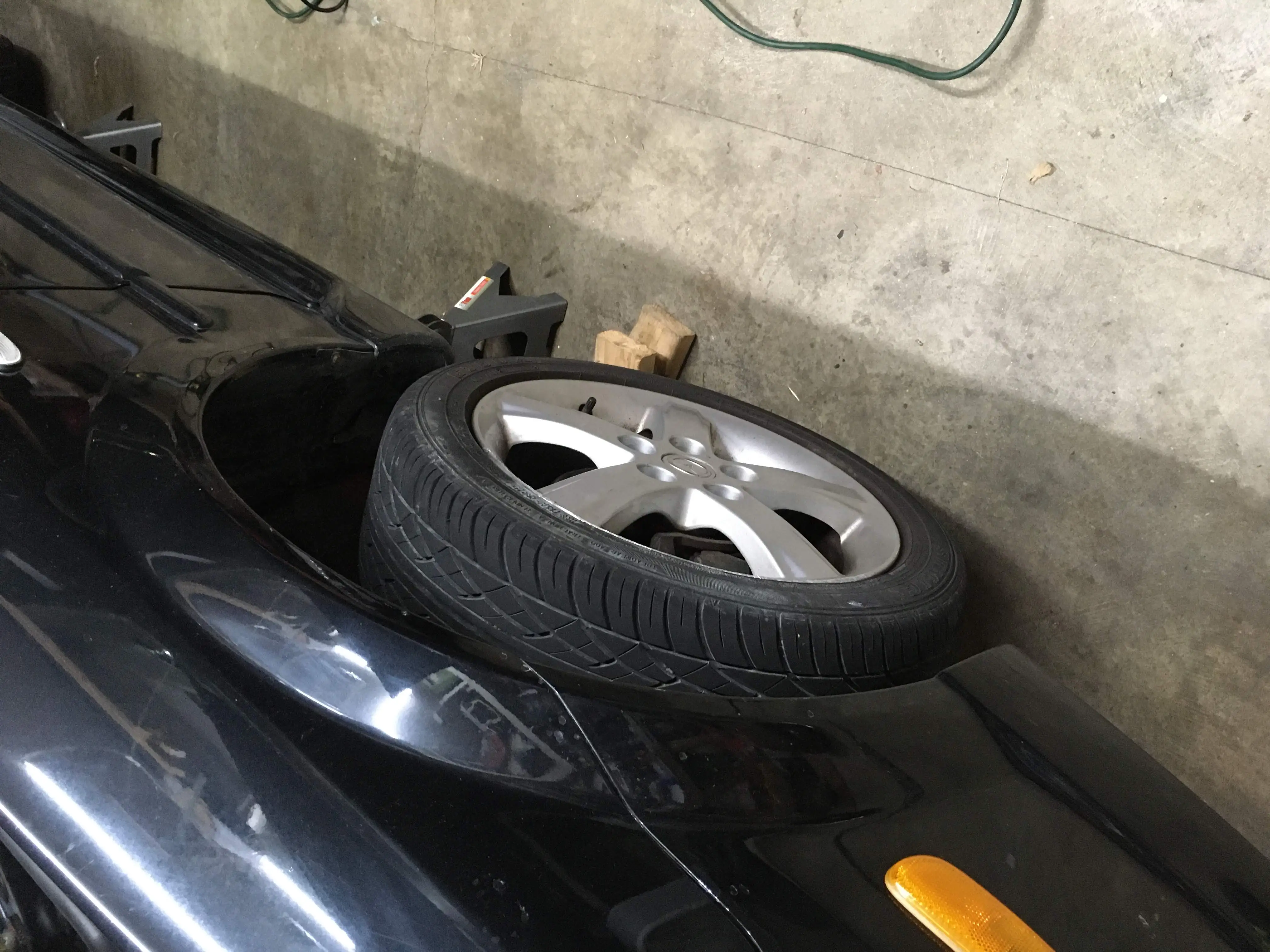

Here you can see the angle the drivers wheel is at compared to the passenger side that is straight.
I'm assuming this wetness is gas but I can't see where it's coming from. Also, the CEL has yet to return.

if that were my car I'd crawl underneath it and see if I smell gas oil or water.
If you're leaking gas then you've bigger problems than a paint job and headlights.
I'm not paying anything, I've got product that's been sitting on a shelf for years and I'm bored.
The wetness doesn't smell like gas but it hasn't evaporated.
