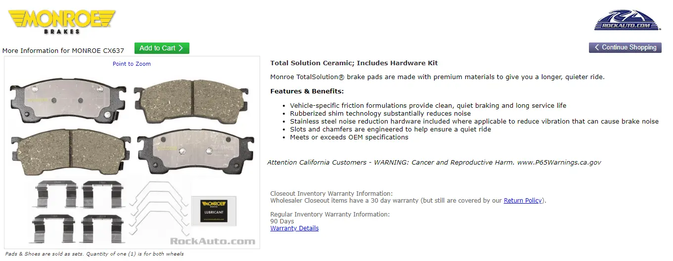

So it looks like you're going to be buying new pads and maybe rotors too.

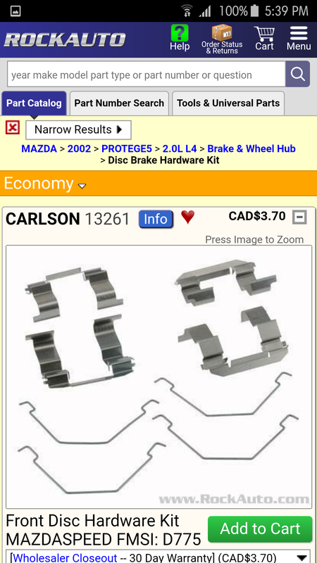

Get the hardware kit along with them.
It's pretty cheap.
Yeah I’ll see what rockauto has to offer when I get inside. Gonna need rotors too, they’re scored badly and have heat spots. Just the front. I’ll leave the back alone, pads look new.

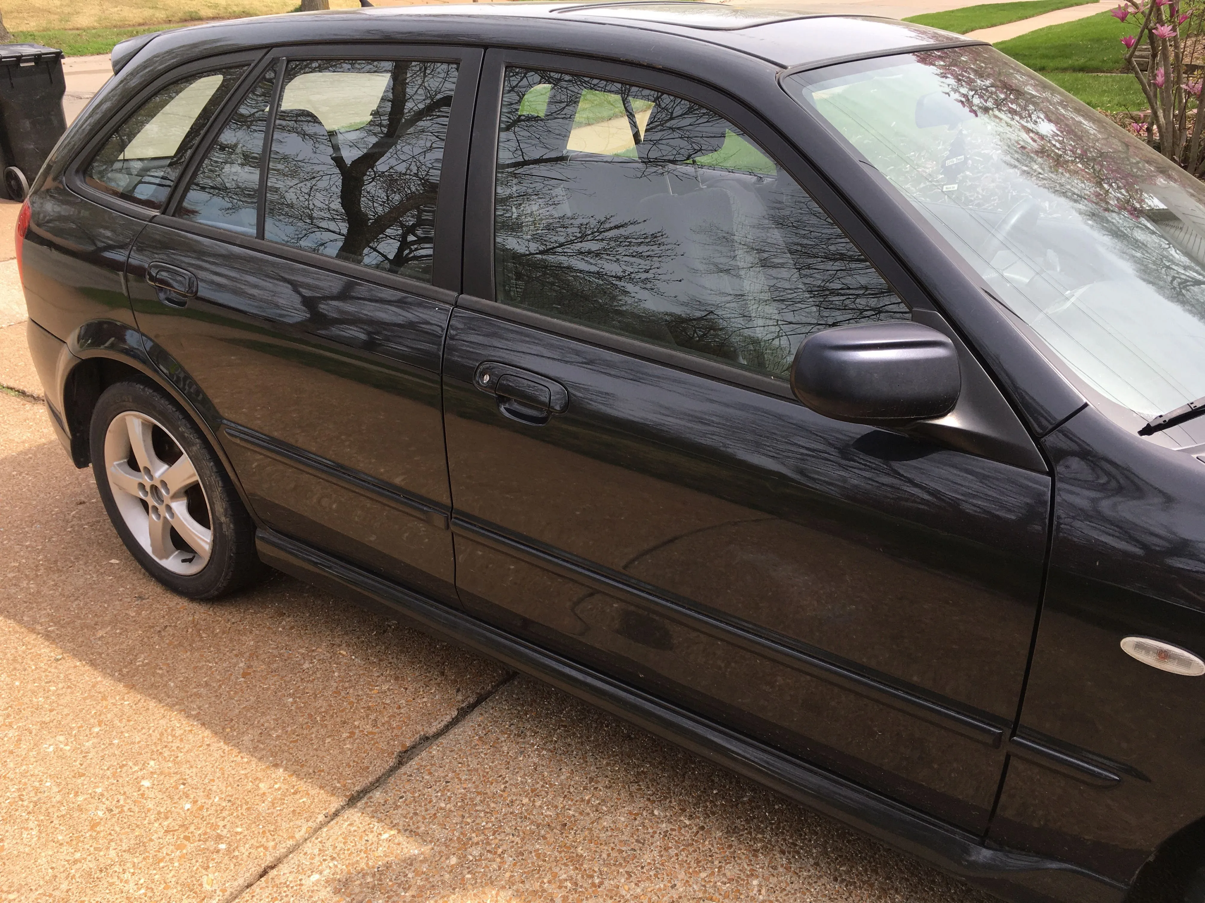

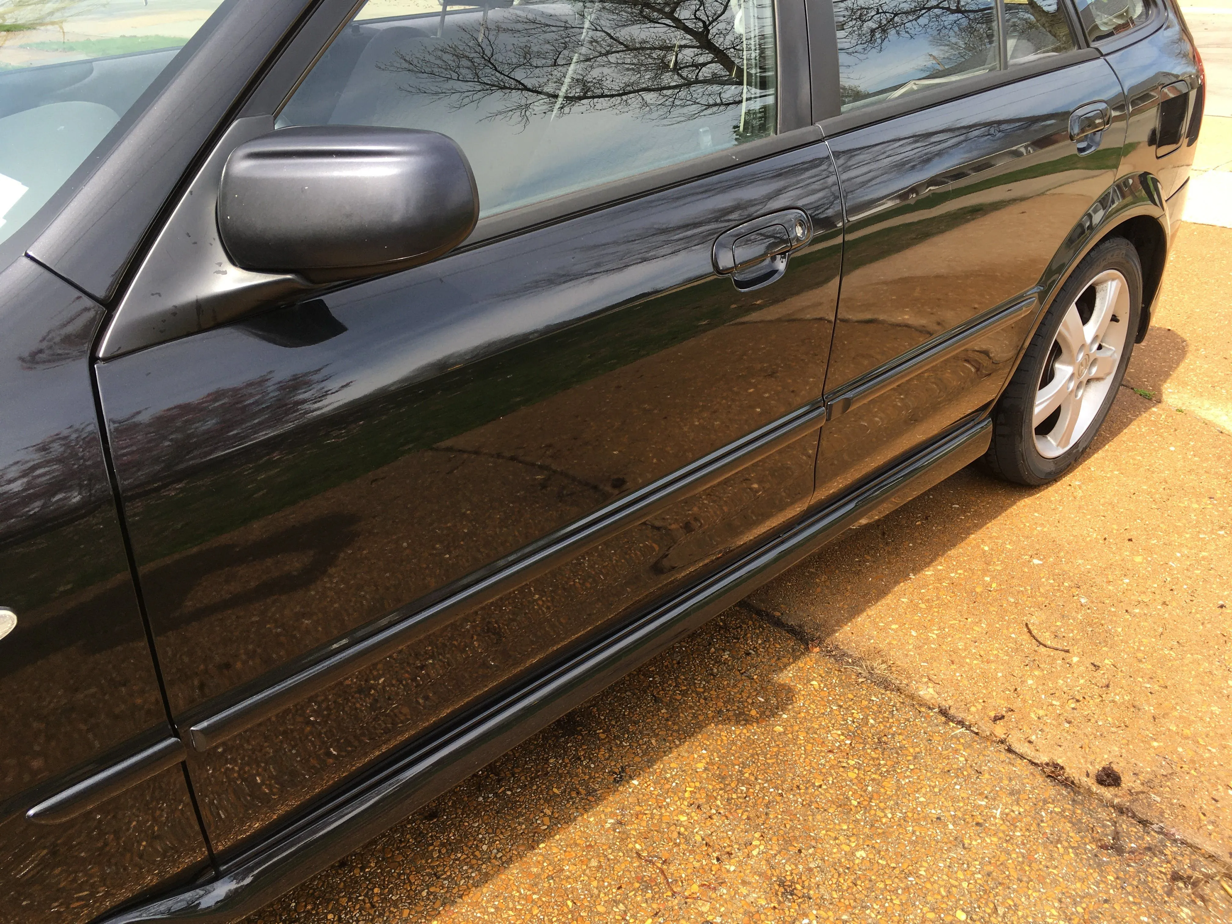

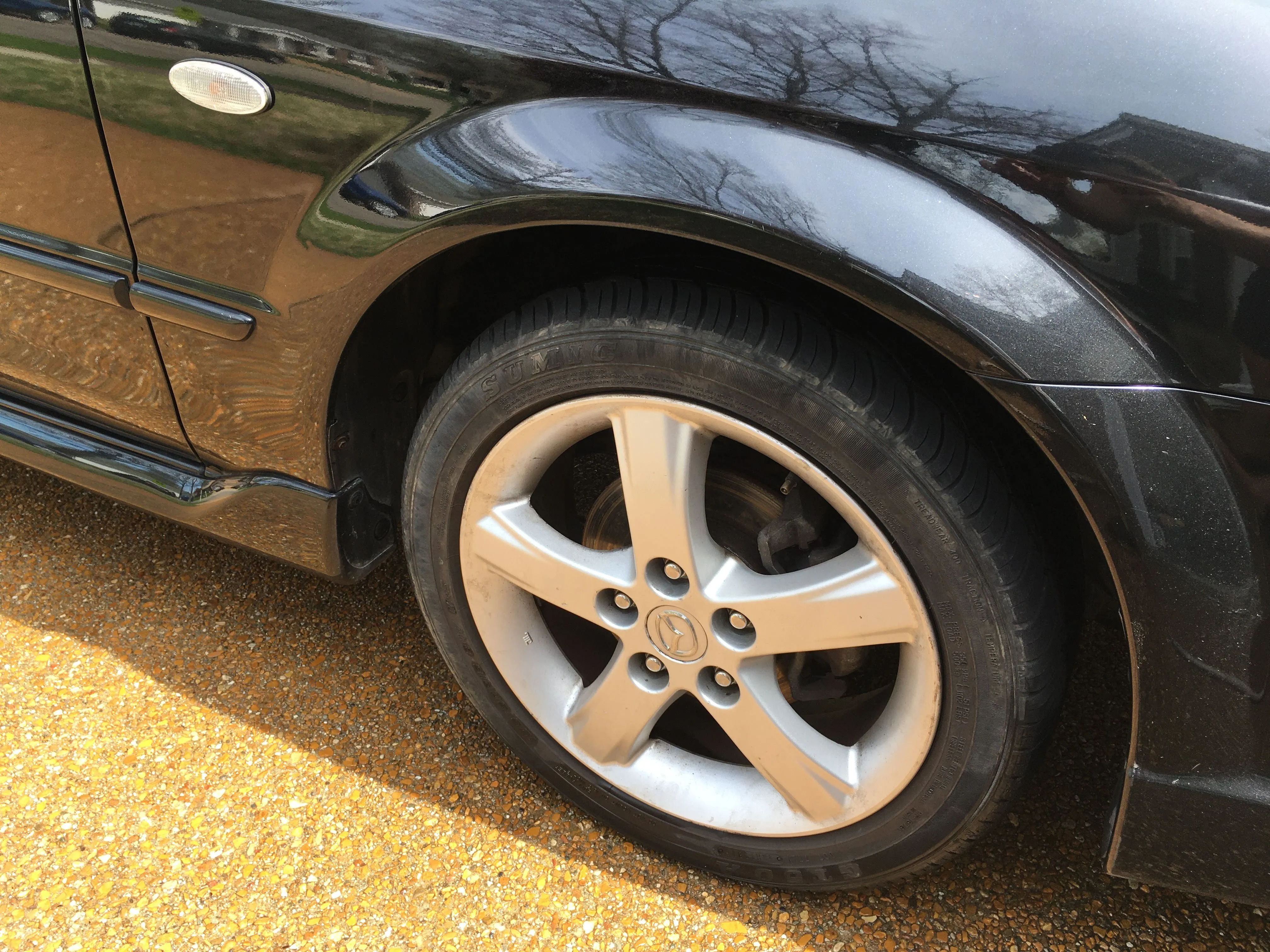

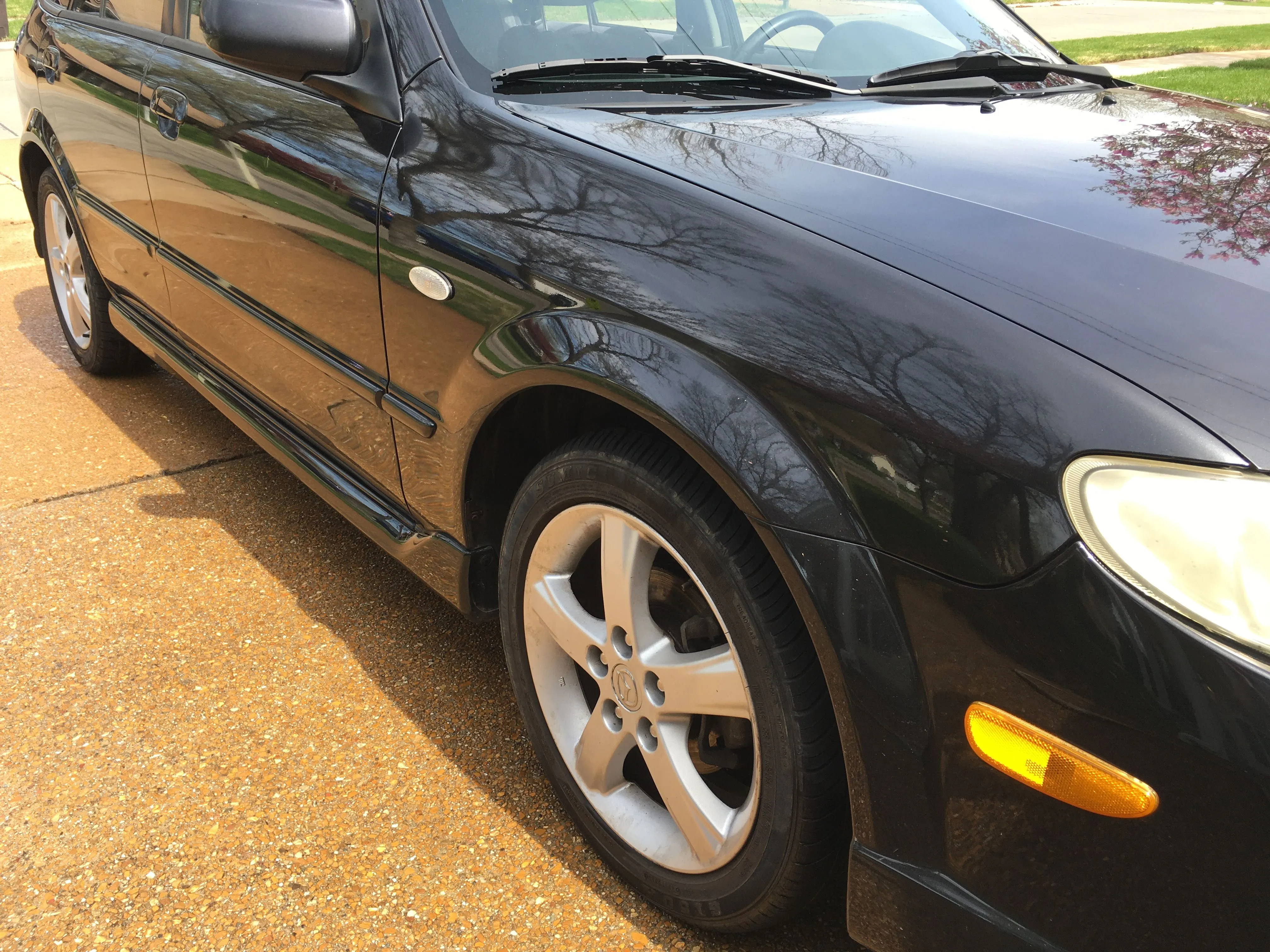

Also, I washed it today. I only polished the hood and then decided it was too hot. I'll post some pictures.
Yeah, that's a good deal.
I bought my hardware and pads separately.

Rotors are the pricey part. I'll probably go with "economy"
If only the rotors and pads were the same as a 2014 civic lol, I've got a full brake kit for one.
I'm not sure but RockAuto is pretty good at sending the right parts.
If you found it listed for a Protege5 then it will most likely fit.

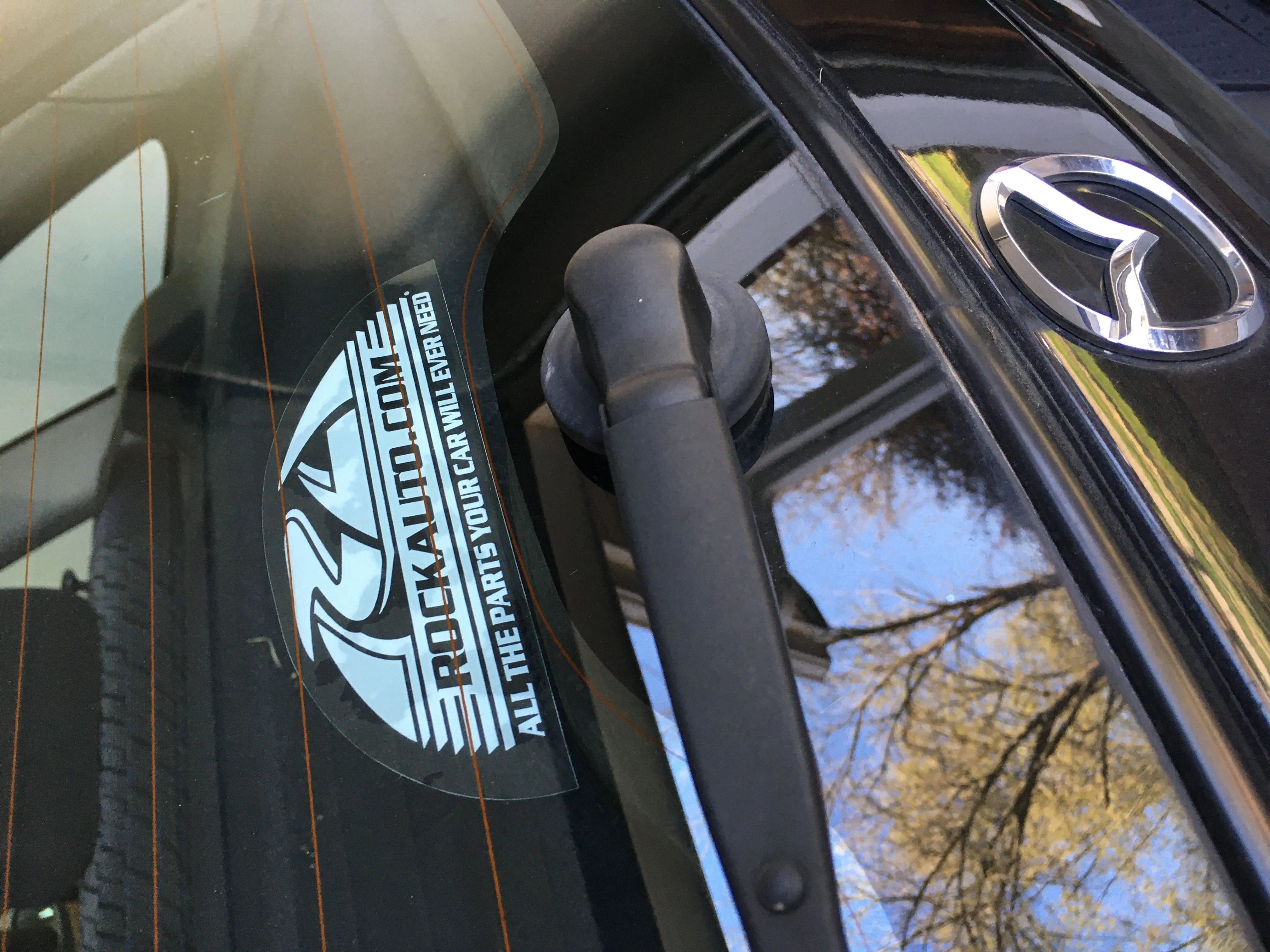

Yeah, I take advantage of that whenever I can. I've got three rear wipers for my Jeep and one driver's wiper for the Mazda.
