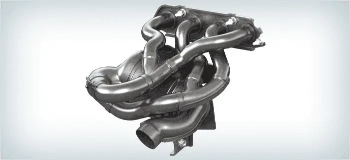

Mount that 4-2-1 exhaust on some kind of fancy platform
