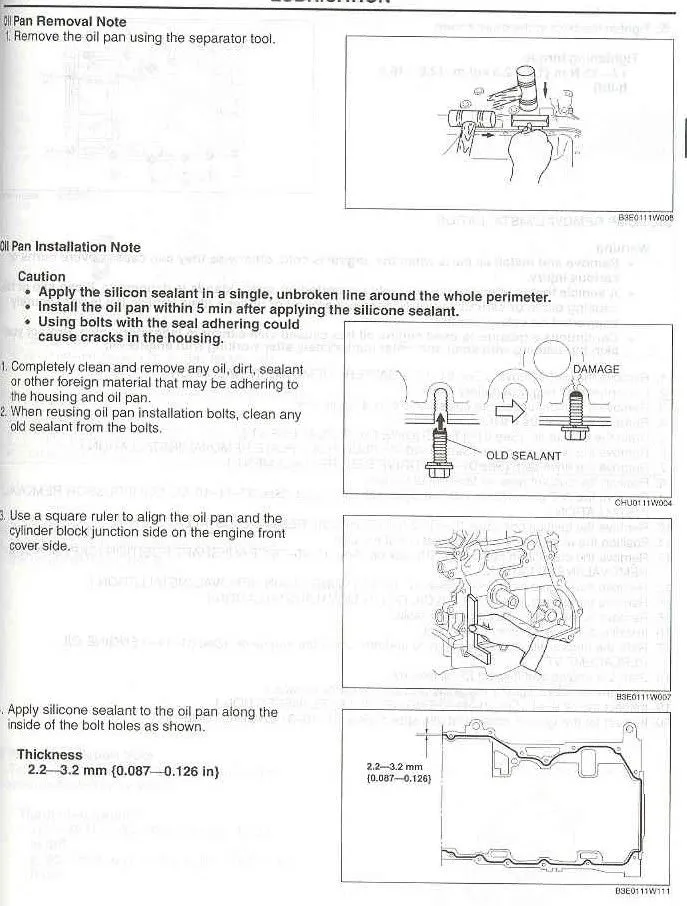

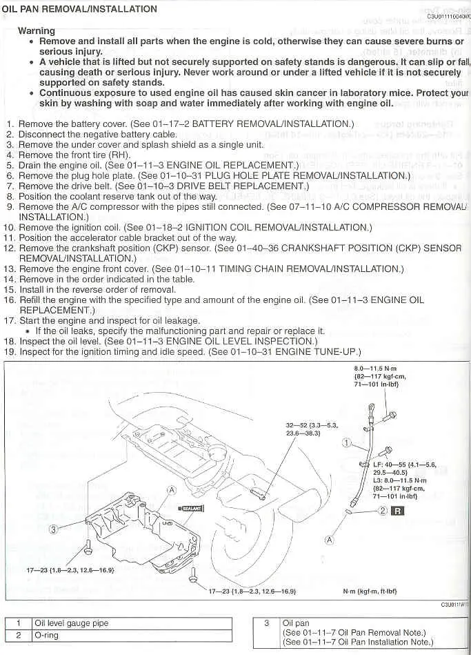

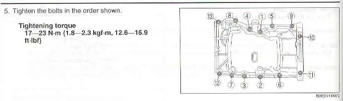

thanks for the info. Do you know how much to tighten the oil pan bolts when done?
Here ya go. Straight from the horse's mouth.
