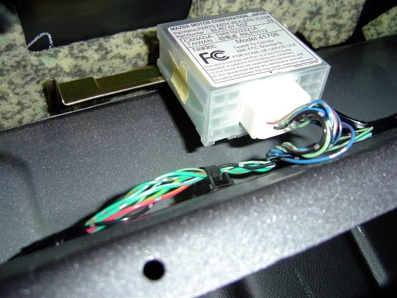

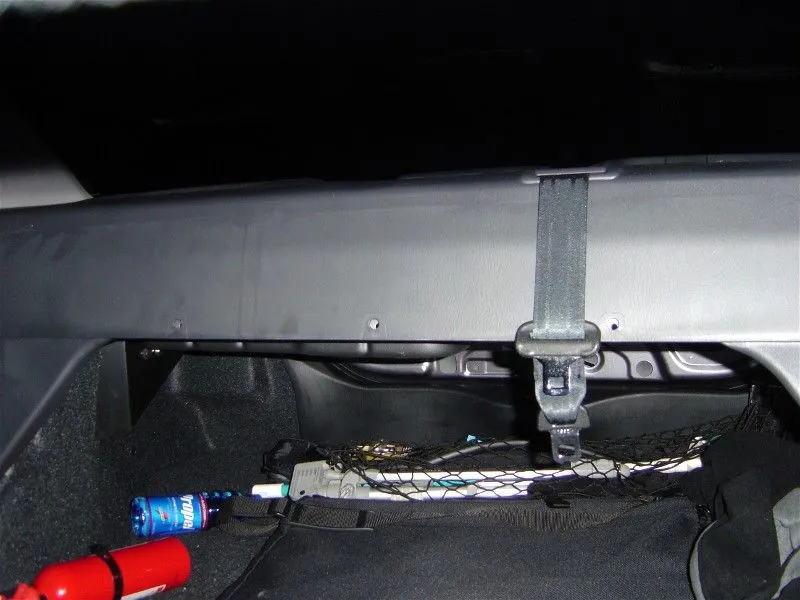

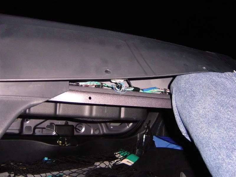

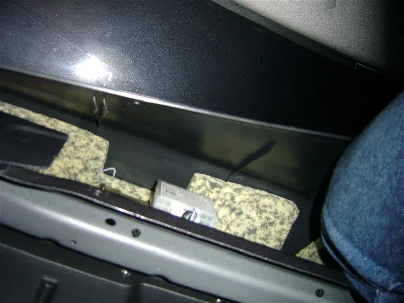

I don't have a TT, but I read this thread & decided to try to find it & take pics for the rest of you. It's pretty straightforward, the pics progressively zoom in on the location of the white keyless entry box.
1. Fold down your back seats
2. Remove the 5 pins from the plastic (don't break them & don't lose them)
3. Pull the plastic toward you (as you can see, I had to hold it out with my leg)
4. Do the wire cutting stuff mentioned earlier
5. Replace everything & you're done

did the blue/white wire cutting on my car this morning......worked! step in the right direction.

FYI.. i cut my wire.. and my alarm/locks still work.. The catch is if you arm b4 the car is off the doors will lock, but no alarm. if you wait till the car turns off, the alarm and locks work fine. For me this is fine, if im in a bad location i just wait the 30 secs b4 i lock the doors, if im in a rush and feel safe i just use no alarm. eventually i will fix it with a relay.
