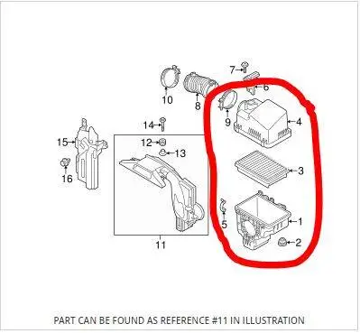

#3 in this illustration is the panel filter, the circled area is the box/filter configuration.
If you look at assembly part #11, that is where the restriction occurs.
That air inlet is anything but smooth. Too many sharp edges and turns. If you remove that, then you still have your airbox and filter assembly intact.
Just stick a 4" flexible hose on the air box inlet, point it forward, or down, wherever it can pick up some cold outside air, and voila, cold air intake. Problem solved. Worked in my old Pathfinder....lol.

On modern Mazdas, the "snorkel" is indeed the first point of restriction, however it is there by design. The snorkel is meant to pull the cool, turbulent air from the area in front of the radiator via the holes in the hood latch when the hood is closed. On the CX-5/-9, there are no air ducts in the bumper designed to allow any significant amount of outside air into the engine bay. By removing the snorkel (and changing the filter element), air flow is less restricted, but the intake is also now pulling in ambient air from the engine bay instead of the cooler air from the front of the radiator. In truth, the OEM intake is actually a cold air intake, it just has a lot of restriction to keep it quiet.
To actually create an aftermarket cold air intake, one would have to extend the piping down into the bumper, attach a cone filter there, then drill some holes in the black bumper trim piece to allow outside air into that area. I think one guy actually did that to his CX-9, but no idea if it made any appreciable difference.

Aside from an aftermarket panel filter, and without breaking out a rotary tool/sawzall, there's no real way to make the OEM system less restrictive. I'm thinking that you could put a hole in the "back" of the snorkel, cut off the bottom half and seal it, then secure some tubing to connect the snorkel to the inlet on the box. But the panel filter and ribbed tubing between the air box and the throttle body would still be points of restriction. Plus, it would probably look terrible, lol.
Edit: Just took a look under the hood. On the CX-9, there's really no room to do anything like that. Might be different for the Mazda6/Mazda3/CX-5/CX-30.

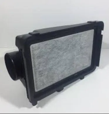

Googling the P/N for the air cleaner cover turned up that picture, which (like the Crosstrek) shows a non-replaceable carbon filter. You'd have to replace the $60 cover to get a new charcoal filter (if you wanted a new charcoal filter). I didn't notice it on my car but I probably just missed it. I guess that's one more layer of restriction that is removed during an aftermarket air intake installation.
In most cars, the carbon filter has been used to absorb hydrocarbons after shutdown. Helps get a PZEV rating. Yawn.
