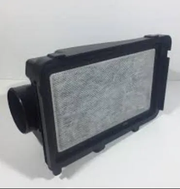

Googling the P/N for the air cleaner cover turned up that picture, which (like the Crosstrek) shows a non-replaceable carbon filter. You'd have to replace the $60 cover to get a new charcoal filter (if you wanted a new charcoal filter). I didn't notice it on my car but I probably just missed it. I guess that's one more layer of restriction that is removed during an aftermarket air intake installation.
Hm, the 2.5T's air cleaner cover doesn't appear to have the carbon filter. It would explain the price difference between the two parts (turbo cover is only $30).
2.5 NA: PY01-13-3AX
2.5 Turbo: PY8W-13-3AX
Just to clarify; besides the presence or absence of carbon filter, the NA and Turbo covers aren't otherwise identical, as the plumbing and air path differs between the two engines. Maybe some upstream tweaking to reduce turbulence with the extra 90 degree bend.

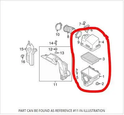

To answer your question without being confrontational.. No it isn't possible to do that because the panel filter is housed in the box. Removing the box means removing the filter, and you don't want an open intake allowing unfiltered air/bugs/leaves into the engine.
#3 in this illustration is the panel filter, the circled area is the box/filter configuration.

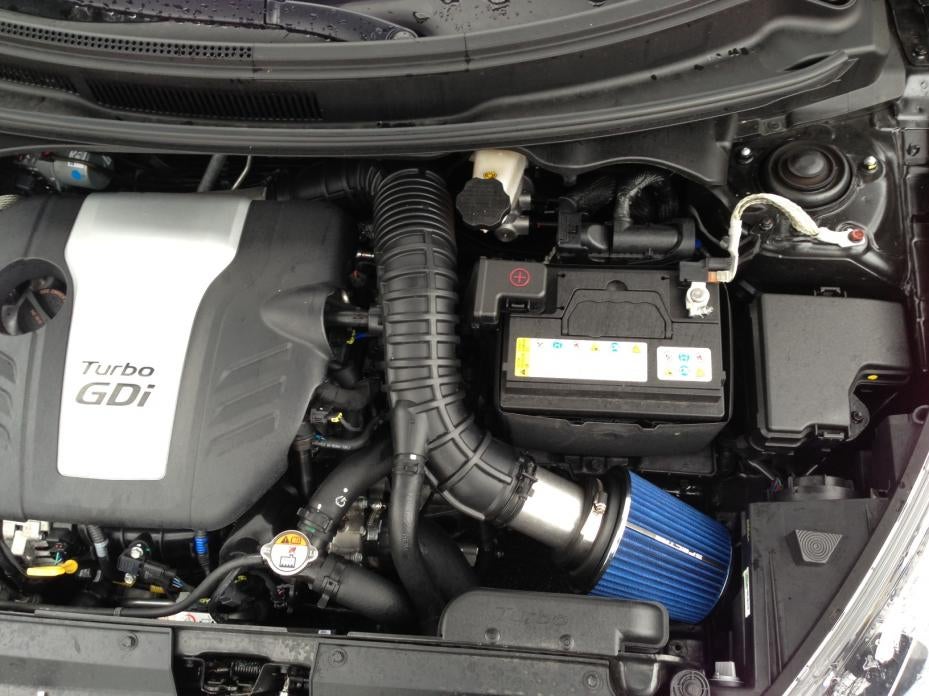

Looking at the illustration, it may be possible to remove the box/filter, and replace it with one of the "cone" style filters these aftermarket intake kits use. You'd need to source a properly sized piece of tubing to clamp the OEM tubing to, then you'd clamp the cone filter to that piece of tubing.
Here's an example of what I mean (vehicle pictured is a Veloster Turbo).
image-10-jpg.2834
I'd much rather just get the kit, personally. But it (theoretically) can be done. I don't think anyone here has done it though, so no idea if there may be any hurdles or issues with going this route. Proceed at your own risk (of voiding the warranty, if you have one).
