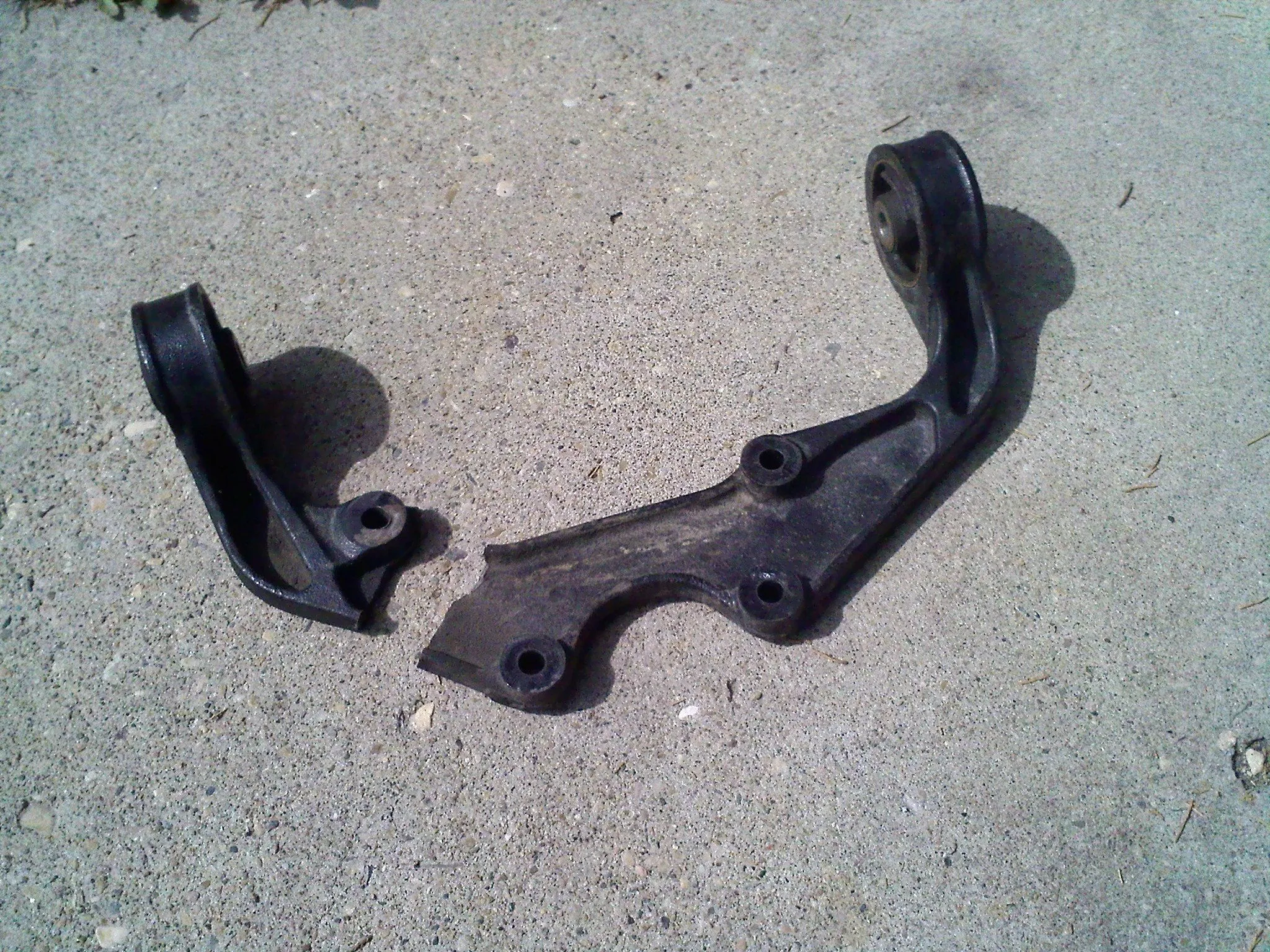

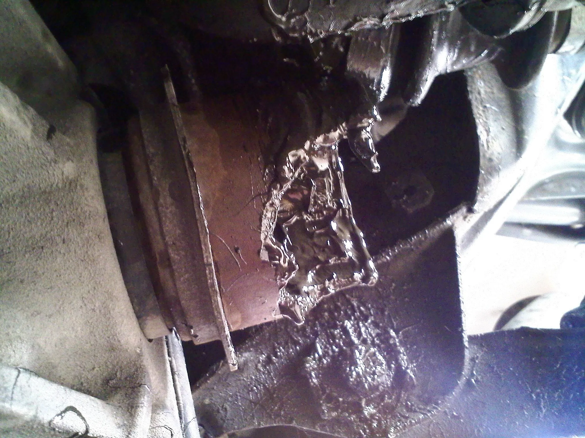

More Problems
06 MS6
MS CAI, test pipe, Maganflow Mufflers, CP-E Diff Mount (New today).
Well lets chalk up another axle for me, and that in turn took the diff mount with it.
