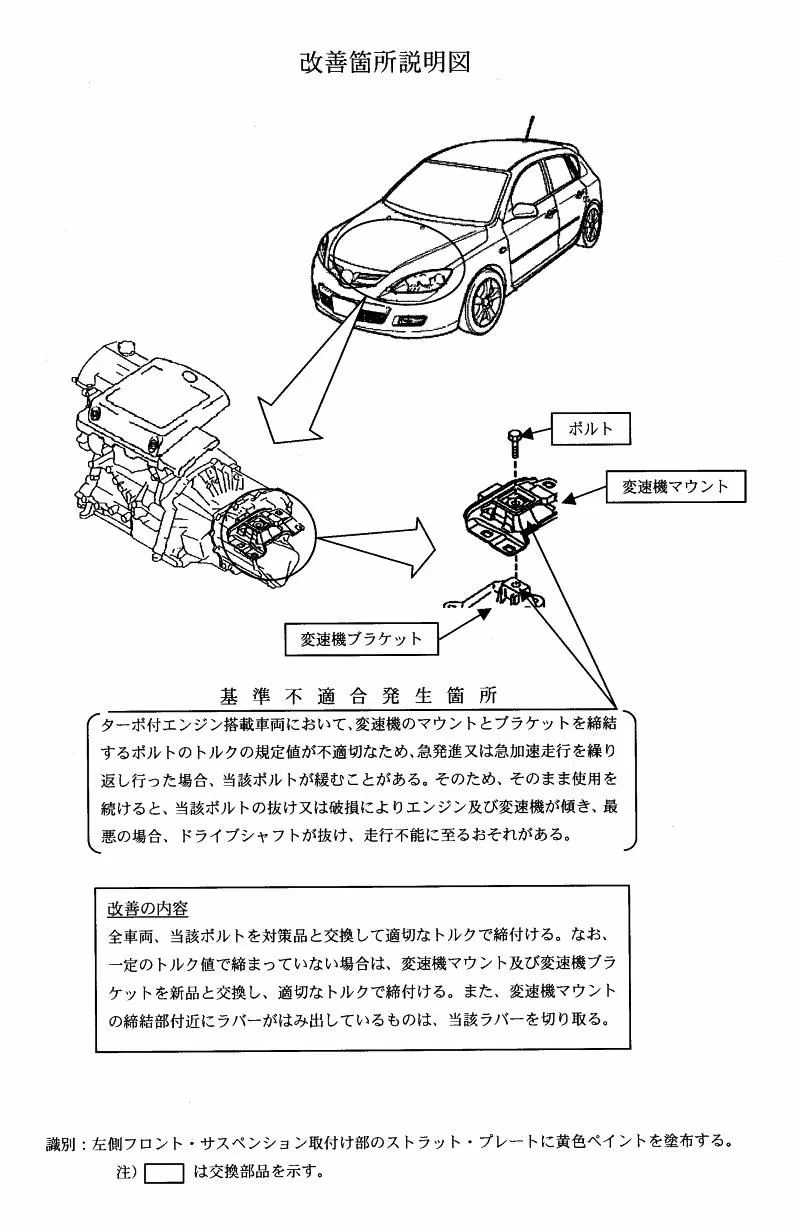

akaiMS3 said:
Dear everyone,
blog gossip is over, it's REAL now.
http://www.mazda.co.jp/service/recall/177/105/002150.html
recall has been issued in Japan as of May 24th '07.
I hope to hear from mazda usa soon.
Have a nice day.
About the recall of マツダスピードアクセラ
2007 May 23rd, the Matsuda corporation notified the below-mentioned recall to the national traffic ministry.
It does to put annoyance to on everyone of regular use, very much, from heart apologizes. Because, from the store, making guide with the direct mail, and the like it receives in the customer who becomes the object, communication it receives to the Matsuda car store of the vicinity, repair (no charge) to receive that it receives, it asks.
Recall notification number 1888 Recall target date 2007 May 24th When there is a standard nonconformance state, the structure which is recognized, circumstance and its cause of the device or efficiency In the turbo attaching engine on-board vehicle, because the mount of the transmission and specified value of torque of the volt/bolt which concludes the bracket are inadequate, when rapid start or abrupt acceleration travelling repeatedly it does, there are times when particular volt/bolt loosens. Because of that, when use is continued that way, the engine and the transmission tilt with the coming out or breaking of particular volt/bolt, when it is worst, there is a possibility the drive shaft coming out, reaching to travelling failure. Contents of improvement measure All vehicle, exchanging particular volt/bolt with the measure item, it tightens by appropriate torque. Furthermore, when it has not tightened at fixed torque value, you exchange the transmission mount and the transmission bracket with the new item, tighten by appropriate torque. In addition, those where the rubber has protruded near the conclusion section of the transmission mount cut off the particular rubber.
Car name Type Alias name Range of under carriage number of object car
And production period Object car
Quantity Remark Matsuda DBK-BK3P アクセラ BK3P-300025 - BK3P-303274
2006 May 12th - 2007 May 12th 2,025 Matsuda speed
Only specification car
< Note > (1) Because also the vehicle which does not become the object is included in the range of the under carriage number where the object car is included, please inquire details at the store of the vicinity. (2) Production period of the object car differs from the time of purchase.
This does not sound like good english. Is this like a direct translation for the Japanese language ?
At least there will be a recall done here in the U.S.
It's an automated machine translation by babelfish. It gives the flavor of the page - pretty funny too.
