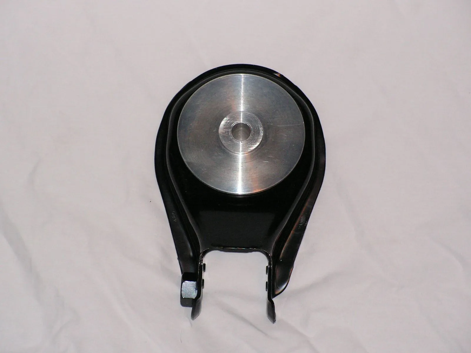

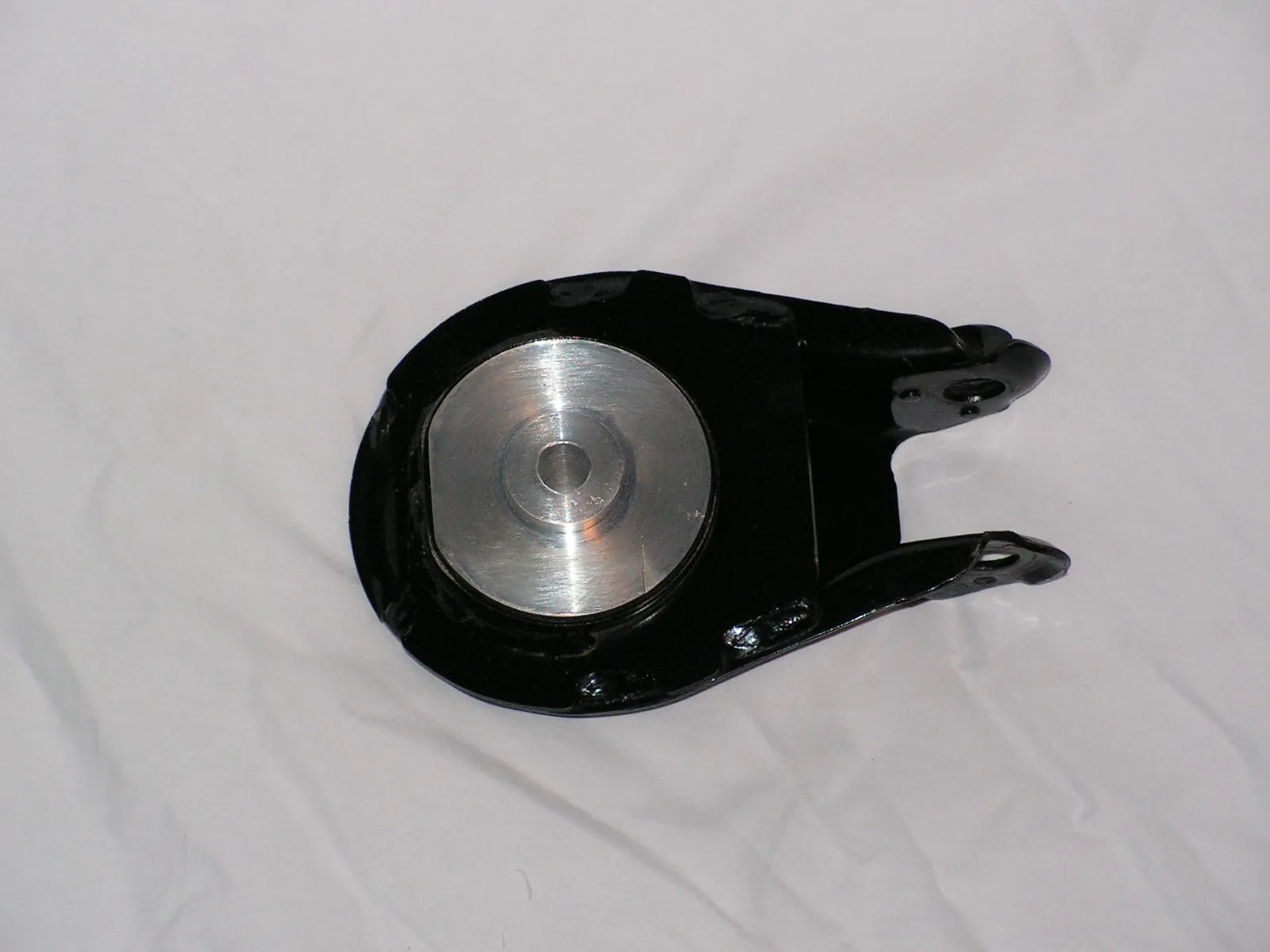

Yes replacing the rear mount helps. We will have a fix for the side mount in 4 to 6 weeks. There will also be a saftey support that comes with it in the case of a failure to keep the motor from falling on the drive axles. Here are some pics of our rear mounts. Solid mounts are shown below and the filled mounts are listed here http://www.mazdas247.com/forum/showthread.php?t=123664148. They both have similar added vibes sent to the cabin but the solid mounts cut wheel hop to almost zero. It takes a while to get use to the vibration but after a week I didn't even notice it.
The rear mount keeps the motor from rocking and its the rocking that snaps the bolt. Reduce the rocking and you will have much more life out of the bolt. Cutting down the rubber lip on the stock mount is a very good thing to do as well.
You really notice it the first time you drive with the new stiffer mount. The stock mount is so soft you really notice it between shifts. The engine really moves up there and I see why the stock mount can fail under that much stress.
