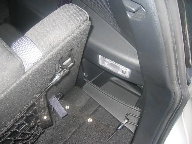

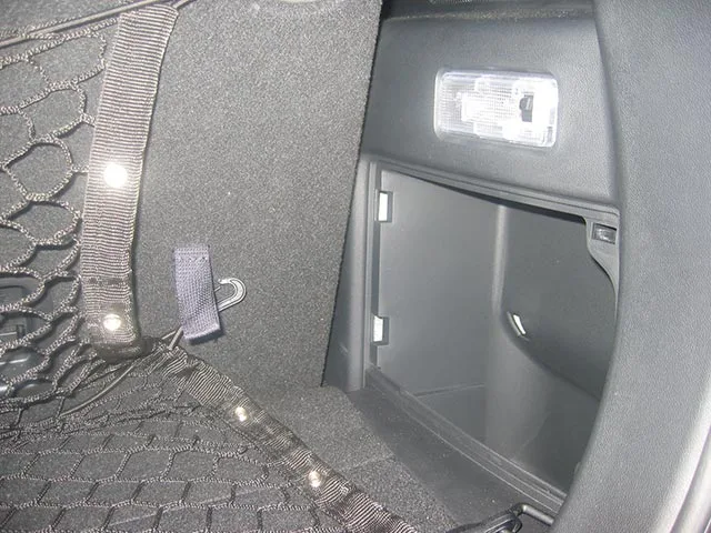

I can't cut, the car is 2 weeks old :(

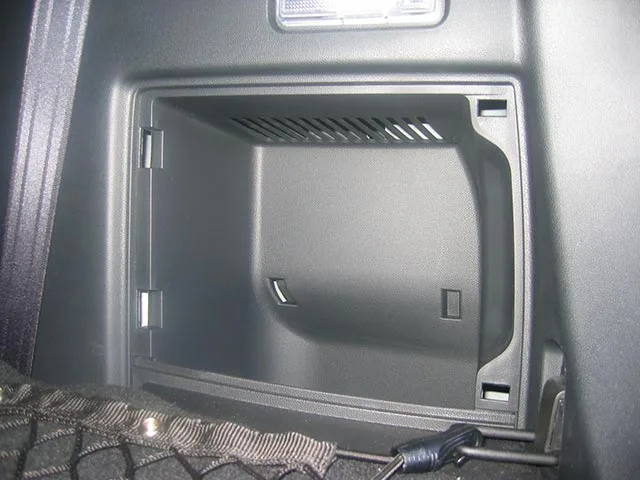

The actual dimensions are-
deep- 4 1/2" curving to 4 3/4"
outside height - 7 3/4" tall
front 10" wide
internal height 12"
There is a 2" x 10" cavity at the bottom, like an area Mazda just left uncapped or something also.
So it's a 7 3/4"x10" opening 12"x4"10" internal with that 2"x10" cavity.

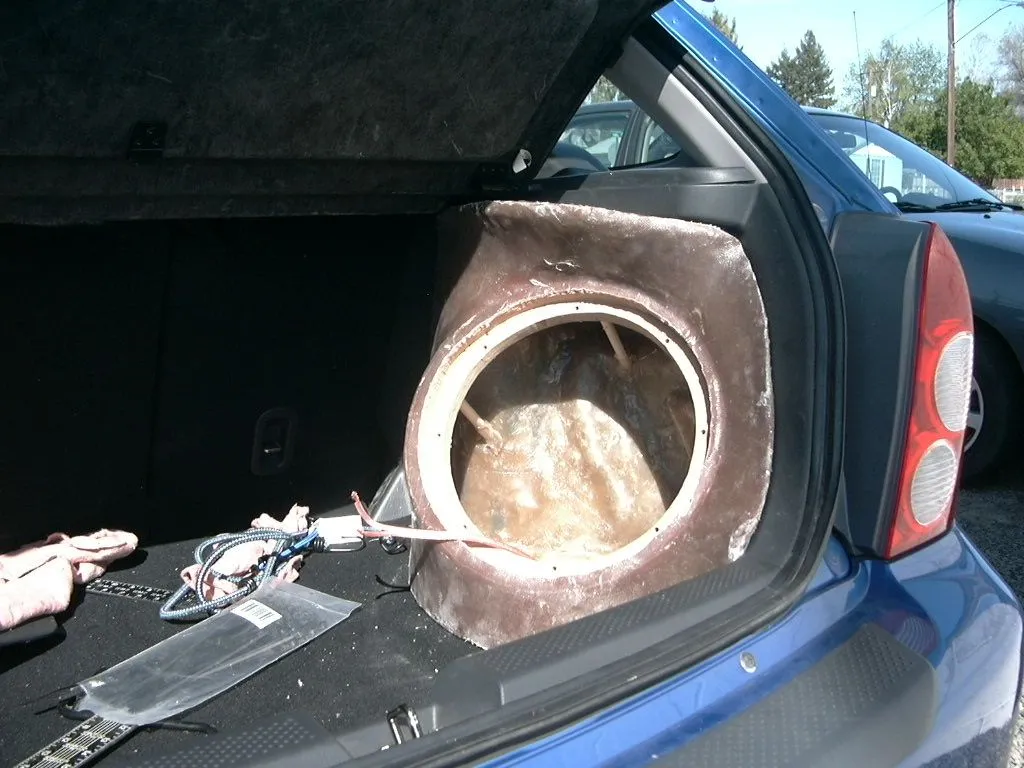

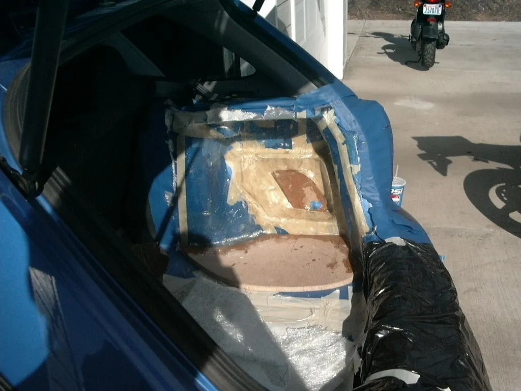

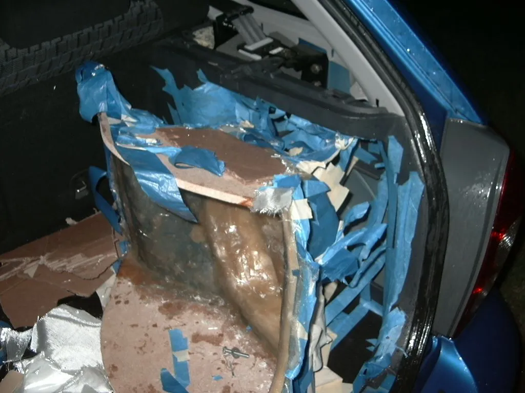

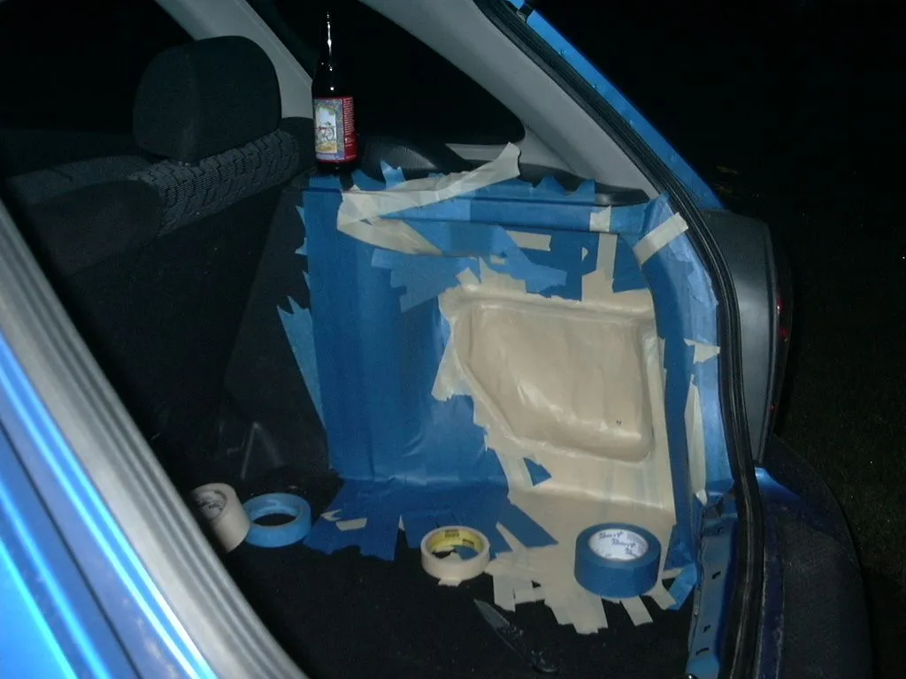

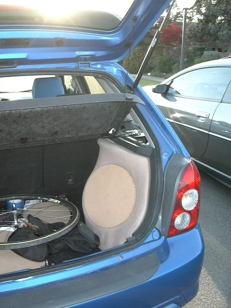

WEll since apparantly this forum kills old pics, here's some form my fg project.

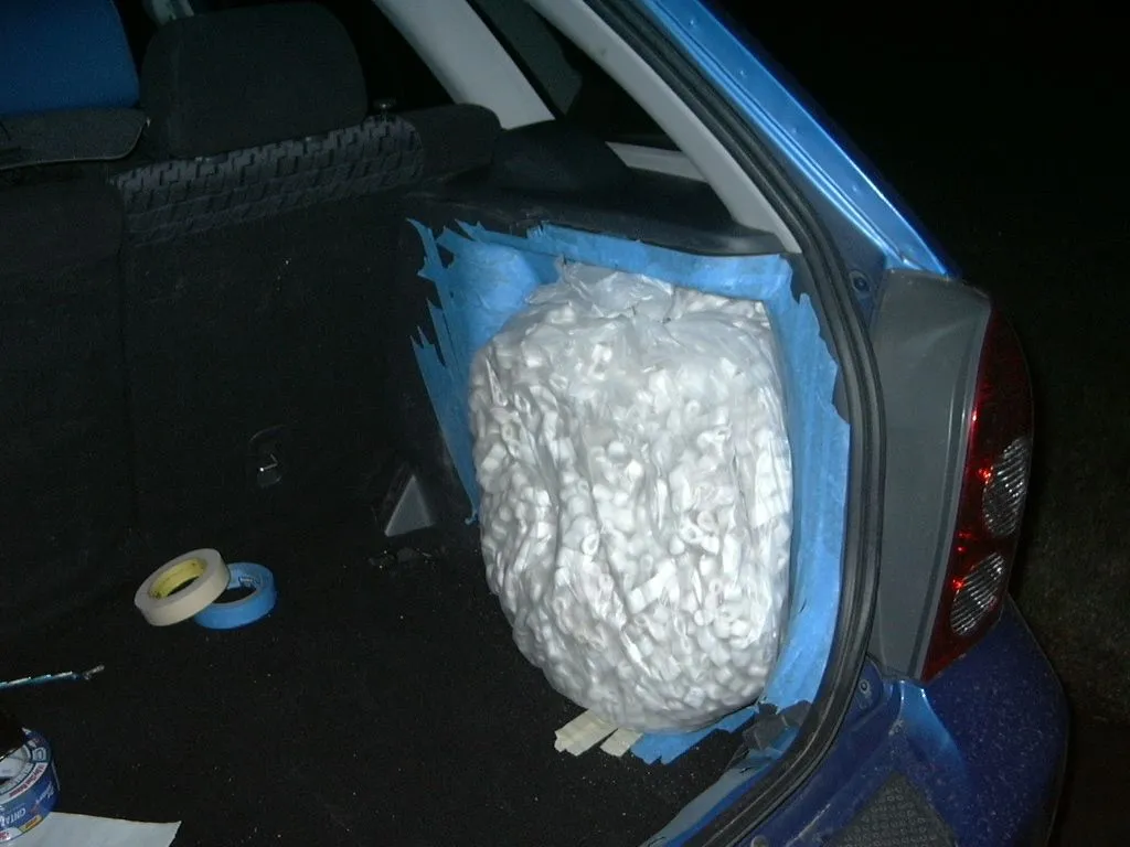

1.2cubic feet of styrofoam peanuts in a plastic bag to approximate volume.
mostly final taping off of my area.
first layer of glass and resin
Popping the mold.

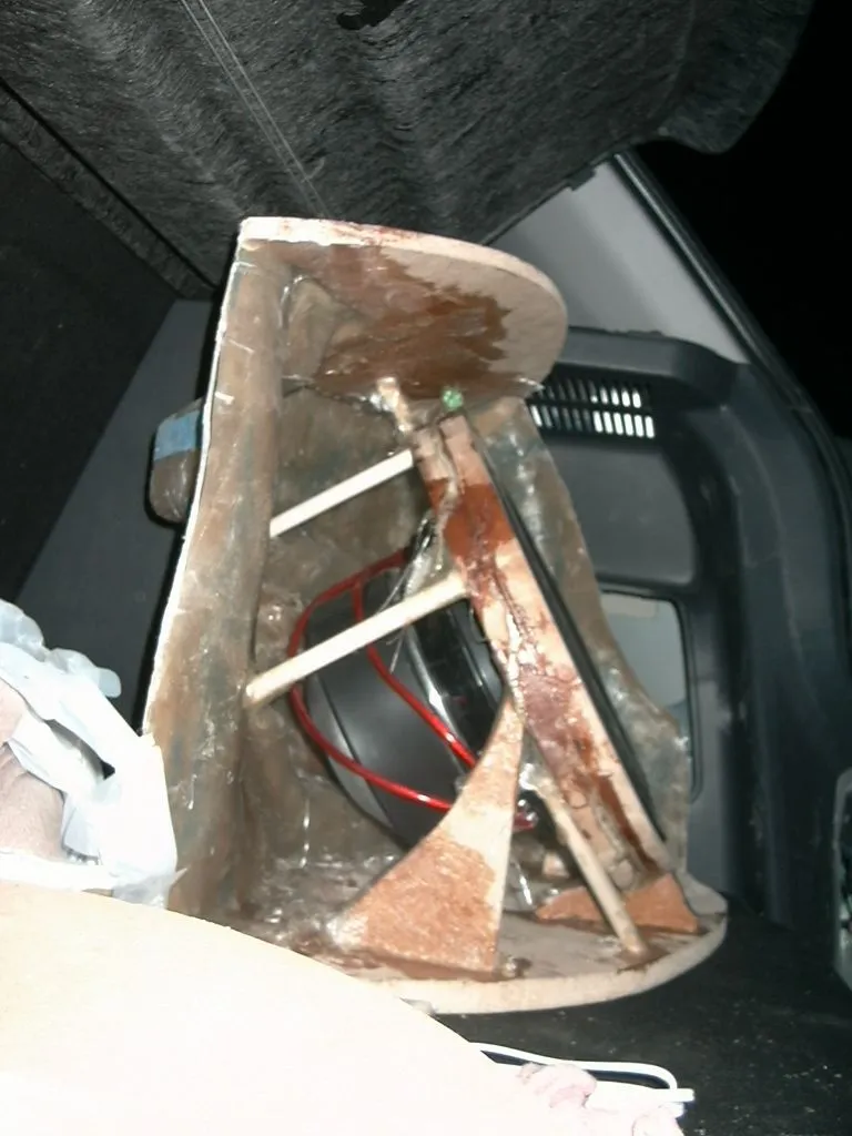

Mounting rings hotglued and resined inplace with scraps and dowling. ANd sub fitted to test for clearance.

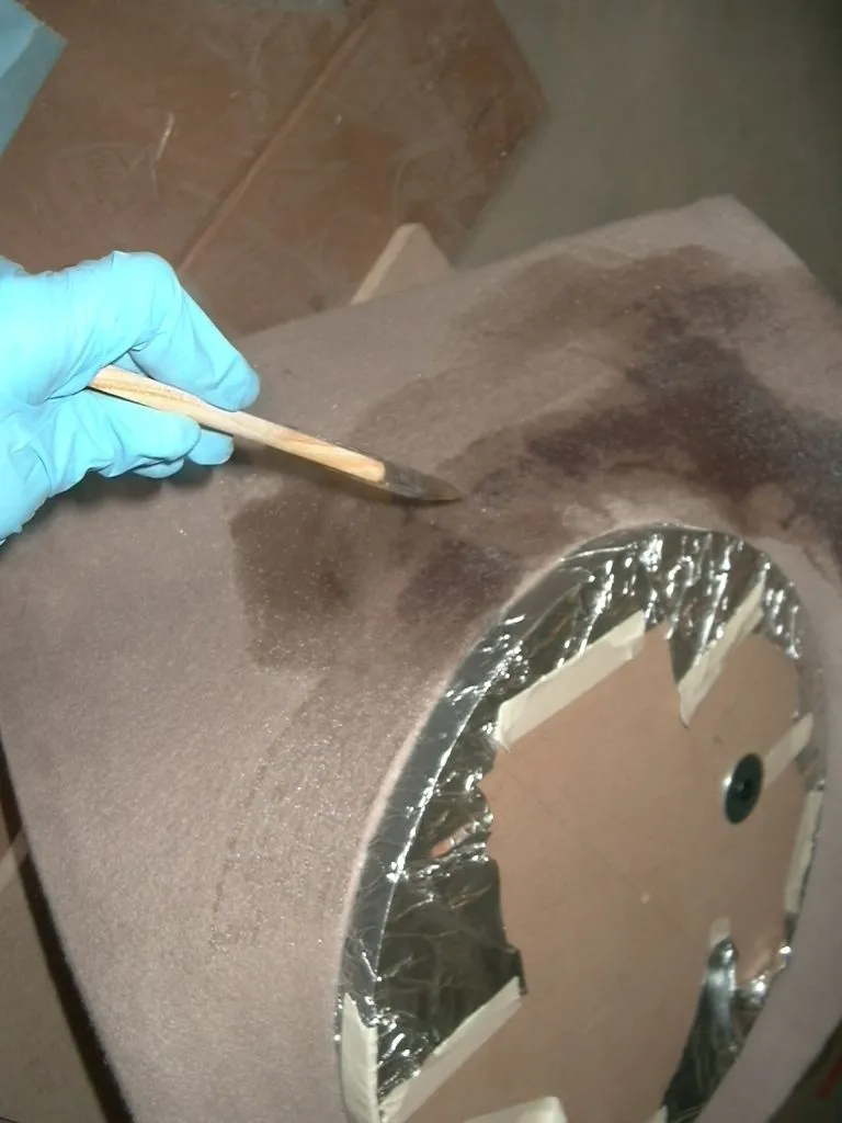

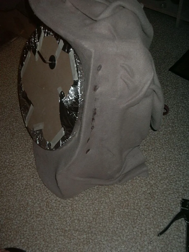

fleece loosely stretched, testfit and asthetics check.
Fleece stretched/hoptglued in place
soaking fleece in resin
Fleece soaked, 4layers of fg ontop

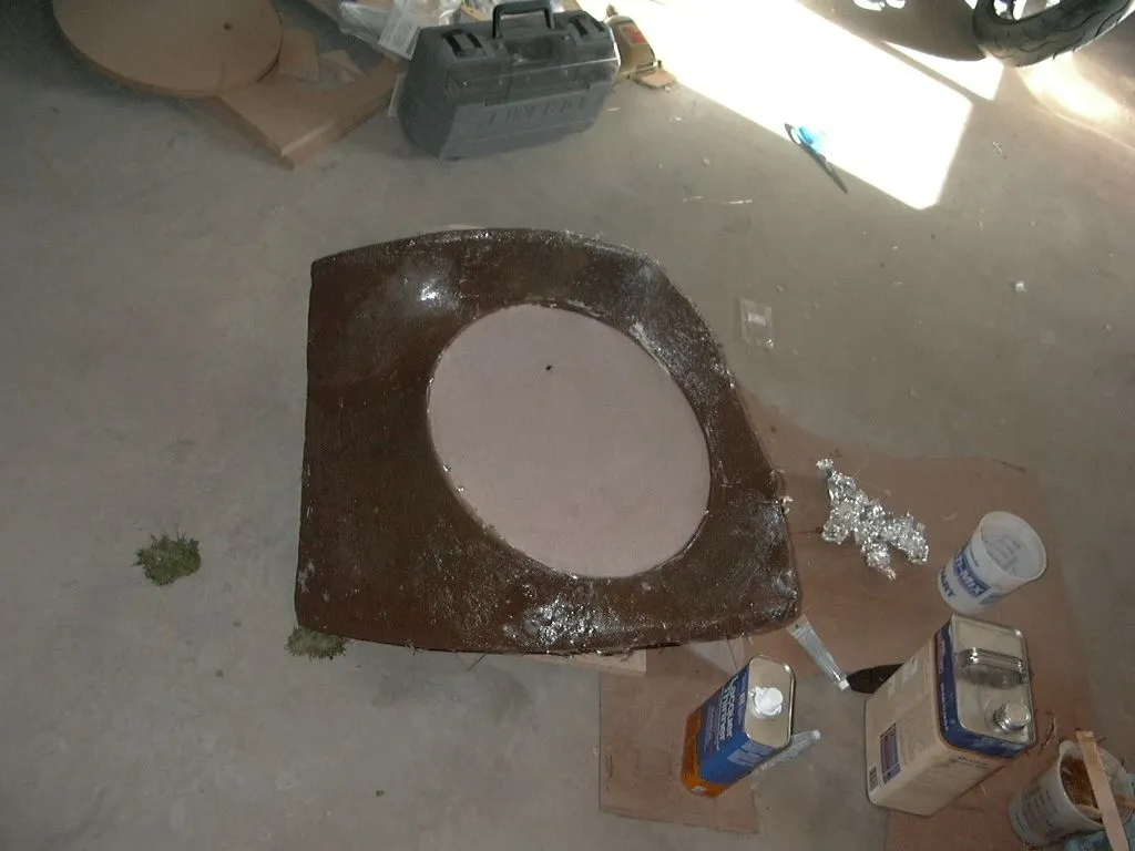

trimed, hole cutout and testfit
Note, this is simply how I did mine. Take note that the wood is VERY securely bonded to the resin. matter of fact right after I popped it and leyerd on a couple more layers of resin I coudl stand on the top shelf.
For your case things could possibly be simpler, especially if you can simply use your panel/cubby as a form and simply pop it out and layerup some thickness onto it, then it's just a matter of bonding a wood faceplate to it. This would be permanant, but clean and out of theway with little to no impact on useable space. PLUS you should be able to keep most of the mess out of your kidhauler... I really do think that's the best idea. And yea that cubby should be removeable wether you have to pull the whole damn panel or not it's doable. Yes it's weird pulling panels off of your new car, but it's rather painless really. PLUS you cna dynomat or whatnot while you'rebackthere and make your ride thatmuch quieter (esp in the rear wheelwell area I've found on almost all wagon/vans)
Now with your amp situation, what exactly is your available space again? is ther eroom for 2? sofar this is sounding like your best bet if you've got limited space, get a single 2ch amp for your fronts and then aseperate small single either mono or 2ch amp for the sub.

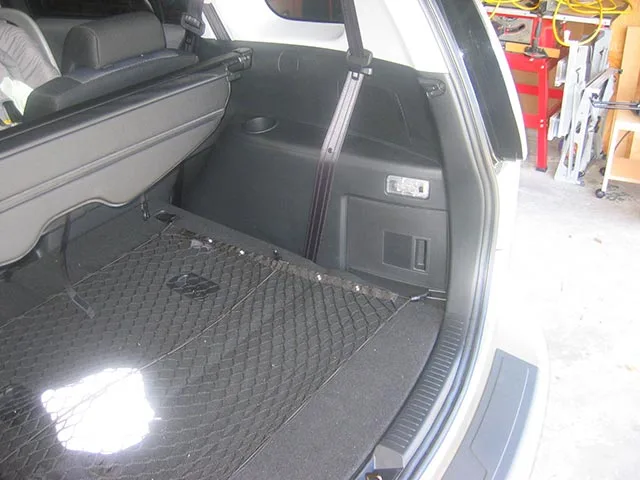

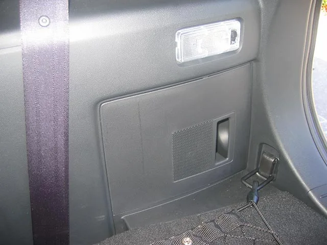

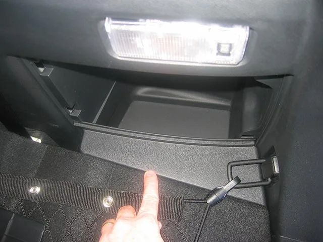

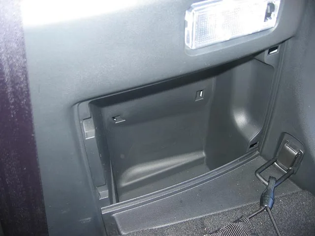

chuyler1- The panel is all one mold, there are no pieces. It runs from the back all the way to the front door and up to below the window. It's a huge piece, as some have had major issues replacing the rear speakers, 3rd row seat needs to be removed, etc.
Here are some more pictures to show in better detail-
You can see the compartment is part of the entire side panel and you can see how large that side panel is.
Also, I didn't realize that I have the seat to contend with, but I still have clearance it will just be really tight.
