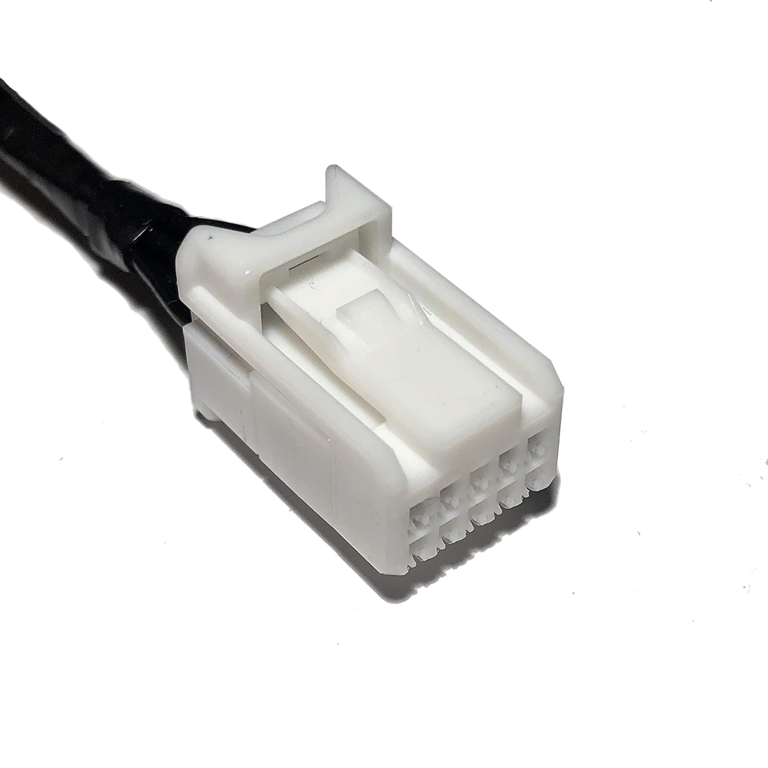

Okay, Studum sent me some photos of the frameless mirror plug.
The bad news: the signature model (or any of the frameless mirrors) uses different connectors (see pic below) than the non-frameless mirrors, so my adapter from above wouldn't work. The good news: I have access to these connectors (they're used in frameless Prius and all frameless Lexus models) and can design and build a compatible version super quickly.
What I need to figure out now is do all Signature models (mazda 3, all the cx models) use the same mirror part no? Is there enough demand for this adapter or does somebody know if all Mazdas going forward might move to this new plug?

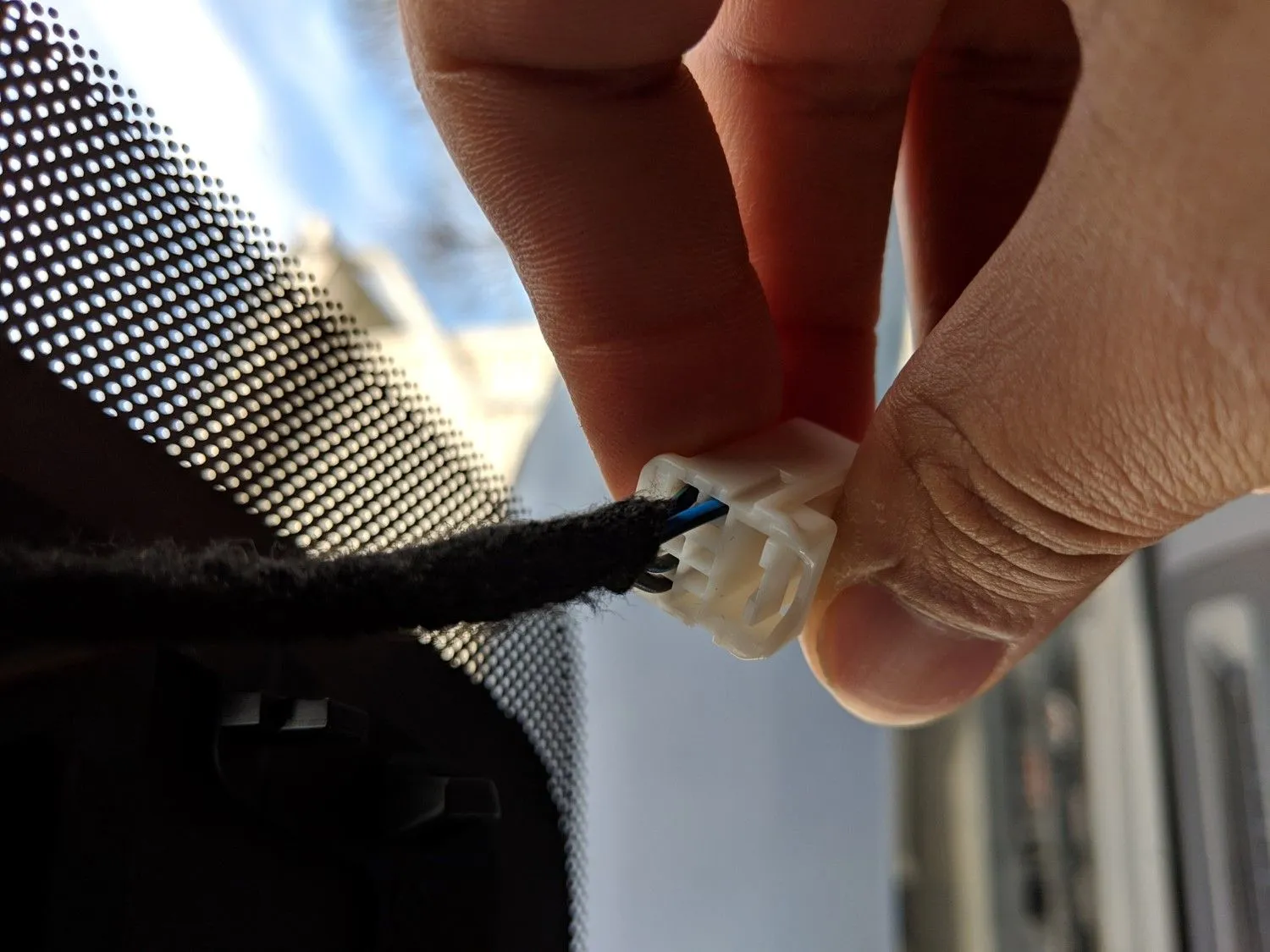

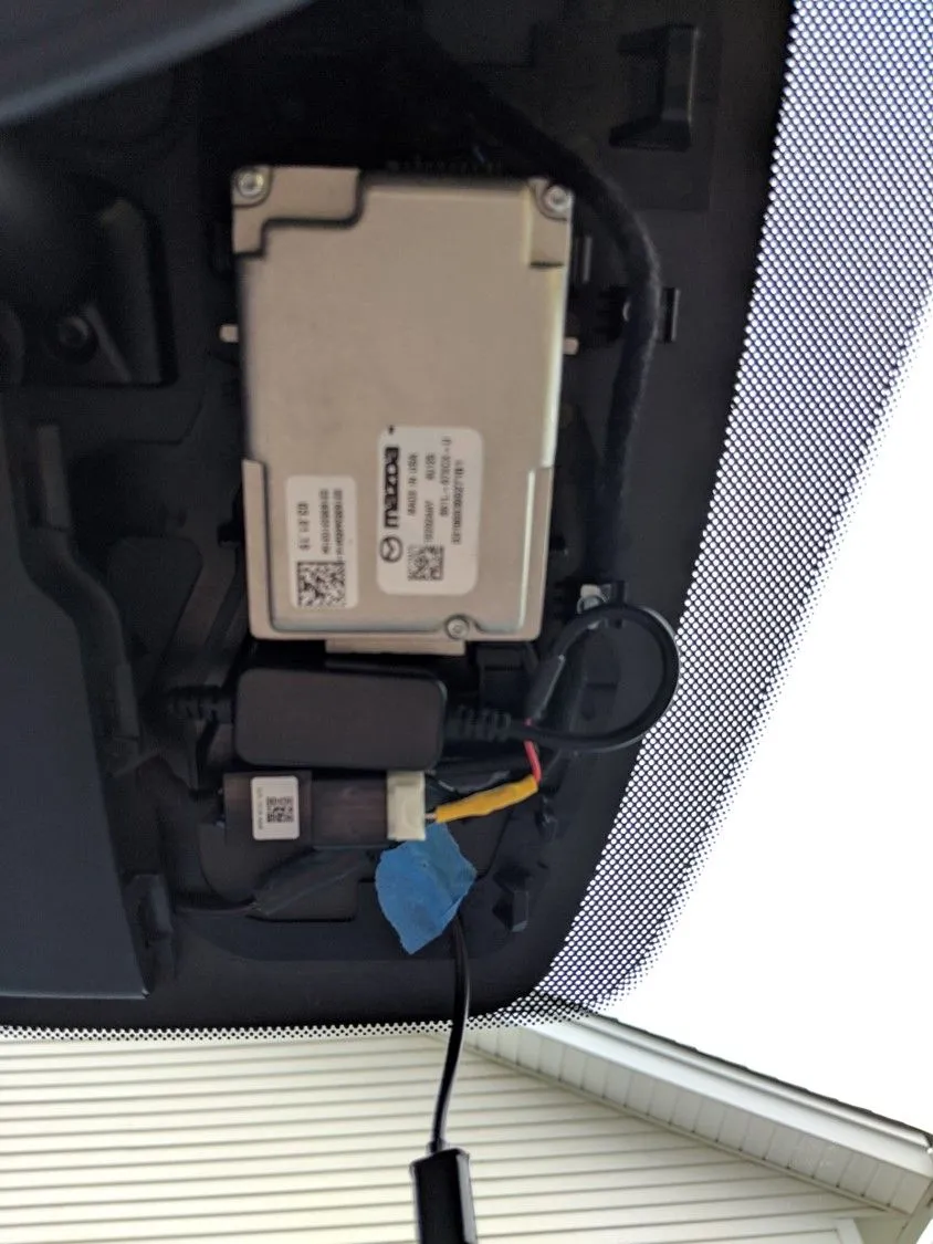

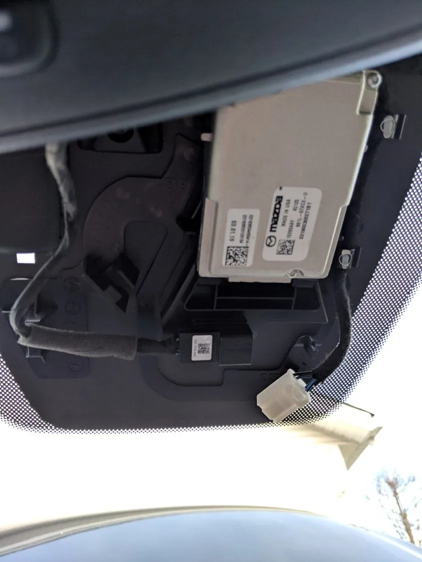

Finally got some time today to install dashcam. Did some work with the multimeter to figure out wiring on the frameless mirror. First had to identify which pin was ground by running a wire to ground nut under the hood and testing for continuity. Then once I had that, tested other pins for 24v with ignition on.
I used an invisicord to tap into the white plug. 10 pins but only 4 are used...ground is black wire on top left and switched hot is blue/black on bottom right.
See pics below.
View attachment 220722View attachment 220721View attachment 220720View attachment 220718View attachment 220719

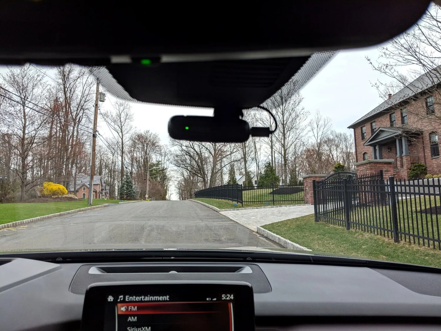

The video quality is actually pretty good for a cheap cam.
The Viofo A129 series is far from a “cheap cam.” Viofo is a very well respected Dash cam company. The image quality of their A129 Pro series cams is better than the big brands like ThinkWare and BlackVue that sell for $500+. It’s a great company with great products. I would recommend wiring the cam into a Cellink NEO battery, then to your fuse box. It will increase your parking mode recording time significantly and take the load off your battery.

I was struggling with this part as well. I was very scared to use any force. Finally I got it off. The pins on the covers are designed in a way that it unlocks when you pull them towards you. You can put a finger through the Mirror shaft hole and pull towards you, or you can use the little slit at the bottom of the cover where it meets the windshield. You then pull it towards you - you will hear some creaking, it's not the pins breaking but the pins unlocking. With all that said dont use more force than you need to. The covers will the split in the middle. At that point stop pulling and merely slide them across. For me the right side slide off and then I had to jiggle the other side from it's pins. One the covers come off I used the B (black) and I (yellow) ports from the following post
The hardest part was getting the invisicord pins to stay in, since they don't go all the way in; even though I got the micro pins option. Infact I broke one of them by using excessive force. But for me that worked out even better because I then proceeded to cut both the pins off the invisicord and soldered a couple of thin needles instead. They went right in, all the way.
There's enough room between the sensors and the homelink to secure the invisicord box using the 3M sticky that comes with it.
Use some tape once you have everything plugged in, because the wires will move when you put the cover back on, trust me I found this out the hard way; my pins had come loose while putting the covers back on.
