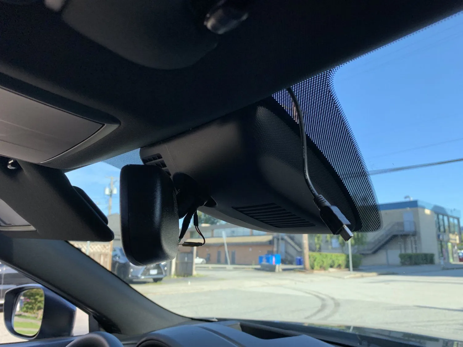

Super clean. Love this. How much was the invisicord? Did you purchase from K3vonn? Amazon? or Direct? Can you take a picture of your invisicord plugged into the mirror? Looks solid.
The invisicord direct with fuse, micro pins and mini usb was about $55 CAD shipped to Vancouver. I'm not sure it needed the fuse, but didn't want to have to wait. Shipping took 3 weeks though. You can actually still see it in the above picture plugged into the back of the mirror, and then running into the electronics cover. It then exits at the top, runs into the headliner and then straight down to the A119 V3.

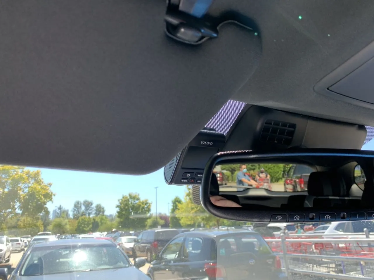

The one thing I just noticed is that the placement is a bit too close to the dotted shading on the window. You can see the video on the right side has a bit of occlusion, and then you can see how I mounted it from the front.

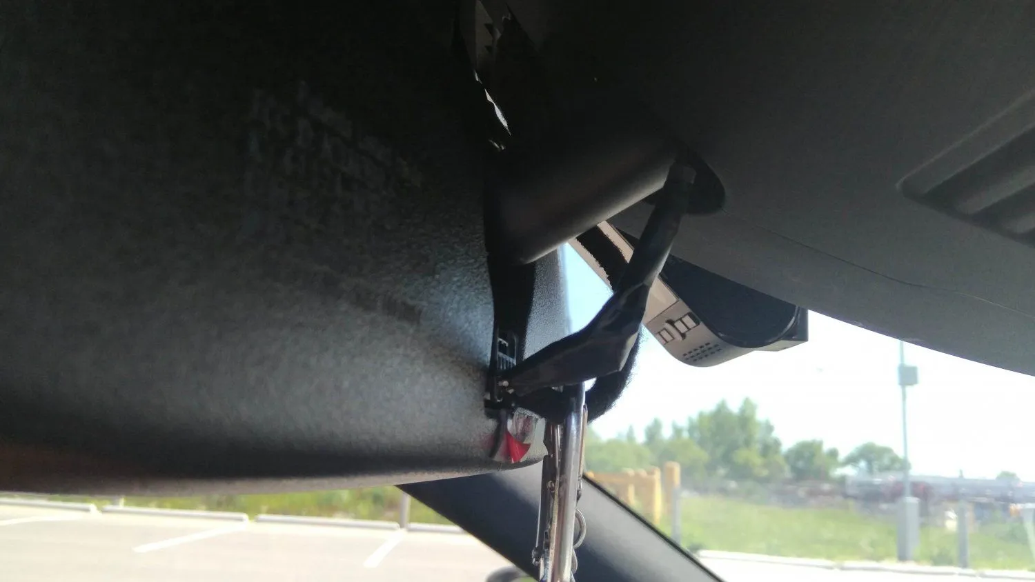

Also had this pic from during the install. The invisicord sticks out a little from the back, but you don't notice it at all when getting in/out and driving. I do wish they didn't use yellow and red though for the wiring. Maybe I should sharpie it to darken it.
Yeah, the yellow and red do catch the eye a bit on mine too. I'm going to try wrapping them in black electrical tape so it looks a little more OEM.
We mounted our dashcams in similar spots, lol. The dot matrix is also visible in my playback, but you can see a lot more of it. Doesn't bother me enough to move it though.

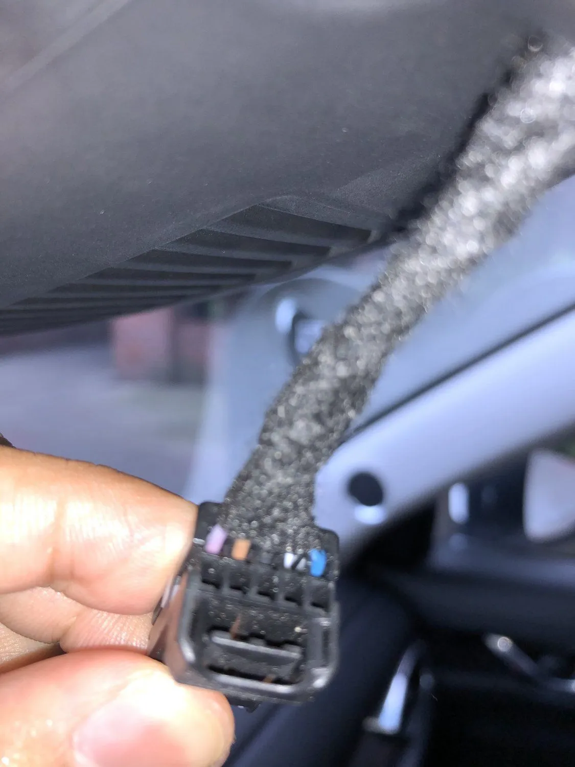

Disconnected the power harness going to my homelink autodimming mirror. Looking at the harness from behind, there are 10 sockets. Only the bottom 5 do anything. Green (bottom left) is always on. Middle is ground, and so is the one just to the right of it. Blue (bottom right) is switched (12V on but only with ignition on). I plugged invisicord black micro connector into the middle grounded socket, then the yellow positive lead into the same socket as blue. This way, dashcam turns on with ignition, off when car is off. Avoids having to tuck wires into trim and frees up 12V power for other things.

Also I took my home link wire to see the wiring - the black is ground and which wire do I tap for just when engine starts?

Hi folks. I got an invisicord (fused) to go with my Garmin 56 Dashcam. My Cx-5 is 2017 Touring and not sure which is the cable for running car only? Black for ground, and Pink/Purple? Just like Twilos image.
Because that is what works to turn camera on for running only. And the Invisicord bent! I mean, for the black to ground, inserted fine. But for the purple it bent. And I made sure the flat side was down. Damn eyes going too. Got it working but I don't like the hot (yellow shrink/red) to the purple has exposed metal pin.

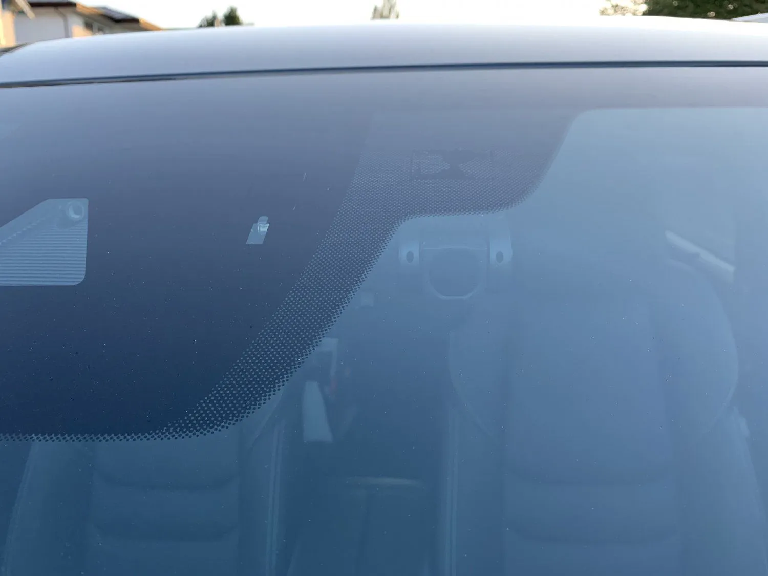

Anyone have any issues putting the double sided tape on the part of the windshield that has the dots? Previously I stuck it right below but now I want to move it and better place the tape would go over the black circles.
The trick I use is use 3m tape and completely clean the glass with alcohol. When you install it I find that if you use a heat gun or hair drier to gently warm the glass surface when you apply the 3m tape it will adhere better than if the glass is cold.
