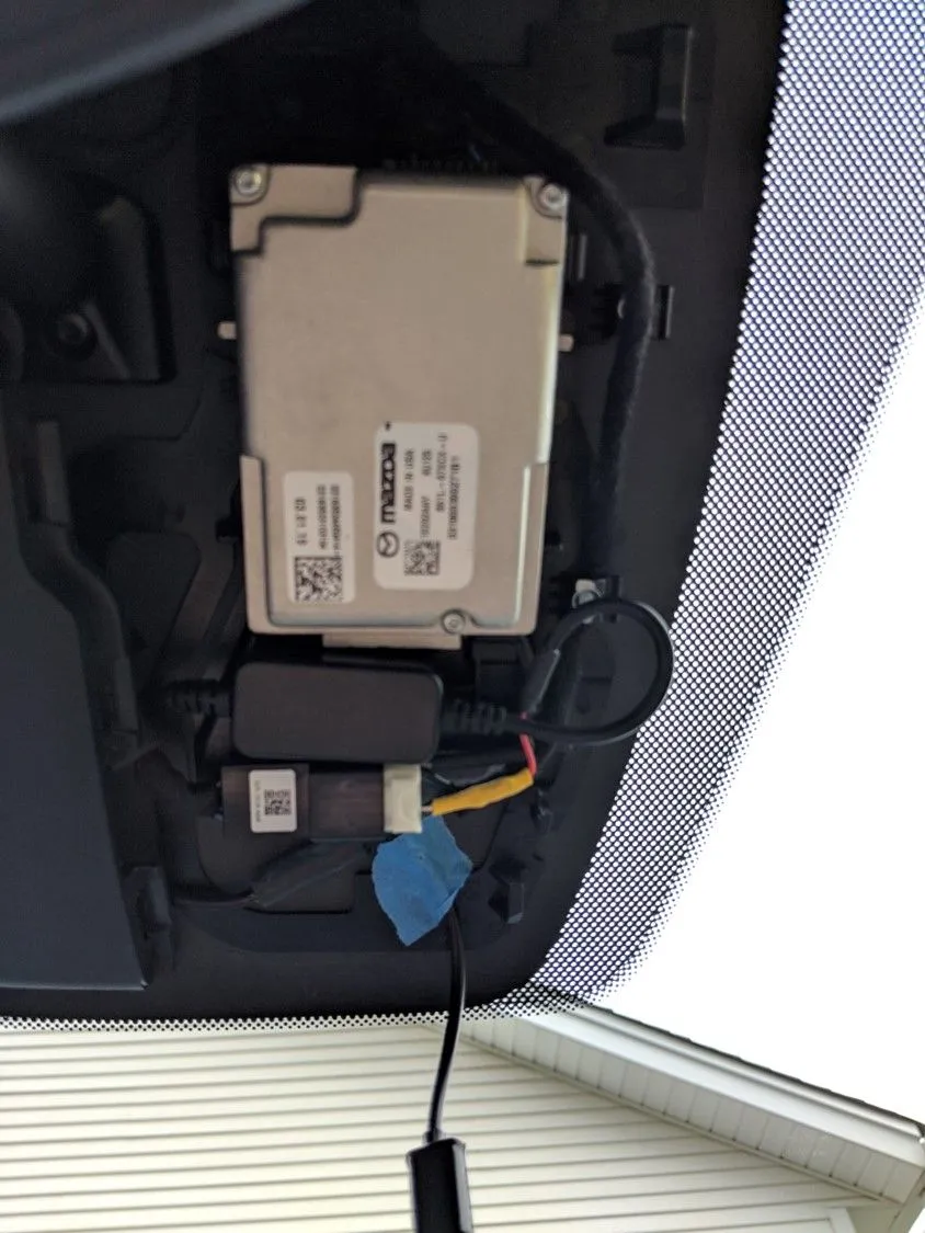

I plan to do this for my wife's CX9, but I don't see any mention of how people are hiding the power brick portion of the Invisicord. How are you hiding the power brick portion of the Inviscord?
Thanks!
Thanks!
Mine is actually just resting against the console that houses the camera on the windshield, you can actually see it in the last pic of post #5 on the first page of this thread. There might be room to jam it up behind the headliner with the rest of the cable, but I didn't bother with trying.
Thanks!
For the 2019 with the frameless mirror, you have to open up the plastic cover to access the plug anyways so you can hide the power brick inside the cover.

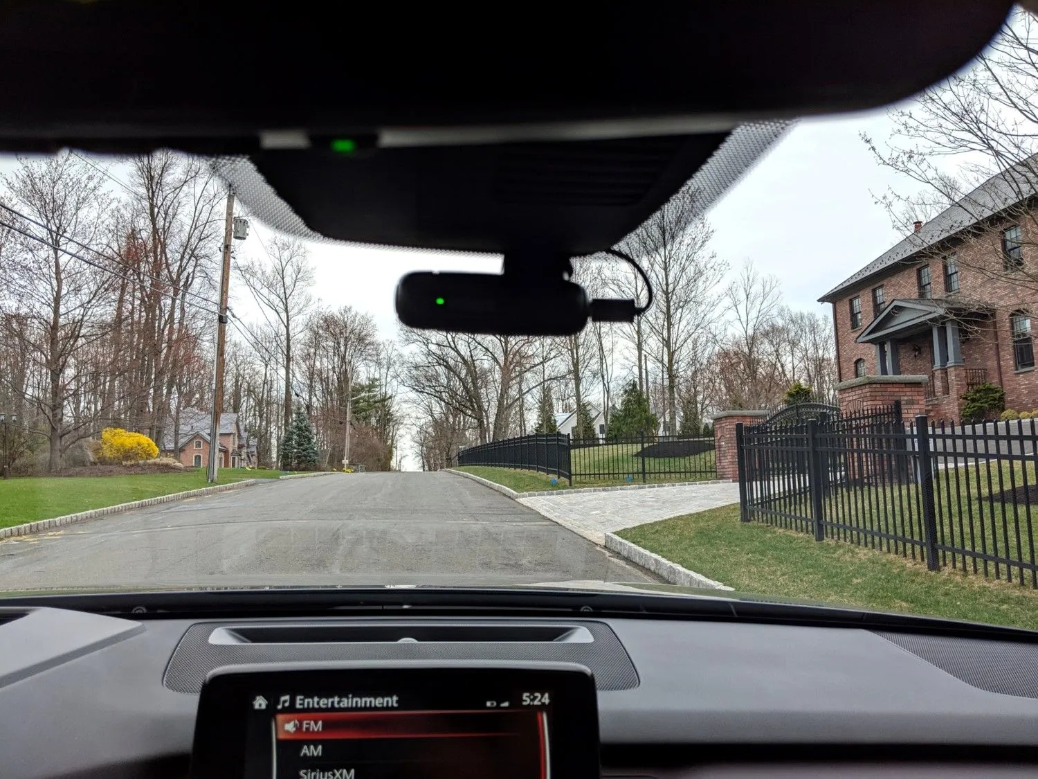

The new dashcam is a Viofo A129 Duo (~$130 on eBay w/ one of their 15-20% off coupons). It is a set of two cams, one front and one rear. With this particular front and rear combo, the rear camera transfers data and gets power from the front camera via a single cable. This means that video footage from both cams are written on one microSD card (vs. buying an extra card for the rear cam). This also makes the rear cam a little easier to set up as you don't have to use the 12v socket in the cargo area.
In terms of features, the A129 offers motion detection just like the original dashcam, as well as a parking mode (time-lapse combined with motion detection). It also has Wi-Fi capability which is nice if you want to review/download video footage and don't want to transfer files from your card to your laptop first.
The thing I love about these particular dashcams is their design. The wedge style doesn't obscure your view and doesn't look as bulky as some other cams, and also includes a usable LCD screen. From the outside looking in, the camera looks like its just part of the collision mitigation camera/sensor array.

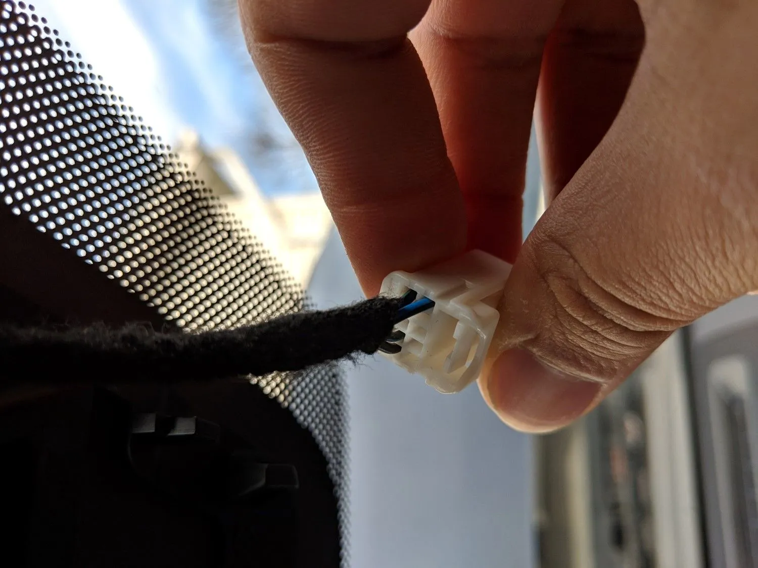

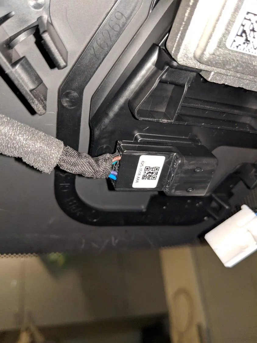

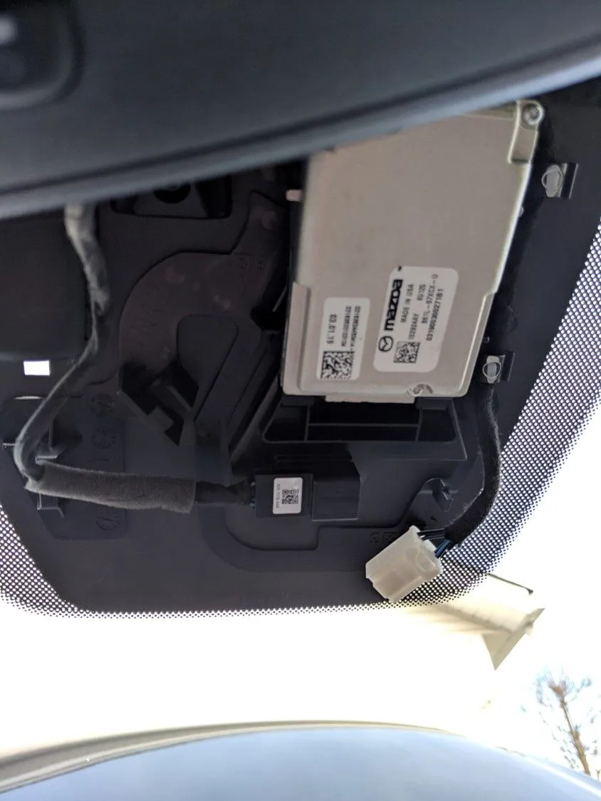

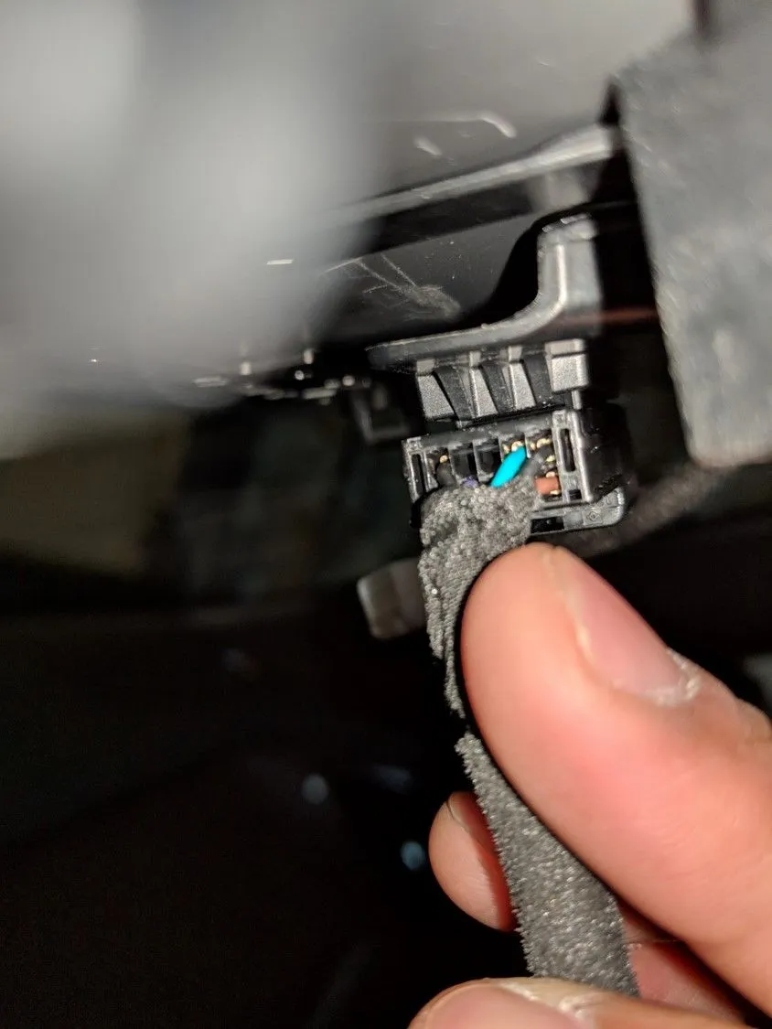

anyone have wiring diagram for the 2019 frameless mirror connector? I'm looking for switched power for my dashcam (don't need constant on).
Here's the connector coming off the mirror for the frameless mirror.
it's 10 pin:
Top 5 (left to right): Black, empty, empty, Teel, Black
Bottom 5 (left to right): Blue, Purple, empty, empty, Brown
See pics attached. Any ideas which is ground and which has switched power. I have a multimeter so I can try fitting thin wires in there one by one and seeing which has voltage, but don't want to blow fuses.
I don't think you will blow any fuses IF you grounded the multimeter to an outside ground. Just poke the pins with the positive lead.

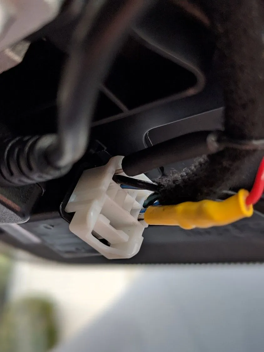

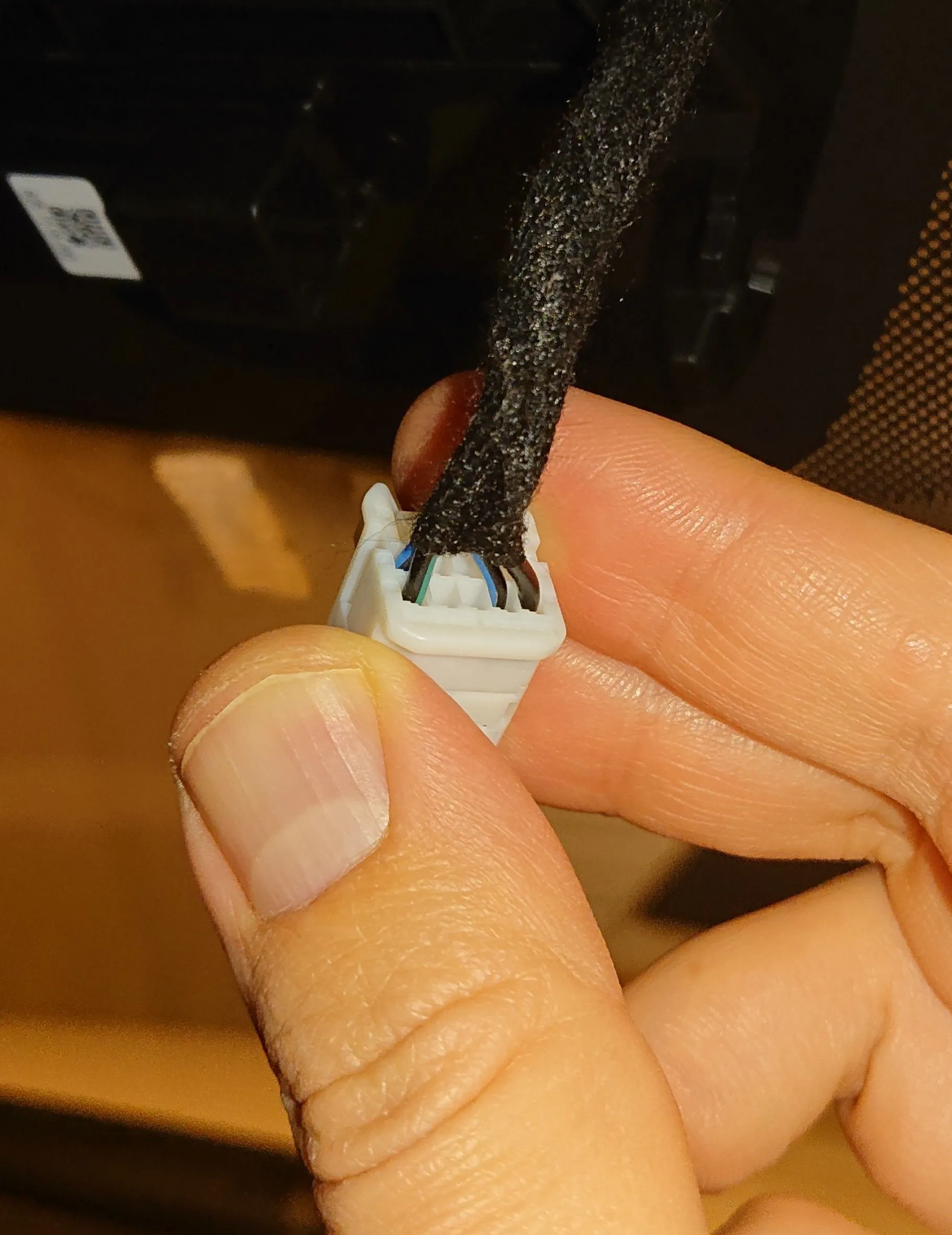

Finally got some time today to install dashcam. Did some work with the multimeter to figure out wiring on the frameless mirror. First had to identify which pin was ground by running a wire to ground nut under the hood and testing for continuity. Then once I had that, tested other pins for 24v with ignition on.
I used an invisicord to tap into the white plug. 10 pins but only 4 are used...ground is black wire on top left and switched hot is blue/black on bottom right.
See pics below.
Nice, thanks for posting an update with pictures petesamprs. Install looks very clean!
See pics below.

Hey thanks for the pictures. One question: did you find out which of the two other wires is for constant 12V?
