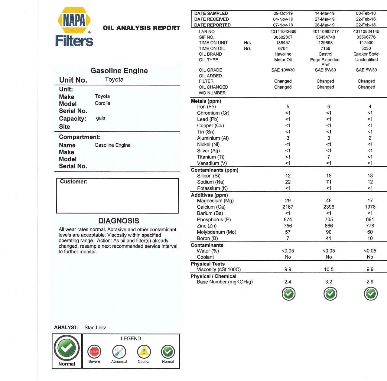

Is $20 the whole price or is there an extra fee when mail it in ? Was thinking of getting another test to compare to the Blackstone reports.
That is the total price. Its a little under $3 to mail on your dime the last time I sent one in. It comes with a TBN reading something you pay extra for at Blackstone. You can occasionally find them on Rock Auto like I did for $9.95 a kit! Below is what the Wix printout looks like.
Thanks. That's a great price plus let's me compare labs.

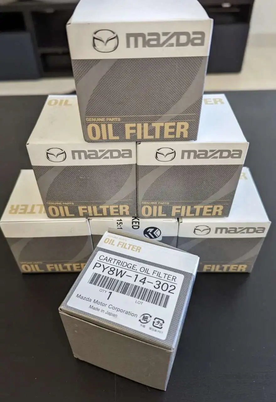

Thanks all for the Partsouq recommendation.
I’ve got 12 Tokyo Roki filters on the way for my ‘23 2.5T. It came to about $12.50 a filter with shipping.
I’ve got 12 Tokyo Roku filters on the way for my ‘23 2.5T. It came to about $12.50 a filter with shipping.
Let us know how soon you can receive your Tokyo Roki oil filters from partsouq.com in UAE. Honestly I’d just settle for Thai made OEM Denso oil filters on my 2.5L NA after my stock of Japanese Tokyo Roki oil filters (started with 23) are used up. 😉
Or I can add some Tokyo Roki oil filters on my order from partsouq.com when I need a new Oil Control Valve from them in the future.
Wow, this’s the most intensive comparison article between Japanese made Tokyo Roki oil filter and Thai made Denso oil filter! This make me feel like I want to get more Tokyo Roki PE01-14-302B oil filter for my 2016 CX-5 from partsouq.com in UAE after my stock of 23 Tokyo Roki PE01-14-302A’s collected few years ago have exhausted.
Yes, you still can get Japanese Tokyo Roki oil filters from partsouq.com in UAE (also on eBay), and you can get it within a week like you order the parts from US online sellers.
