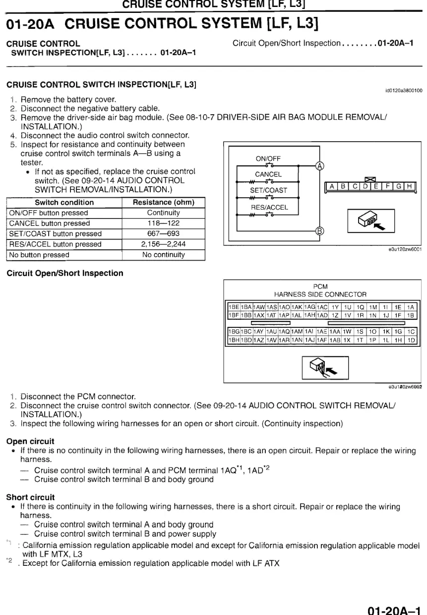

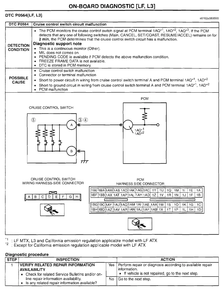

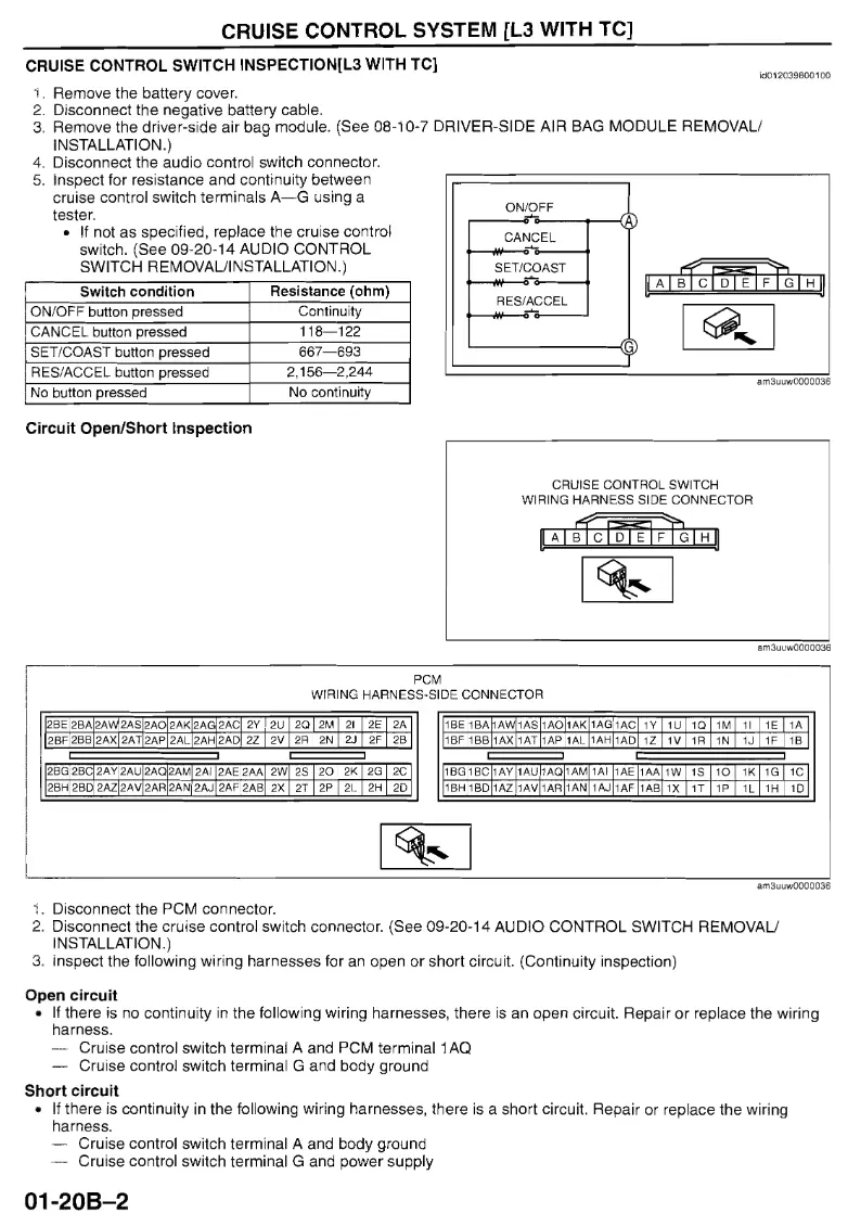

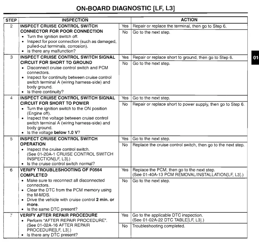

Here are a couple of sheets from the FSM I got off from ebay for the one cruise code I could find:
Your switch readings are spot on. So you need to verify wiring and the PCM it seems.
Also those diagrams are from an FSM for a 2007 but they should be the same for 2008.

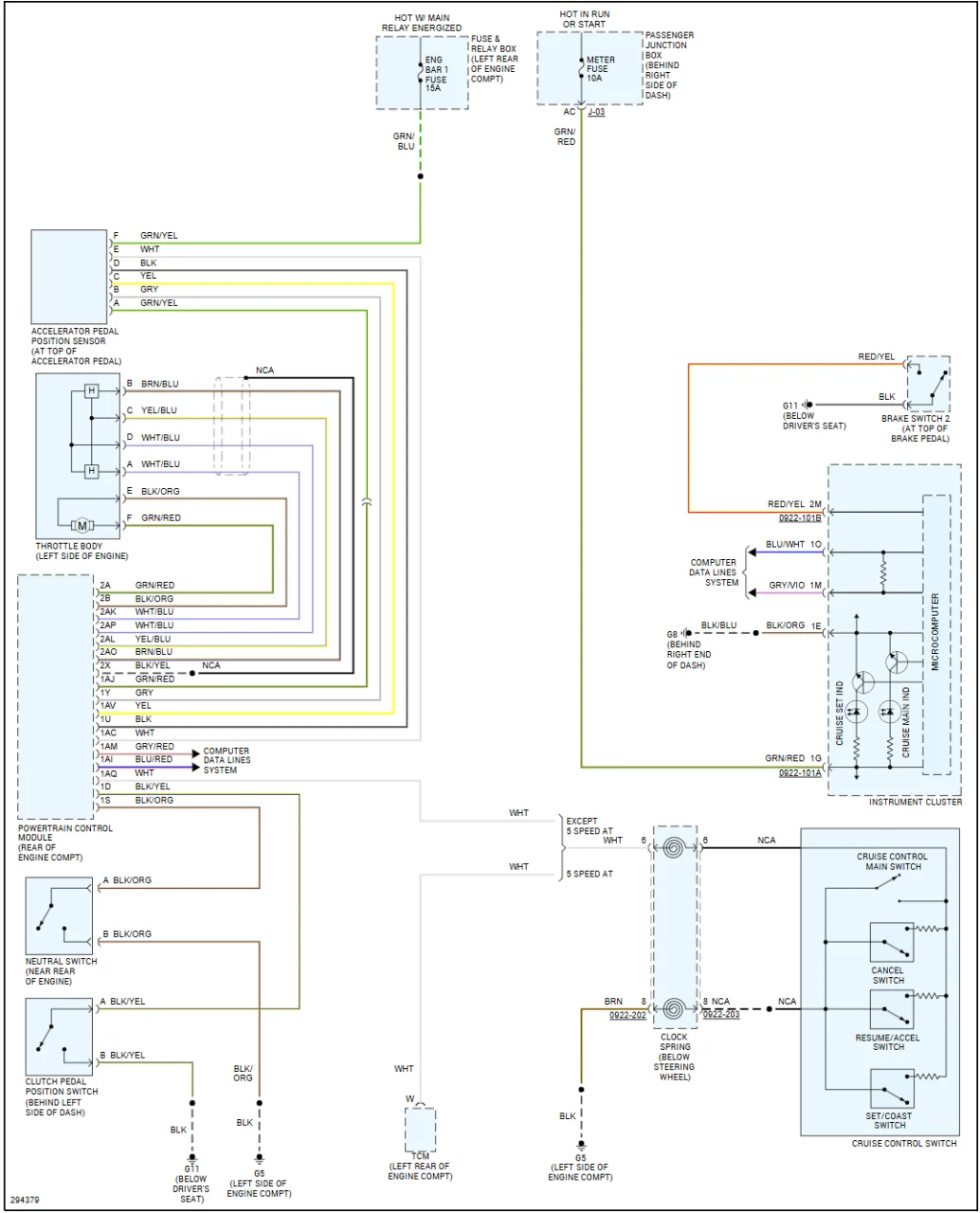

I finally got back to doing a bit more digging here. All the above diagrams seem to indicate a cruise control signal wire entering the PCM at terminal 1AQ on the PCM connectors. However, my PCM didn't have a wire at this location. I did some further digging around and found the attached diagram.
It seems to show that the cruise control wire on a 5 speed automatic transmission actually goes to the TCM instead of the PCM. From what I understand the 2.3L engine has an independent TCM module with the 2.0L engine has the TCM integrated into the PCM.

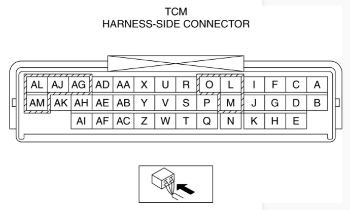

After digging around a while I found that the 'W' on the main diagram where it goes into the TCM is the terminal/pin on the TCM connector. I also found the attached pinout for a TCM connector. I could find no indicator of what year this pinout is for, but it seemed to match mine and I could find continuity from the cruise control signal line in the vehicle to the W pin on my connector...so seems legit enough.
After pulling out my battery and disconnecting the PCM I was able to get to the TCM. I pulled the connector off of the TCM and tested resistance from pin W there to the negative battery wire. Initially everything seemed good here with the expected resistances showing up as I pressed the cruise control buttons. However, I unlocked the steering column to move it out of my way a bit and found that as soon as I could move the steering column the resistance values that showed up suddenly starting jumping around a lot. The circuit is sensitive to steering column movement for some reason. This seems to indicate some kind off wiring fault...maybe a broken wire, some corrosion somewhere...who knows.

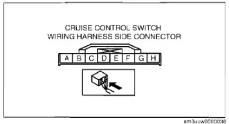

  • G is the correct pin as specified in the troubleshooting guides provided earlier in thread
  • I empirically verified pins A and G as the correct pins where I see button resistances at the cruise control connector harness prior to it being connected

  • The wiring diagram that's been accurate thus far clearly shows pin G running out to ground via the brown wire to ground G5

I see only these two DTC's with forscan:
CodeModuleMeaning
P0564-FFPCMCruise Control Multifunction Input “A” – signal missing/invalid
B1261-FFEATCSolar Radiation Sensor Circuit Fault (in the climate control system)
Clearly the B code is not relevent here, which leaves the P code. Since the PCM is complaining, I'm assuming that cruise control information is passed from the TCM to the PCM...probably via the CAN bus. I can't really inspect that, so I have no idea what's happening here.
