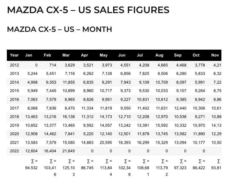

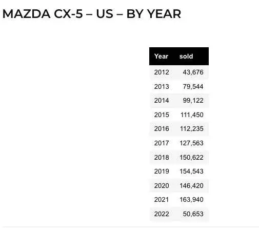

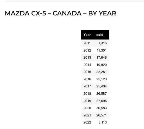

If you need to know future salvage part availability in Canada and US

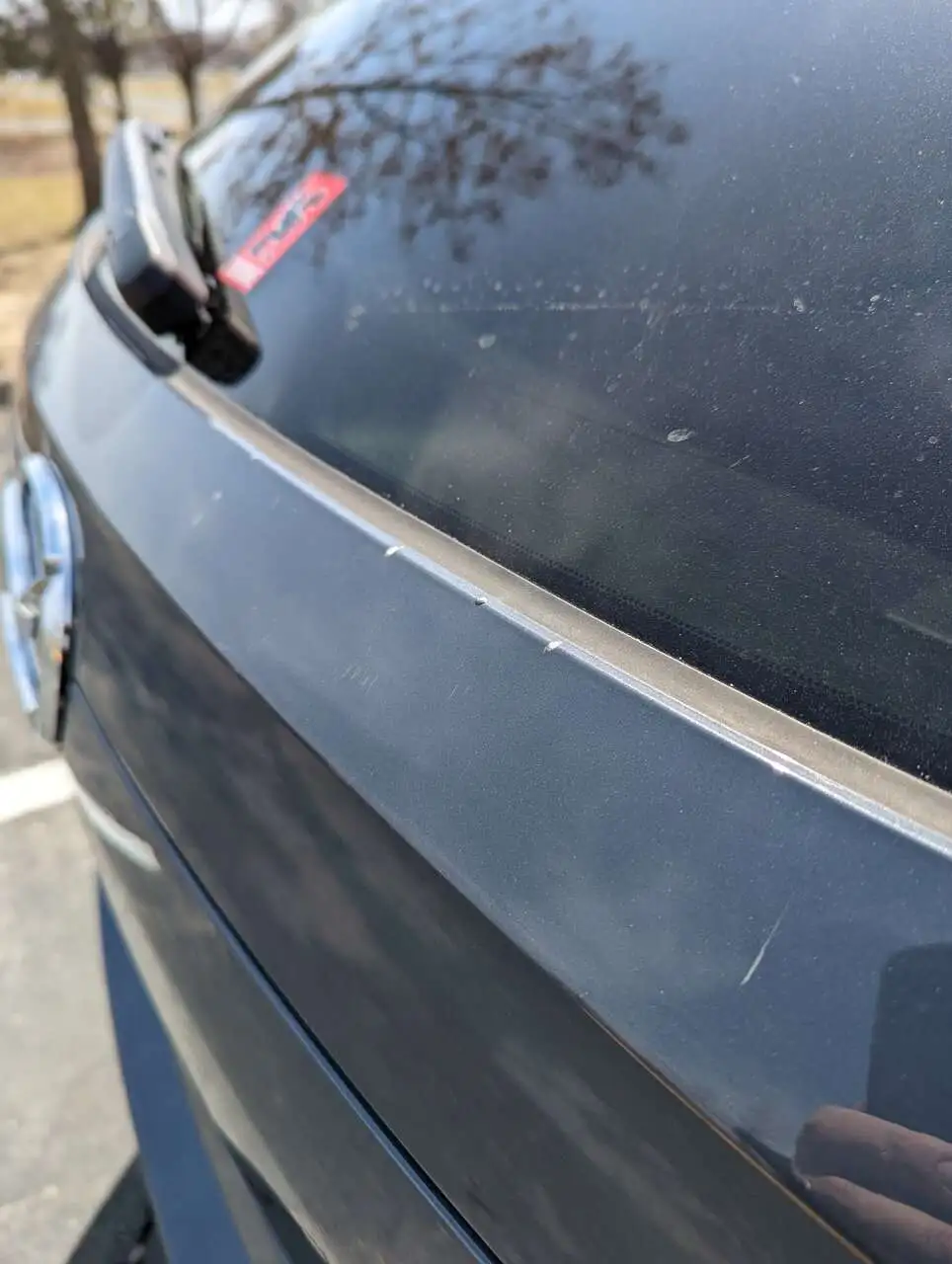

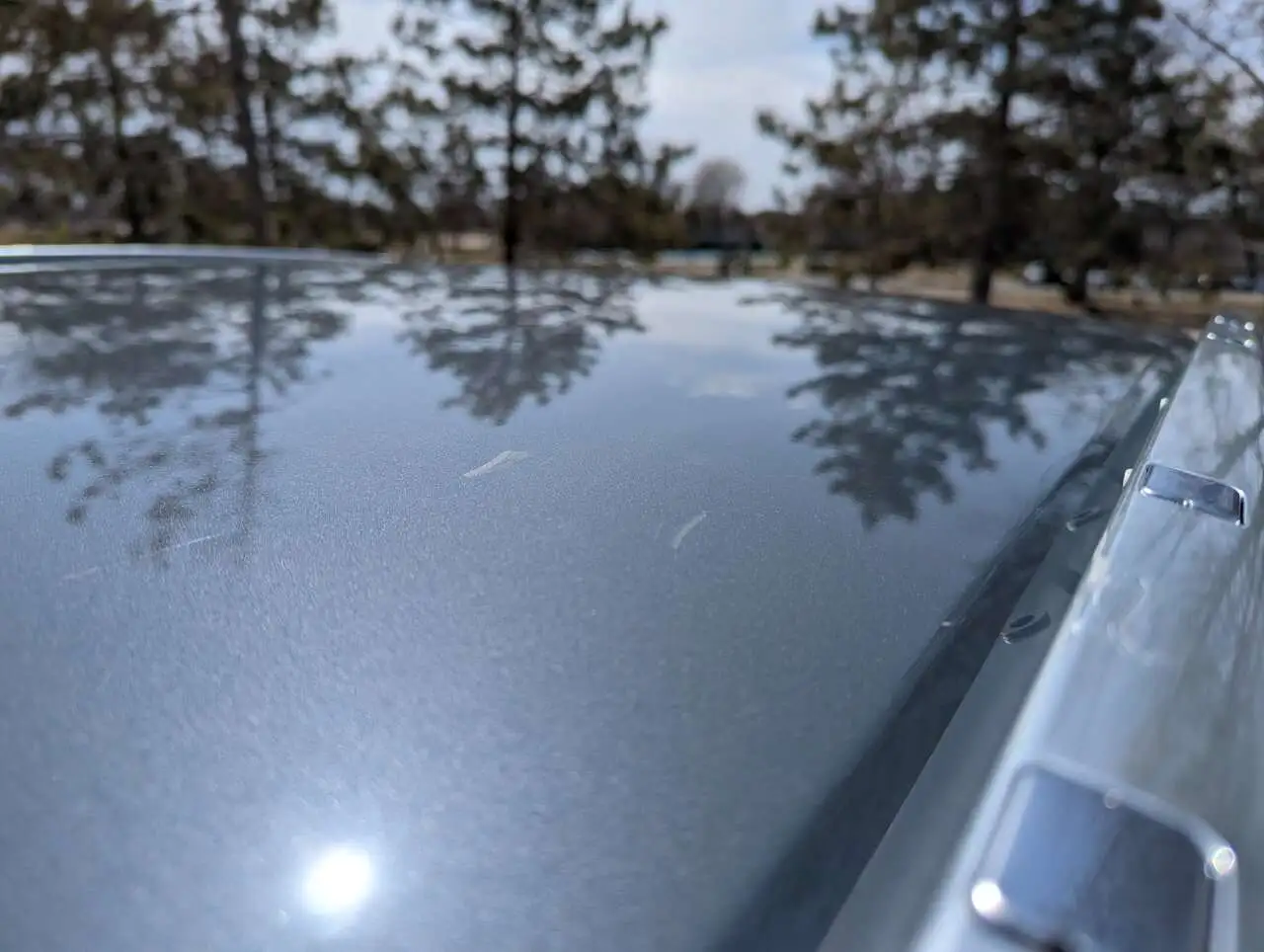

A few days after getting the car back and giving it a wash, I noticed a scuff on the front fender (minimal), rear hatch (plastic panel below window is scratched and actually gouged), roof rail and roof (dents and scratches through the paint... they set something on it).
Also a new rattling/clunking sound has appeared from the front suspension, almost sounds like a sway bar end link wasn't connected or connected properly.
It's like I brought in a 10k mile 'new' car, and got a 150k+ mile (very used) car back.
Scheduled an appt to bring the, still not-right, car in a WEEK later. Dealer is taking care of the issues. But now I am, again, without my car for (going on) 2 weeks.
