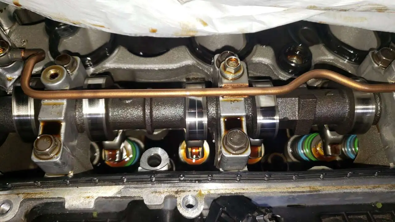

Last year I started noticing what I've now learned to be valve lifter ticking coming from the engine. It has been getting worse and it usually happens not on startup, but after 10 mins or so if the temps are 30F-55F. It doesn't seem to happen as often when it's consistently warm or very cold. I've been consistent with oil changes, always using Castrol GTX 0W-20, every 6k-7k miles, and recently I even used the Mazda brand oil w/ moly.
I just accepted a job out of state and want to get any major issues fixed before moving and so, I started trying to diagnose the issue. First I thought a VVT issue or the Oil Control Valve(OCV), as I've also noticed the car running rougher at around 1200 rpm under load. I changed the spark plugs in February at about 95k miles.
I removed the valve cover to my engine and checked the OCV and the tiny screen filter that feeds it. Both were clean, and I tested the OCV/ VVT solenoid for operation - all good. However, I noticed one of the cam lobes has a mark going right down the center (see pic below). This sounds about where the ticking has been coming from...

It seems the Hydraulic Lash Adjuster is likely defective and should be replaced, and is the culprit of the sound and also the mark on the camshaft lobe.
I plan to take my car in to get the HLA replaced, but do I need to replace my camshaft now too? I look at that mark and worry that now it's been damaged to the point that a new HLA won't resolve things completely.

After some research tonight, I too was surprised that the mark is on the inner lobe, but maybe it's just a weird anomaly. And and unwelcome one at that.
As far as the $$$, I'm debating leaving the engine apart and towing it to a trusted independent mechanic my family has used for years. Since I'll already have it halfway disassembled that should help with costs :).
Some recommendations I've seen are to replace all the HLAs as a precaution but I wonder how necessary that is.
Do you think the camshaft will still be fine since a new HLA will theoretically operate properly and not suffer from the decreased pressure that's befalling the current HLA?
According to what Mazda wrote in the TSBs, they identified a physical issue with the switchable HLAs and fixed the problem with a redesigned part. So based on that, I'd tend to lean towards replacing all of them if it's already partially torn down. But that's JMO, and you'll of course make your own decision on that.
The cam is a more difficult call, because it's hard to say (for me anyway) if the current damage will eventually snowball and become worse. You might want to try getting an opinion from engine rebuilders, or maybe older machine shop guys who probably have a good feel for something like that.
In any case, the immediate consideration for you is to make sure you can source all of the HLAs (and possibly a cam as well), because it's impossible to know what will be needed, until it's fully torn down. In this brave new world of massive parts unavailability, nothing is for sure these days until you're holding it in your hand.
Since you have a 2018 CX-5 which has cylinder deactivation, the HLA noise problem can be complicated. The original 2.5L with CD came out in 2018 from Mazda were suffered fallen rocker arm problem on cylinder 1 and 4 with cylinder deactivation feature. Mazda issued a recall and changed the oil pressure to these switchable HLAs with software updates. My feeling is the oil pressure change could affect the original design functions on these switchable HLAs, and cause undesired HLA noise which may need the revised version of HLAs to run them smoothly. I’d get ALL original HLAs replaced if I plan to get new HLAs for noise problem, and make sure your CX-5 has the updated PCM software from the recall.
The wear mark on that particular cam lobe shouldn’t affect the new HLA as it touches only the rocket arm, not the HLA.

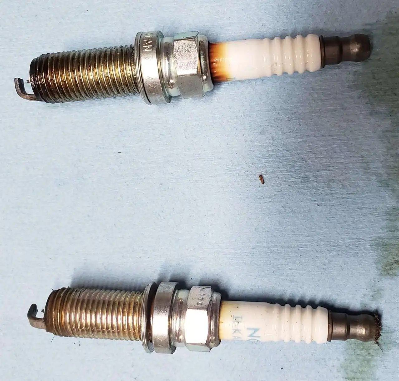

The spark plugs were replaced for the first time this March so it concerns me that only Cyl 4 seems to be having issues compared with the others. Bad ignition coil?
My indie mechanic thought carbon buildup or there's not a proper seal being formed during compression.
It seems like all my current issues (automotive ones), are localized to Cylinder 4.

The compression test was strange; all cylinders except cylinder #4 checked out. Cylinder #4 had HIGH pressure compared to the other cylinders. Compression pressure for cyls 1-3 was about 200 psi, but cyl 4 was at 260 psi. What to make of this? This was also the cylinder that had the dirtiest intake valves with lots of carbon build up and the wettish looking spark plug. Oil entering cylinder 4 somehow? Could it be a gasket or piston ring issue? Or oil vapor entering from the intake? Can this engine control airflow to individual cylinders? I'm just confused as to why it would only be one of the cylinders experiencing greater oil exposure.
Must be something in the cylinder - heavy carbon build up would be my guess, but your mechanic could scope the cylinder to find out exactly what and how bad it is. Not that it matters much though, because it will need to get cleaned out in any case, assuming that your goal is to keep this vehicle long-term.
