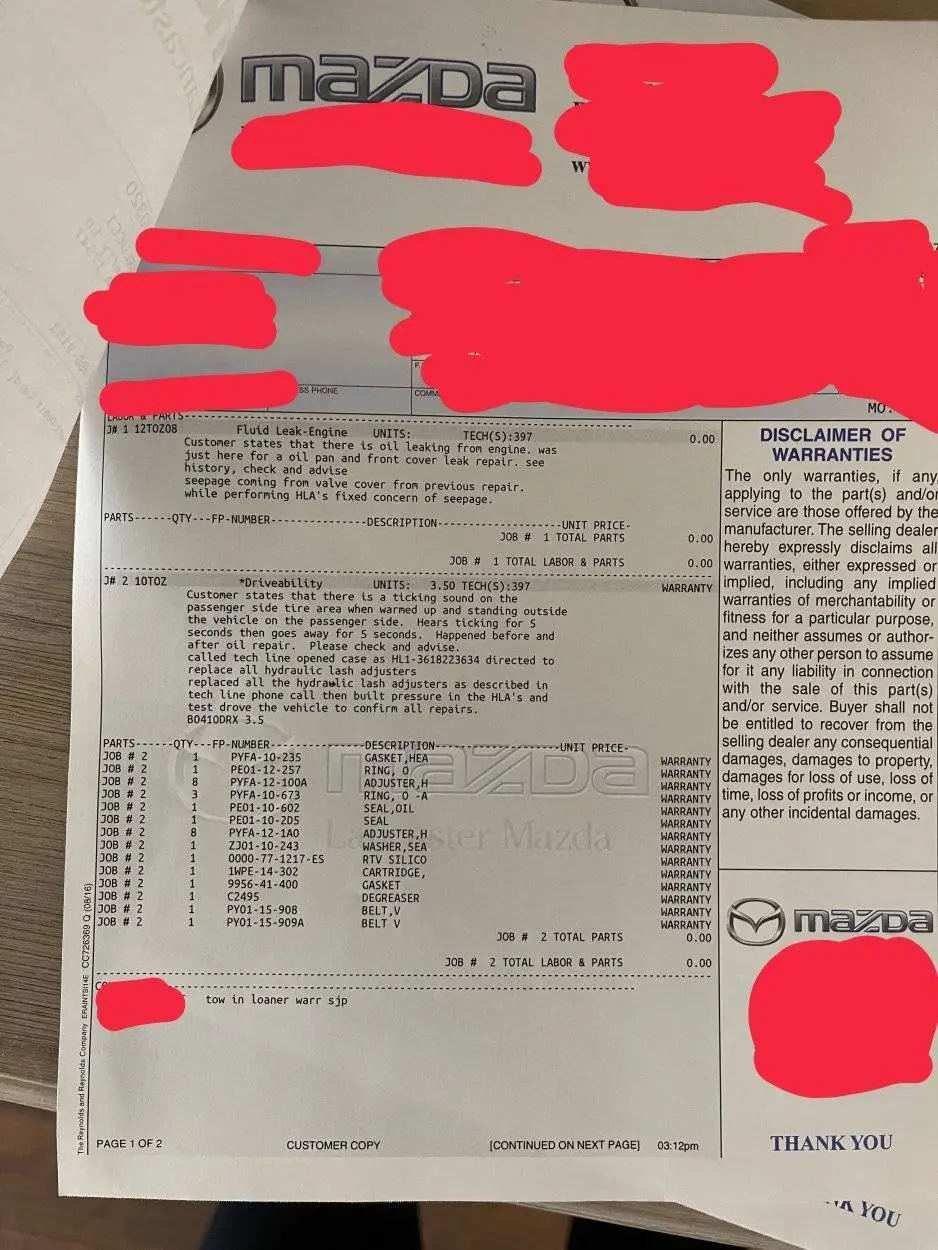

I went looking for the paperwork this morning. Couldn't find it but I know we have it somewhere. As soon as I can get it, I'll post it here. Thanks for the tip!
I'm not understanding what they told you at all, and can't imagine what correlation Mazda made between a leaking VC gasket and the need to replace the HLAs. Replacing the HLAs is a significant job, and I wouldn't expect them to authorize payment of it unless there was a good reason for doing so (usually based on lots of top end noise).
It might be helpful to see your paperwork from Mazda, so if possible, please take pictures and post them on this thread (with your personal information blacked out of course).
Here you are.
Thanks for posting that, and it clears up the mystery (to me). According to what they wrote, you had mentioned ticking noise and, based on that noise, they decided to replace the HLAs. And that was listed on the sheet as a separate problem, completely unrelated to the timing cover leak. So all of that makes complete sense to me now.
Now getting back to your original problem statement; given that your vehicle is still under warranty, as others have previously mentioned, you have no choice other than taking it back to your service department, and trying to convince them of what you posted here. Your argument will be that the loaner you drove had more power and did not have the issues that you believe your vehicle currently has. Request that a tech take a ride with you, and then you can point out to him/her exactly what you think is abnormal. Hopefully they will be willing to do that, and will agree with you about what you think is a problem.
On the other page(s) of that paperwork, do you see any line item that looks like number of hours for labor? It's just an insignificant thing, but I'm always interested in what the automakers consider to be the appropriate amount of time for a tech to do a job.
One thing I'd ask for when you take it back is for them to do a compression test.
The fact that yours feels less powerful and has to downshift going up a slight incline tells me you might have one cylinder with low compression.
It's been known to happen.
Here you are.

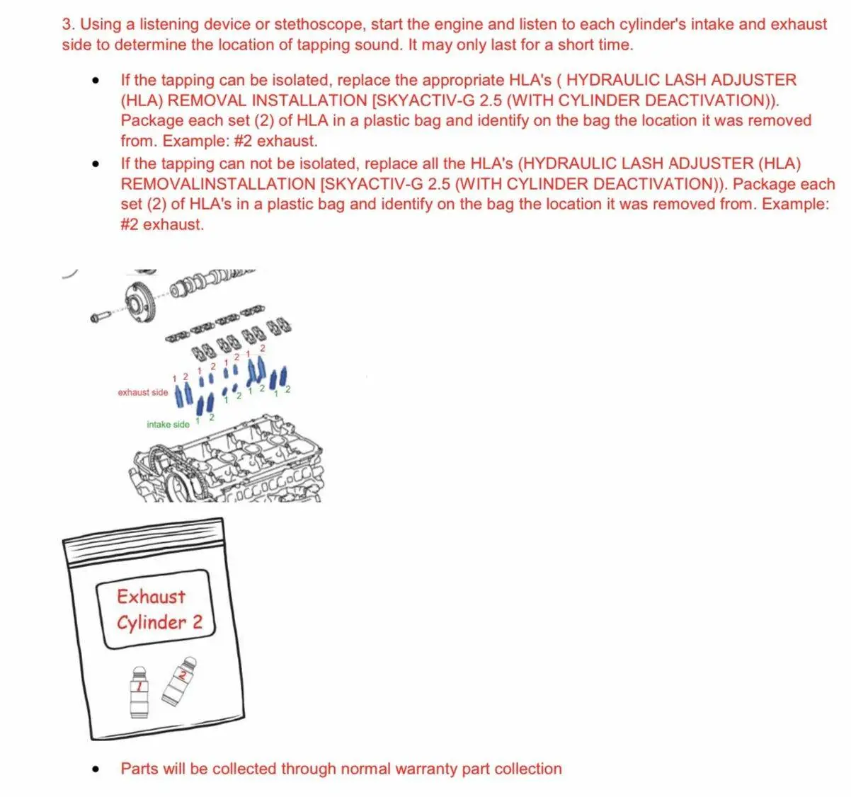

So it’s ticking noise complaint which made the Mazda tech line replaced all hydraulic lash adjusters (HLAs). There’s a Service Alert for this valve ticking noise. Based on the part numbers listed on the invoice, they’re:
8 X PYFA-12-100A ADJUSTER, H
Valve Lifters - Mazda (PYFA-12-100A) Replaces: PYFA-12-100
Other Names: Engine Camshaft Follower, Adjuster Hydraulic Lash
Description: CX-3. Mazda6. CX-5. Mazda3. CX-30. Without turbo. Without cyl deactivation.
8 X PYFA-12-1A0 ADJUSTER, H
Engine Camshaft Follower - Mazda (PYFA-12-1A0)
Replaces: PYFA-12-1A0A
Other Names: Adjuster Hydraulic Lash S
Description: Intake. Cylinder Deactivation.
The “Engine Camshaft Follower” name for part no. PYFA-12-1A0 is confusing. But it does say “Adjuster Hydraulic Lash” in Other Names. This more complicated (and more expensive) HLA or hydraulic valve lifter is the switchable HLA designed for cylinder #1 and #4 for cylinder deactivation where the valve lifting function can be deactivated.
Service Alert No.: SA-012/19 Last Issued: 11/22/2019 - VALVE TAPPING OR KNOCKING NOISE HEARD FROM CYLINDER HEAD

I'll tell them.
Unfortunately, it's all 0's.
