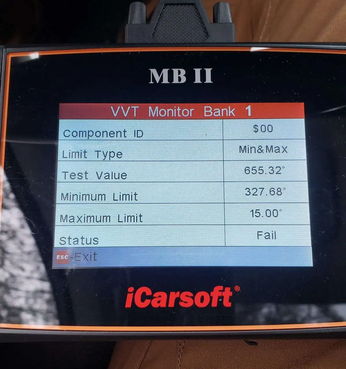

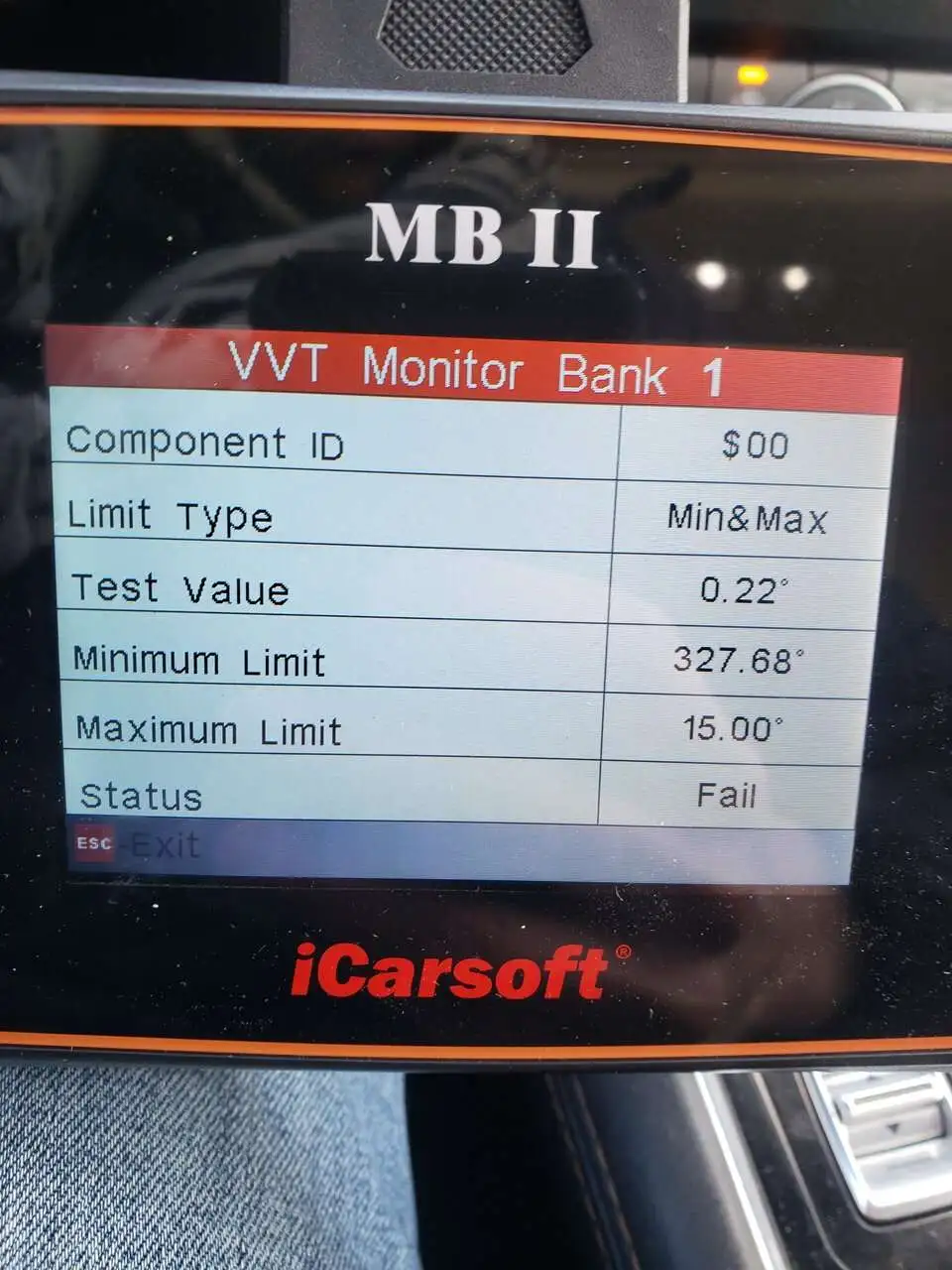

What you say about the defective lifters changing the effective valve timing makes me think it also explains these values I got when plugging in my diagnostic tool the other week...
At first, I wasn't sure exactly how to interpret this. I first thought it meant the camshaft was somehow rotated an extra 270 deg out of phase or something, but that obviously wouldn't make sense since for that many degrees of rotation the pistons and valves would've collided. Based on your explanation, could the defective valve lifter cause the Test Value to be that far out of spec?
Also, what exactly is this VVT Monitor Bank 1 test measuring? When I saw degrees I immediately thought rotation, but I'm not sure exactly how it applies in this context.
The PCM would have no way of measuring or inferring the position of individual valves; i.e detecting if a lifter failed. It only knows the position of the cams in relation to the crank. As for the scan tool snapshot, not sure how to interpret 655.32 degrees. Might be bogus data (not unusual with vehicle specific PID's using a non-OEM scan tool).
2. From my own valve cleaning experience, cyl 4 and to some degree #3 have more valve carbon buildup than #1 or #2. Likely the oil mist flow in the intake manifold runners is heavier for those cyl. Also possible valves on that end of the head run slightly different temp than 1 and 2 (location of radiator hose takeoff on the block). In any case, I doubt relevant to your lifter issue.
Unless I'm somehow misinterpreting what you wrote, you're dismissing the lifter issue as contributing to the higher compression in #4, and attributing it to the design and operating characteristics of the engine. But that would mean that most/many of these engines with around 110K miles would also have #4 reading 20%+ higher compression than the other cylinders. Is that really what you believe?
The bogus data is very possible. The tool is technically for mercedes-benz, but it was all I had. I do often have trouble with it maintaining connection when trying to view live data as well. What's more, a few weeks later I ran the diagnostic again. With the car ignition on, but engine NOT running and got this...
After turning on the engine this Test Value stayed the same as when the engine was not running. I also disconnected and reconnected the tool, in case it was just continuing to display the value measured before the engine was running, and it still showed this value of 0.22 deg. This really threw me for a loop as it now seemed like whatever was rotated out of spec was now 14 deg within being in spec. Later, it returned to showing a Test Value of 655.32 deg again.
Of course, as you said, could be bogus data since it's a non-oem scanner tool.
