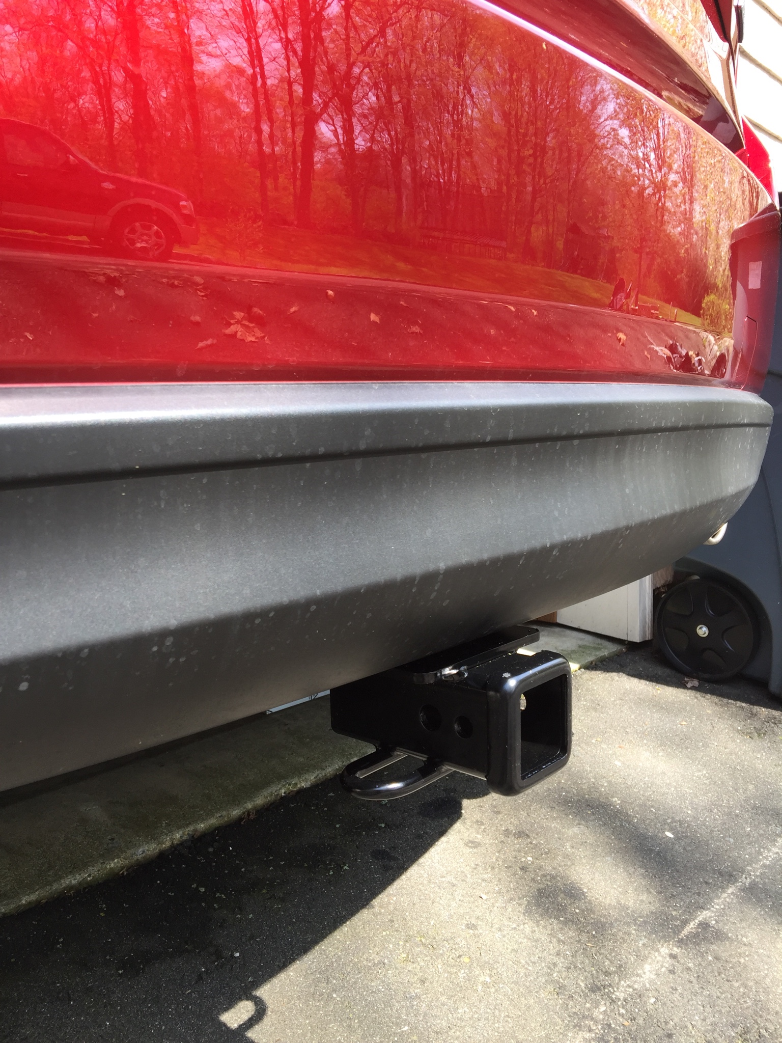

Well, I installed the hitch receiver at the weekend.
It was pretty straight forward as I watched the videos for installing the hitch on the etrailer website for the pre-2017 model year. A video wasn't available on the website for the 2017 MY but the install was very similar.
The only difference was that the 2017 has a small piece of trim under the bumper that needs to be removed to install the hitch.
I installed it by myself which wasn't too difficult. I propped up one end with my knees as I maneuvered the near end with my hands. Once you get one bolt partially tightened it supports itself. It certainly would have been easier with someone assisting.
The rear most bolts were difficult to torque up due to the shape of the hitch. The instructions mentioned a universal joint to help get the job done. I didn't have one in a ". I grabbed a smaller wrench and was able to get it done without the joint, though it was more fiddly.
Thanks to everyone who provided input.

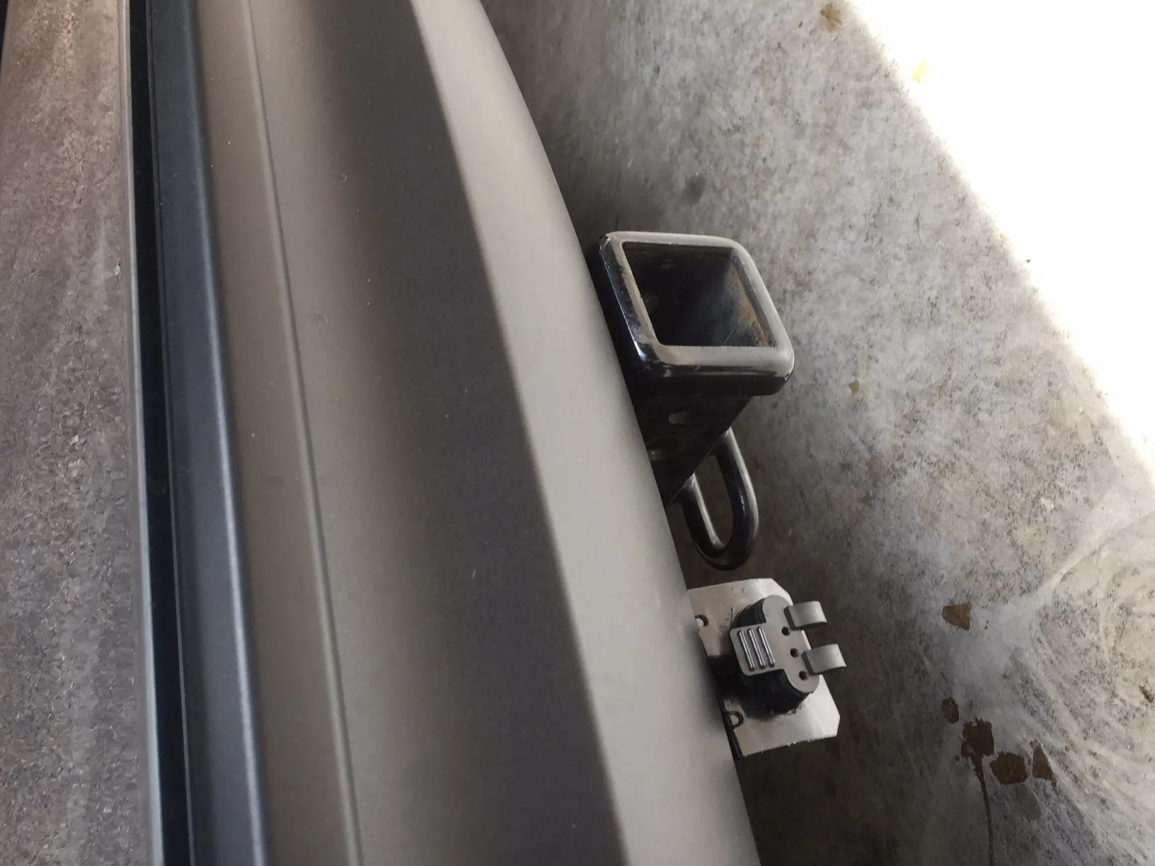

Awesome! Glad it worked out. I left that piece of trim you were talking about, but thought about removing it too. My hitch pressed hard up against it but managed to fit. I attached the bracket for my wiring harness to it, but you could also just attache it to the bottom of the bumper if you ever need to.

Congrats on install!!! Even if you don't tow having a hitch really ups the utility factory. I use mine more with rear cargo carrier than trailer towing but still do the latter with my small boat at times.

Thanks for the info. I'm not sure if my hitch would have gone on with that piece of trim in place but it's certainly not possible to reinstall it with the hitch in place.
Maybe I'll loosen the hitch a little and see if I can wiggle the trim back in place.
In any event it's a pretty small, apparently inconsequential piece so I'll sleep easy either way.
Thanks again for the help.
