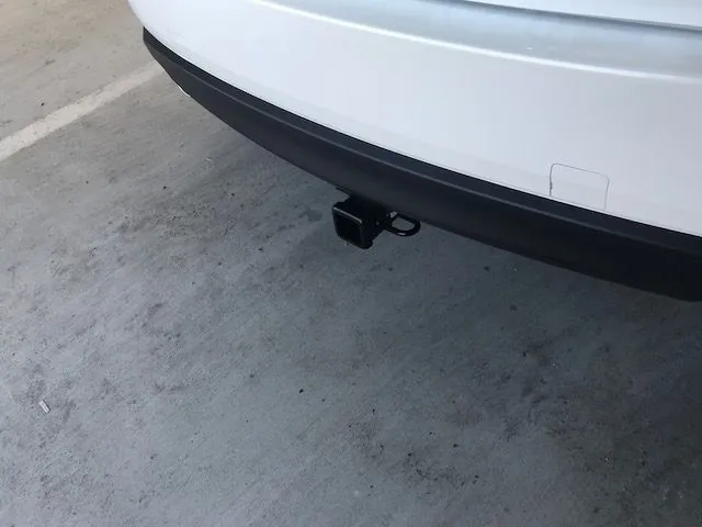

Installed mine yesterday. Took about 30 mins, mainly due to removing the exhaust donuts incorrectly. Here are my notes as they apply to my hitch from etrailer. Your results may vary.
1) spray some penetrant on the 4 exhaust donuts and they come off really easily.
2). Remove the donuts from the exhaust such that the donuts are left on the car. With the hitch I had purchased for etrailer, the other way around wouldmake it such that you would not be able to get it back on.
3). The hitch fit tight left to right. Having two people was really helpful here.
4). My hitch came with some great wires to feed the bolts through. Very cool.
5) I didn't need a universal joint but had it handy.
6) upon reassembly, the last exhaust donut was a main to get on. I used a screwdriver to pry and it then went right on.
