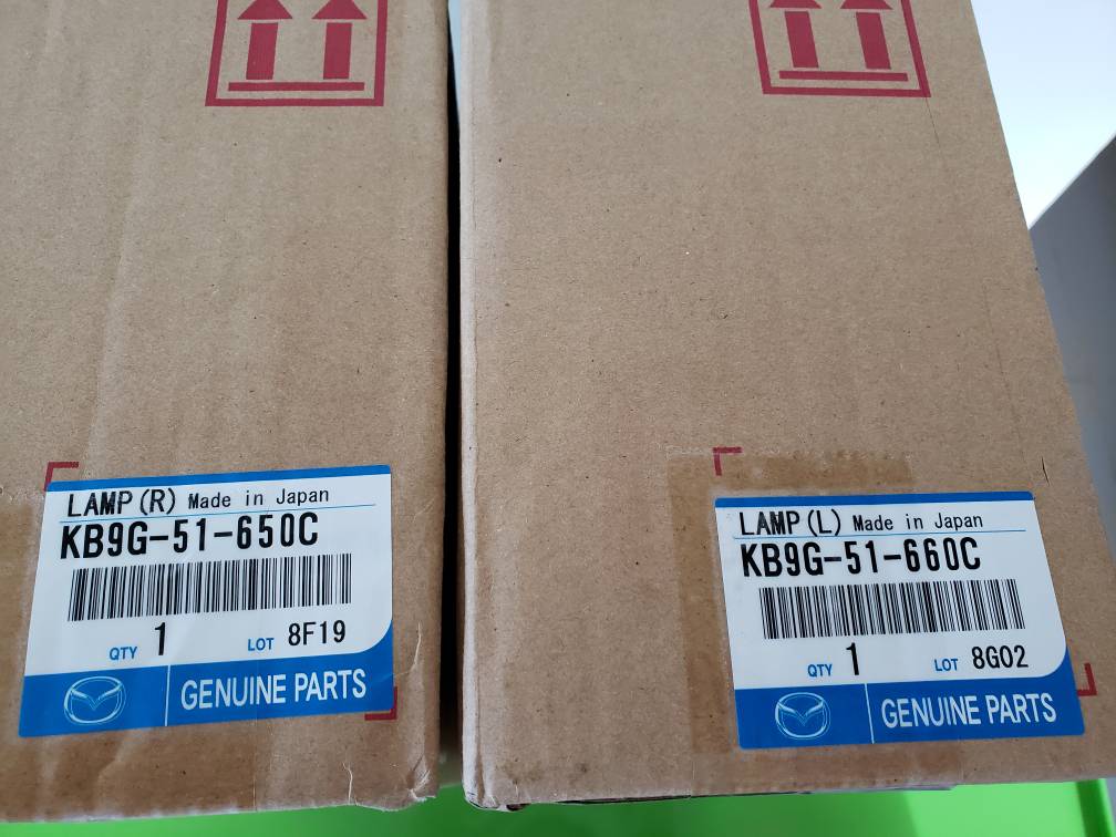

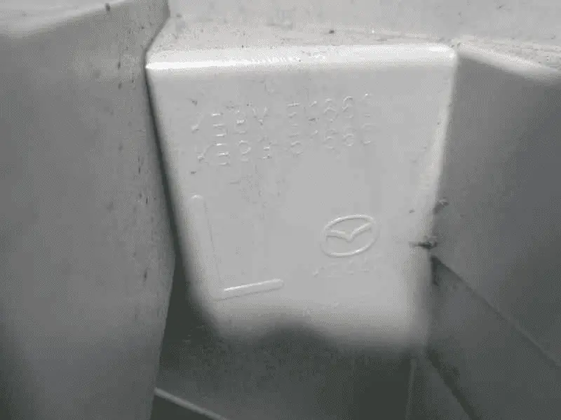

The RH light assembly is KB9G-51-650C
The LH light assembly is KB8M-51-660C
These are 77.51 ea plus tax. There are about 1.4 USD to the UK pound.
There are two short wiring adapters that act as patch leads between the lights and the main harness (if yours is the same). The part number is D4Y5-67-SH3. These are quite cheap at about 5 ea plus tax.

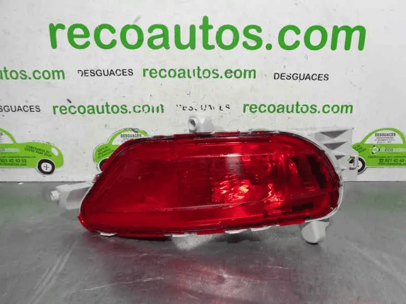

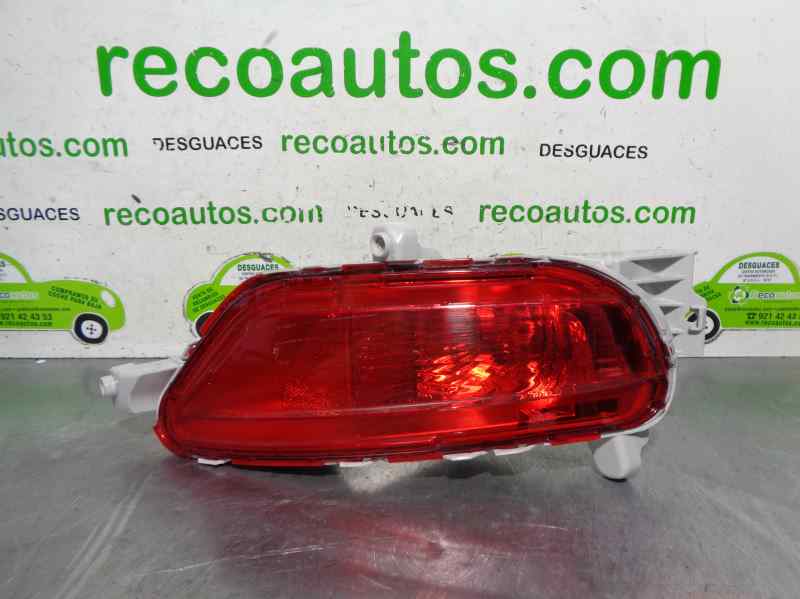

Quick google search and I found this for the RH light assembly

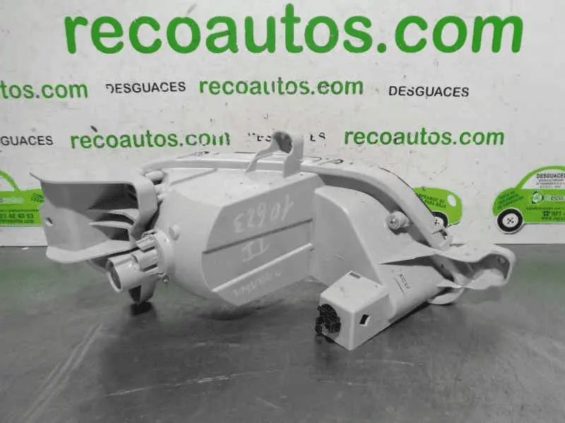

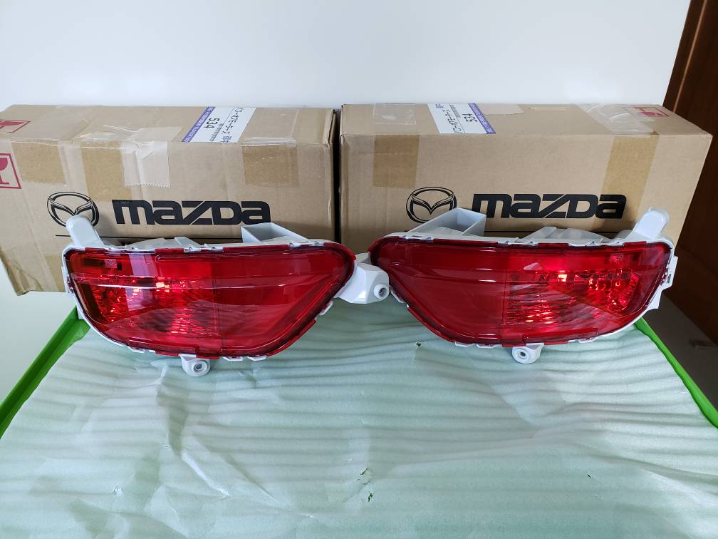

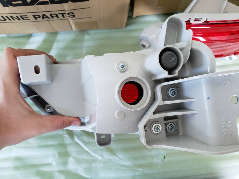

I was able to order both fogs to motor head japan and here's what i got. In this case the left fog did not had the bulb hole from factory, but it did came with the internal reflector, so i made my own hole to it and ordered the appropriate mazda socket and pigtails to connect it to the main harness and look oem.
I will upload again a pic when its installed and running.

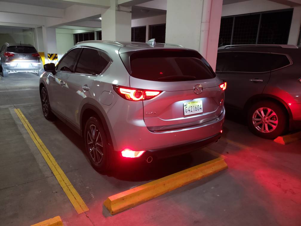

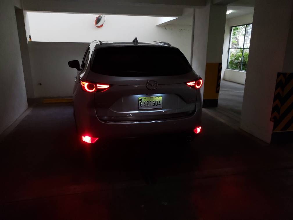

As promised, quick install, just tapped into the running lights and done... it gives the rear more character in my opinion. I ordered the oem cords as suggested and another socket for the fog that did not have it from factory.
Where did you order them and how much did it set you back?

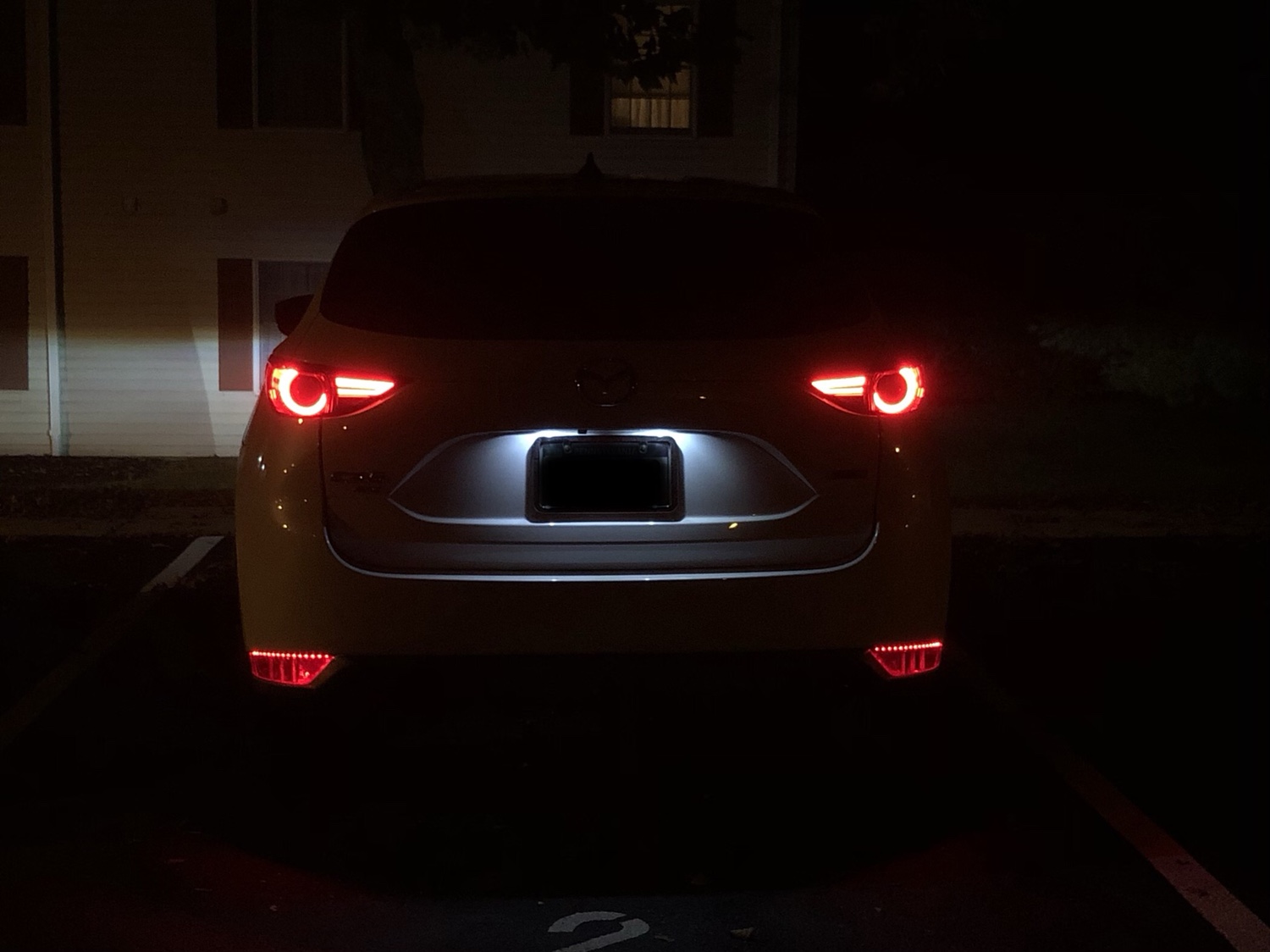

I just did something similar by adding two led light strips to each fog light. One is in with parking lights and the other is connected to brake light.

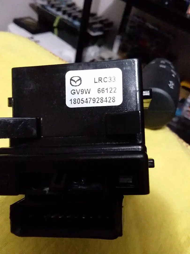

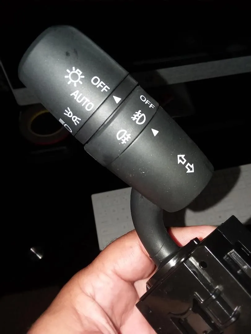

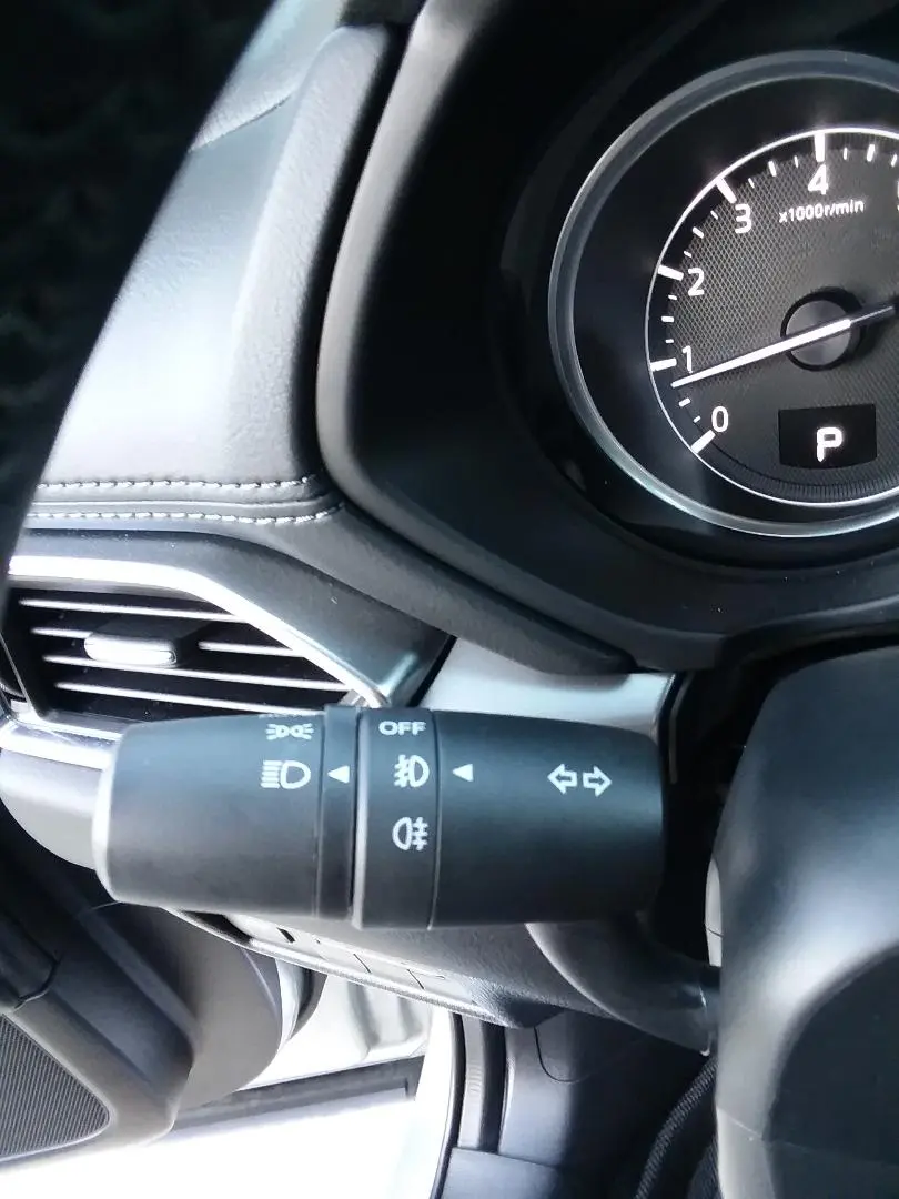

Just got my fog kit, here's the switch for the rear fog's also. It's the symbol below fog and it's spring return... meaning it doesn't switch on and lock

Did you get your kit and switch from Japan? Since Japan has right-hand-drive vehicles, legally the single rear fog light is on the driver side, the right side. But in the US we should use left side as the single rear fog light to meet international standard. Those Japanese rear fog light kit is not suitable for the US unless you modify it making a hole on the right side of the light housing.
Theres a reason why we need front and rear fog light indicators in the instrument cluster. Without them you cant tell whether or not your rear fog light is on as the switch pointer cant be stayed at the rear fog light mark. Mazda removed these fog light indicators for US CX-5 and its almost impossible to add these indicators.
How much the wiring you have to add especially to the new switch, and how difficult to replace the headlight switch?
And thanks for posting these pictures!
Yes it's a japan kit and I'm waiting on the rear wiring. The switch is easy replacement. The wiring for the rear is tricky. P.S.... the lights can be found on Ali-Express under CX5 rear lighting
