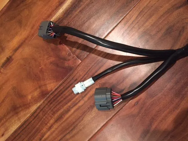

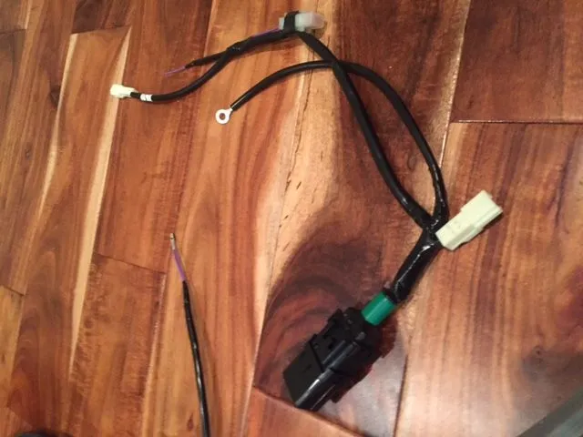

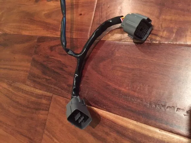

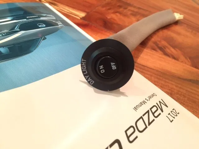

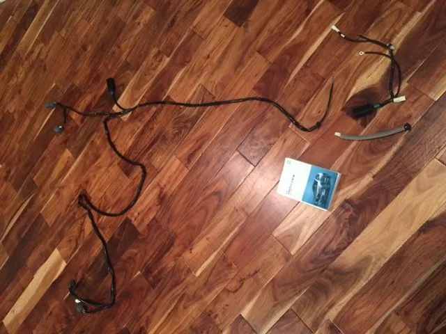

I'll let you know how it turns out but I don't have time to get started until Saturday. Install does not look easy and I'm not even sure what is going to happen or if the connections will match up on a US spec car. Pretty sure the front end is going to have to come off because the harness clips in and runs across just in front of the lower radiator. Also looks like it ties in to the driver's side fog for some reason? This could be way more trouble than it is worth.
Didn't the brief description say it was separate connection?
See pics.
attachment.php
attachment.php
attachment.php
attachment.php
attachment.php
