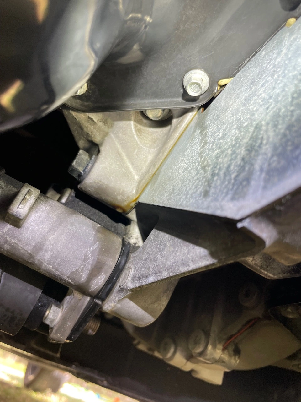

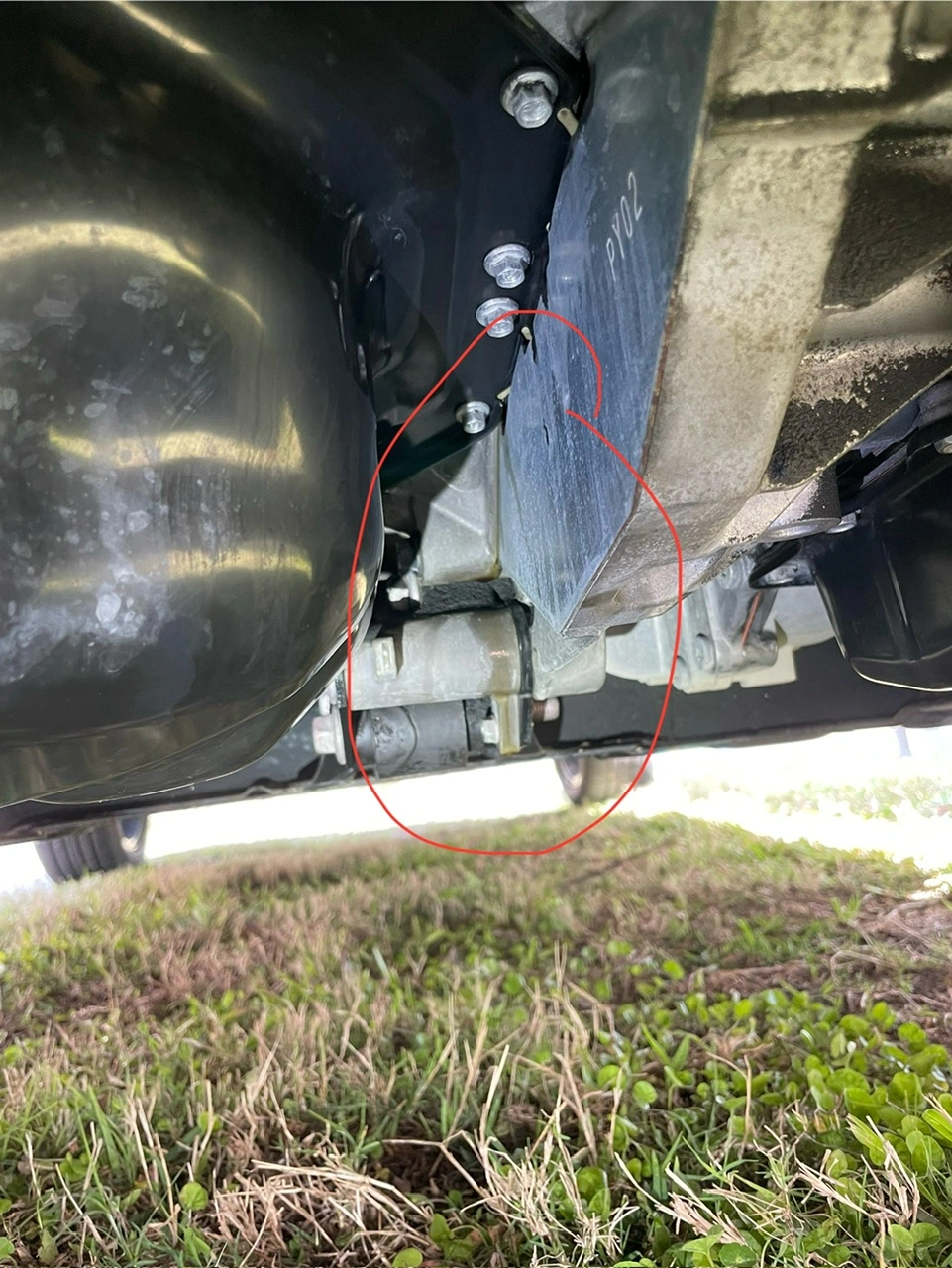

I’ve got a pretty decent oil leak on my wife’s 2016 cx-5 (about 140,000 miles). I noticed on the last couple oil changes a decent amount of oil and sand buildup in the plastic cover. Called a mechanic we’ve used for years and he just said to watch it and top up the oil if needed. I’m not okay with that. It seems to be near the oil pan, as that’s where the bulk of the oil was.
Everything above the oil pan that I can see is clean and dry. Changed the oil today and cleaned everything up really well to try and find the source. After running for about 10 minutes I noticed a drop hanging and where it appears to be running down from. Hard to tell what the source is, but I’ve attached a couple pictures and a video where you can see it actively running.

Has the oil pan ever been removed? It looks like it’s leaking out form the silicone (RTV) gasket between the block and the pan.
Being that it’s 9 years old, might not be a bad idea to have the pan removed, the mating surfaces cleaned up, and then resealed.

It hasn’t been removed before, it’s been a very reliable vehicle and we’ve had zero issues before this. That’s the best I can tell the source is coming from also. I looked thoroughly all over the engine with a mirror and nowhere else is wet with oil except that one area. I checked the torque on the pan bolts and a couple were about 1/4 turn loose. Torquing didn’t stop the leak though.
The pan looks like it can be rather easily removed. Am I overlooking something or is it simply able to drop straight down?
