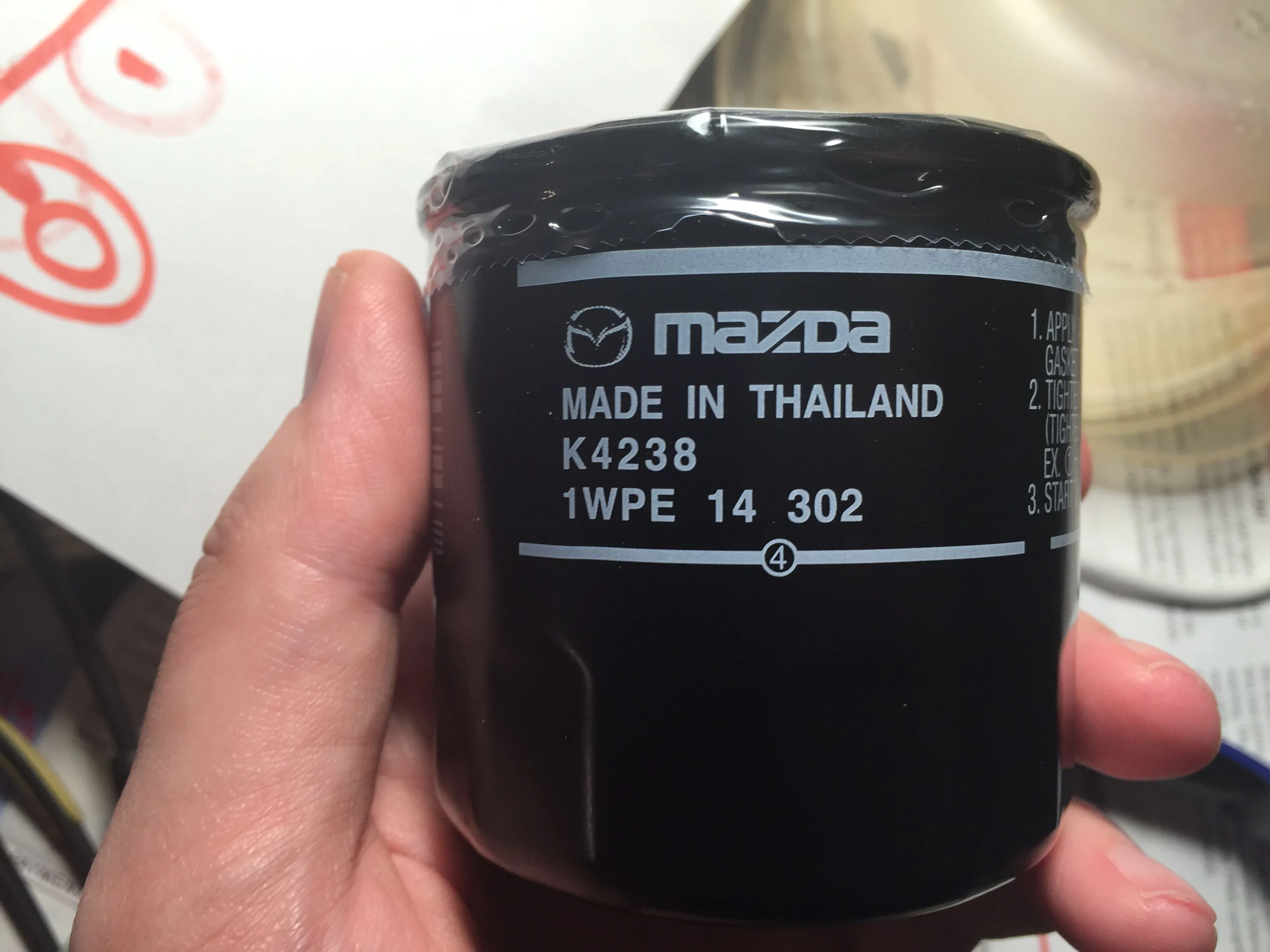

Just ordered OEM oil change kit from Med Center Mazda? Can you verify the OEM filters you got are Japan made PE01-14-302A or Thailand made 1WPE-14-302?

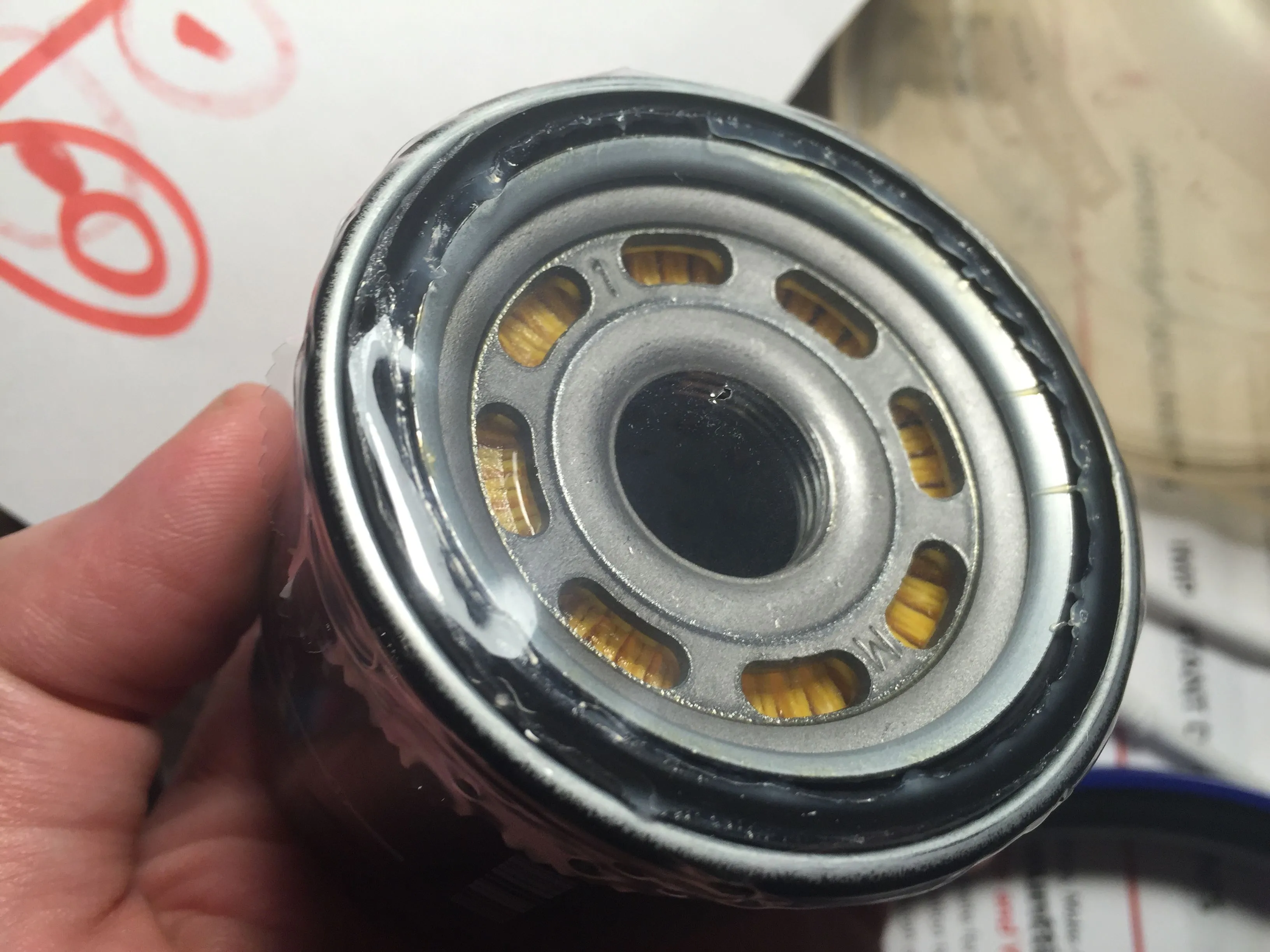

Here's another question: the filters I got from Med Center have some shrink-wrap plastic around the filter opening, and when I pulled it off there seemed to be some sort of goopy lube substance around the edge of the filter and on the o-ring. Are these filters already pre-lubed? I went ahead and wiped a little oil on the o-ring with my finger, but I'm not sure if it was really necessary.
Never in my life have I seen a pre-lubed filter, not even when I used to get OEM Honda filters for my car, back about 15 years ago.
Interesting... the filters I have gotten from Med Center all had dry seals as I would expect. No idea why they were seemingly pre-lubed on yours. Artifact from manufacturing? I typically dabble on too much oil anyway and have to clean up after putting filter on.
I have never seen a 'pre lubed' filter so can't really give any comment. A quick spin with an oiled finger is good insurance anyway.

⋯ Here's another question: the filters I got from Med Center have some shrink-wrap plastic around the filter opening, and when I pulled it off there seemed to be some sort of goopy lube substance around the edge of the filter and on the o-ring. Are these filters already pre-lubed? I went ahead and wiped a little oil on the o-ring with my finger, but I'm not sure if it was really necessary.
From what you described on OEM oil filters you got from Med Center Mazda, I can tell you have 1WPE-14-302 from Thailand instead of PE01-14-302A from Japan. This Thai OEM oil filter does have some sort of grease lubricant on the rubber O-ring and it's protected by heat-shrink wrap but the rubber O-ring is dry on Japanese OEM oil filter although it's also protected by heat-shrink wrap. Actually I just bought all Japanese made PE01-14-302A oil filters in their stock on the other day and Med Center Mazda now has no more Japanese made OEM oil filters. :)

Yeah they're Taiwan-made filters. Of course the one I removed was a Japan-made filter. Does it really matter? I remember years ago I would go to the local Honda dealer to pick up a Honda filter, and I would always tell them I wanted a "Made in USA" filter by Filtech, as opposed to the Made in Canada filters for Honda, made by Fram. Blech.
Maybe it's the Taiwanese filters that have this lube stuff on the seal already?
