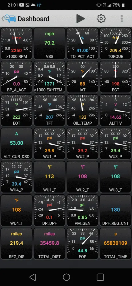

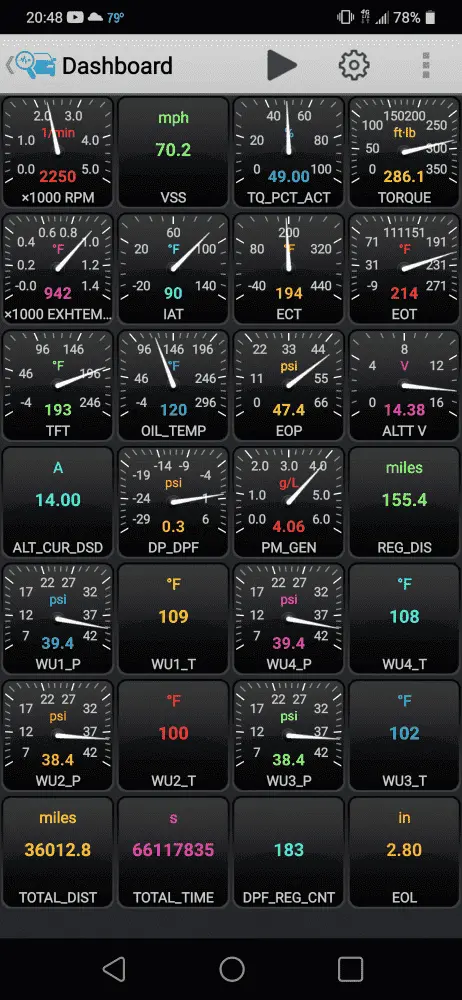

Some OBDIi readers or scanners don’t display Mazda’s ATF temperature. Some display “fake” Mazda’s ATF temperature by using coolant temperature value.

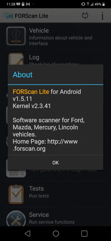

Of course many use (free?) FORScan Lite to get ATF temperature readout.
2019 CX-5 Diesel Aftermarket Transmission Cooler
Just downloaded it off Google play store ...
FORScan Lite for Android
v1.5.11
Kernel v2.3.41
The Bluetooth plug-in obdii port link is one of the recommended units from ForScan website ...
https://www.amazon.com (commissions earned)
I also purchased the vLinker USB cable to run it from a Windows based laptop in the future (but you can break stuff with that!)
