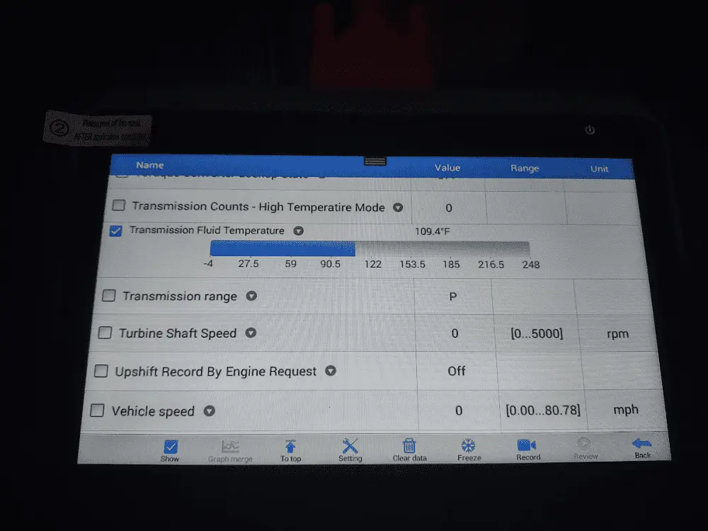

There's your answer, right there! The MK808 absolutely reads trans temps!

Btw how long did it take to read 122 deg? Also whats your location and time of reading?
The car was key on engine off when I did the reading, and it hadn't been cranked for about an hour and a half. I didn't monitor it to see how long it took to hit 122, I just was checking to see if the PID was able to be read.
If you're considering the idea of deriving tranny fluid temp by using the observations of others (or by any other 'estimation' method for that matter), I urge you to not do that. You need to be aware that TFT is very much affected by ambient temp and length of vehicle down time.
So the length of time for the fluid to reach the target temp can differ quite a bit, depending on the two variables above. And that's true even when just comparing multiple warm-ups of your own vehicle, if ambient temp and/or down time is quite a bit different each time.
So if you want to do this job right, and not potentially damage your transmission, then get one of the tools which correctly reads the TFT pid on your vehicle. If I didn't already have something, I'd take a look at FORScan Lite, which yrwei52 and others have mentioned previously. The acid test of a valid reading is for the TFT values to be quite a bit lower than ECT, during a warm-up of a completely cold vehicle. And TFT will not catch up to ECT for a long time either - perhaps as long as 20-25 minutes.

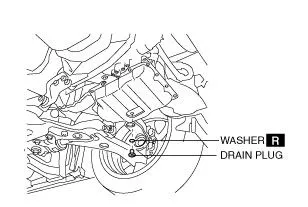

Thanks for the write up, I hope you don't mind me adding some screen grabs to this instructional again. The more we have the better for those who will follow along.
I grabbed a screenshot of the dipstick location and drain bolt location:

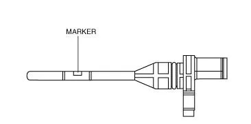

Once replaced run the vehicle until the ATF fluid is 122' F (50'C). remove the dipstick with the engine idling on a flat surface and verify the level is within the range on the dipstick as shown below:
Once in the marker range reinstall and tighten the bolt to 71-97 in/lbs (8-11Nm)

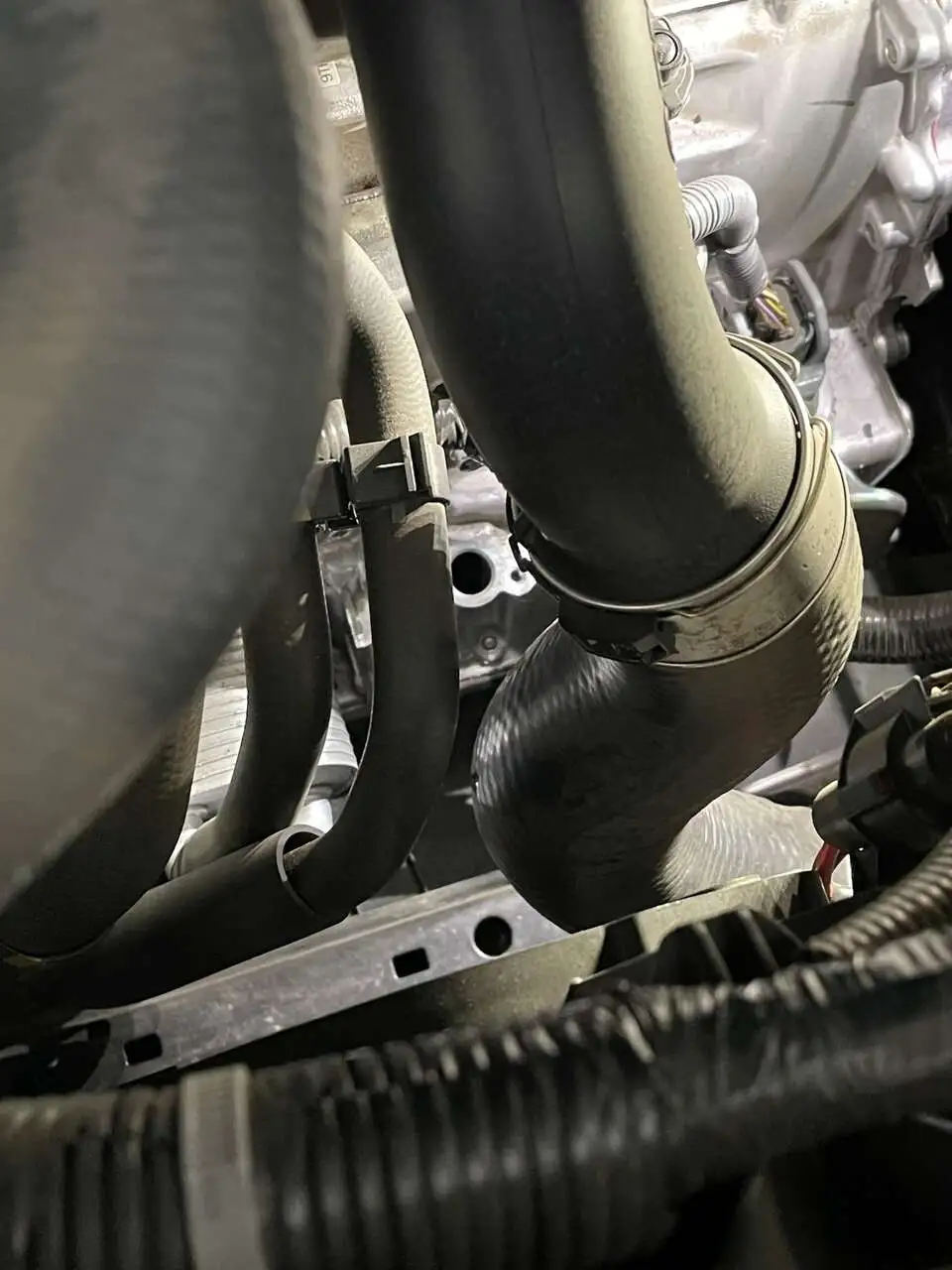

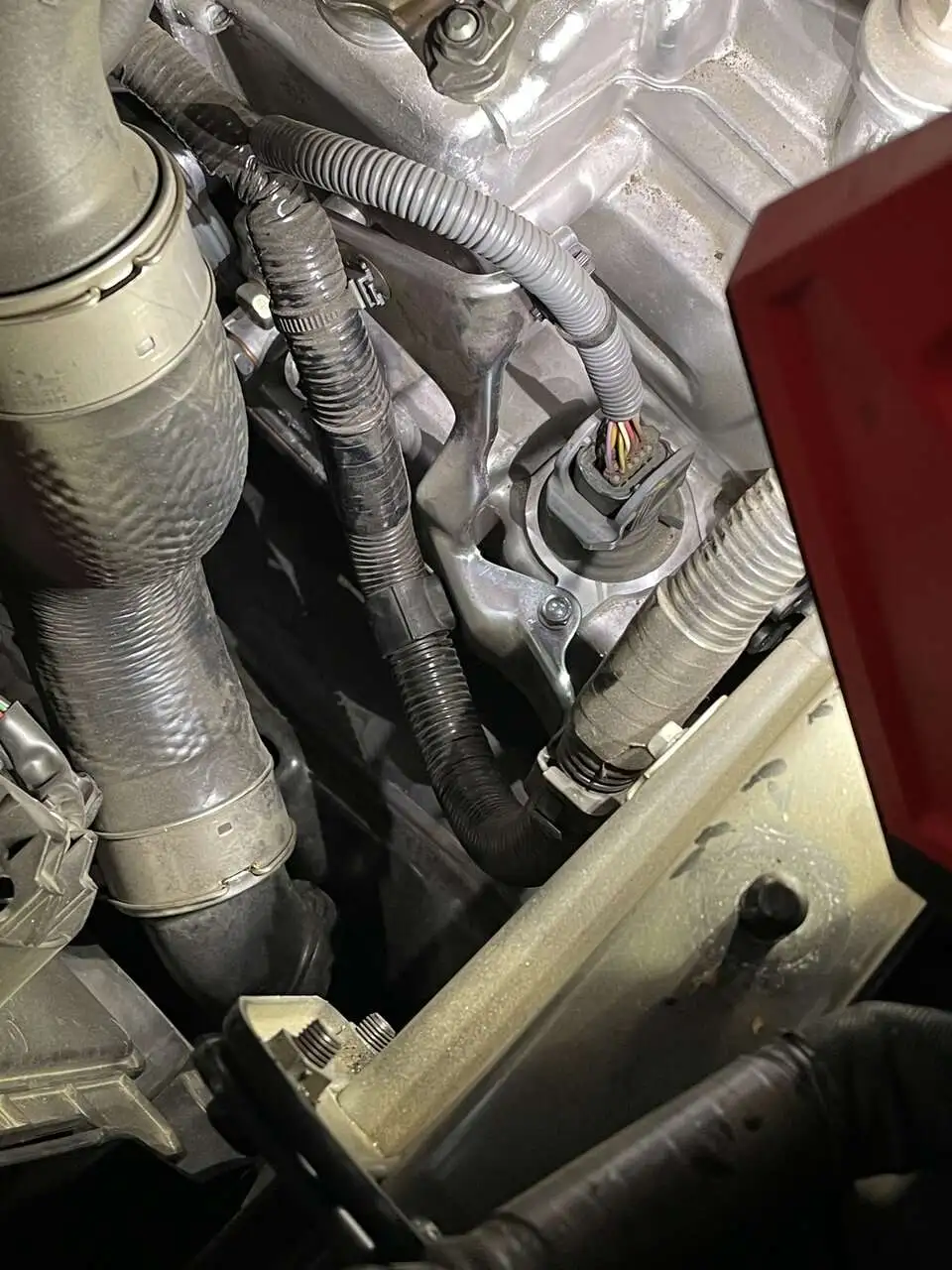

Sorry to hijack this thread a bit from the CX-9 crowd but I read a few posts in this thread that the 2.5T (GTR and Signature) CX-5 fill and level bolt placement is a huge PITA. I had a spare minute today and I wanted to take a second look for a small bolt I lost yesterday so I decided to investigate (RIP bolty mcbolt, you're gone but not forgotten you POS).
The fill/level inlet imho is not in an awful spot. You still need to remove the airbox and they recommend removing another metal bracket, but you don't really need to remove the metal bracket. You can access it just fine from the front or partially from the side. I removed the level bolt from the front pretty easily and it would be very easy to get a flexible funnel in this inlet.

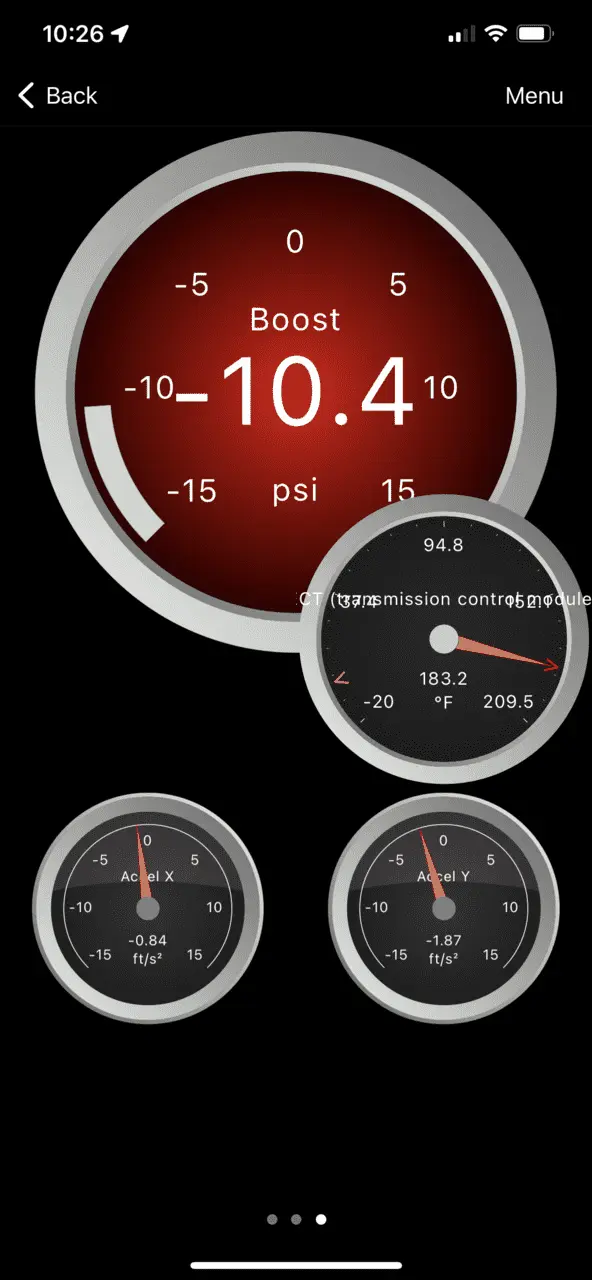

As for measuring the temperature. I found my bluetooth OBD scanner got the job done with OBD Fusion and the upgraded sensor reading package from OBD Fusion. All in it was like $20 for the bluetooth OBD scanner, $5 for the app and $15 for the upgrade package to support more sensors. It was able to read the ECT temperature just fine. I've attached a few pictures.
Picture 1 is looking at from the air box, the view is partially obstructed by the black tube next to that main electrical connector. You can remove that bracket to gain better access. There's two bolts, the one on the top is easy, the side one is a PITA, would not recommend.
Picture 2 is looking at it from the front of the car. The two black hoses on the left are very flexible and rubber.
Picture 3 is the gauge in OBD Fusion. The car had been on a while as I figured out all the app settings I needed.
Picture 1 is looking at from the air box, the view is partially obstructed by the black tub next to that main electrical connector. You can remove that bracket to gain better access. There's two bolts, the one on the top is easy, the side one is a PITA, would not recommend.
Thanks for posting your experience on checking the ATF level for a 2.5T. Can you tell us which bluetooth OBD scanner you’re using (or posting a link)?
“run the engine until the ATF temperature is 50 °C (122 °F),” also means that it is ok to read level at a little higher than 122F ?
Lets say when it is 122F then you pull out to check and insert it back in and pull out again so the atf temperature should be rising so the 2nd or 3rd read is higher than 122F?
Yes, very likely that’d happen. But the increase of the ATF level should be insignificant with the ATF temperature rises a couple of degrees above the 122°F
