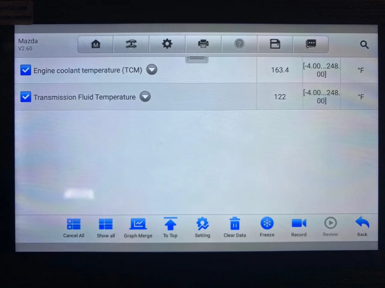

Has anyone found a way to know the transmission temp. Basically to accurately read the trans dipstick?
I know this is an old thread, but I just bought an OTOFIX D1 Lite Bidirectional Scan Tool on Amazon for $300 that allows me to plug into the OBDII and get live data, mainly I wanted it to show the transmission fluid temperature specifically to do the fluid swap and you want it to be at 122*F per manufactures specs. Otofix is made by Autel without paying quite a bit more for the name. I figured $300 for a good scan tool that can give me live data like this is better than not putting in the correct amount of ATF and ruining a transmission worth thousands.
The light turns off at 131°F coolant temp. No idea what that relates to in the ATF or oil temps though.
Not a good guide to go by unfortunately. When I ran my Otofix that shows engine temperature and transmission temperature, they aren't good to go off of and my guess is that it would vary also depending on weather and how long you have been running your car, etc. So when my transmission hit 122*F, where you want it to be for the ATF levels, my engine coolant temp was already up to 163.4*F. See picture below.

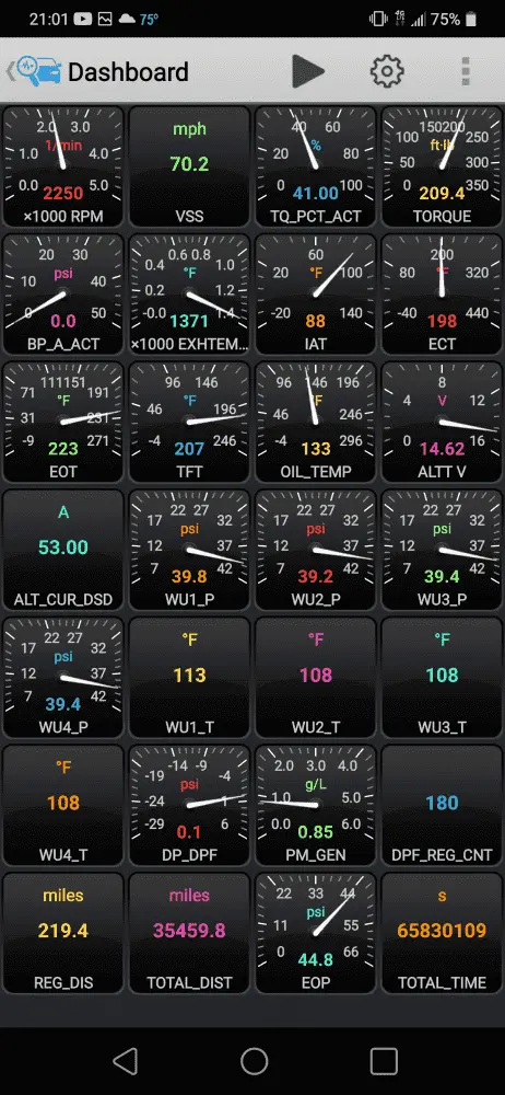

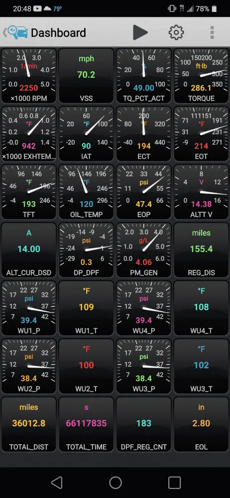

Of course many use (free?) FORScan Lite to get ATF temperature readout.
2019 CX-5 Diesel Aftermarket Transmission Cooler
THIS
I see many here are spending hundreds of dollars for expensive scan tools that they won't be using every day.
Forscan works very well, but the mobile app is limited unless you pay for it. The Windows PC version works much better and has better features, but it's kludgy to use since you have to lug a laptop out to the car lol
When I first researched this a couple of years ago, there were very few Mazda Skyactiv PIDs supported for the Torque Pro Android phone app. Strangely enough however, there was a free plug-in APK available for Android Torque Pro running under Windows on a PC (but not for phone Android at that time). That setup is extremely kludgy and slow, but it does support what I'd describe as a modest number of newer Mazda PIDs, and TFT (Transmission Fluid Temp) is included in that collection.
I used that Android Torque setup on the PC for a year or so, but then discovered that Forscan running under native Windows on a PC is light years ahead of Torque/Windows/Android, not only in the number of PIDs supported, but also in performance and functionality as well. Forscan is the clear winner in every respect, and very surprisingly, was avaliable as a free Windows download, when I installed it last year. However, the doc that I read at that time indicated that the beefy and free version that I downloaded (and am still using) was not available for Android phones. I believe that they also had a version available for Mac OSX, and something for PC Linux as well.
So that was the situation as of late last year, but I haven't checked since I did the download, and of course things might be quite a bit different today. The one caution I'll mention is I've seen a few ODB live data apps which incorrectly display ECT values as Trans Fluid Temp, in addition to ECT. The dead giveaway on this is when ECT and trans fluid temp are identical or very close to each other, during a cold start warm-up. The true TFT values should be quite a bit lower than ECT values for virtually the entire warm-up.
That's because Forscan is an imitation (not a clone) of the M-MDS / Ford IDS software Mazda used to use at the dealer and still use in some iteration for late model Mazda up till the most recent couple of years.
With a proper/good quality ELM327 adapter, you can do basically everything with it, including some hacks to change some software parameters on the car. I added i-DM to my 3 this way.
