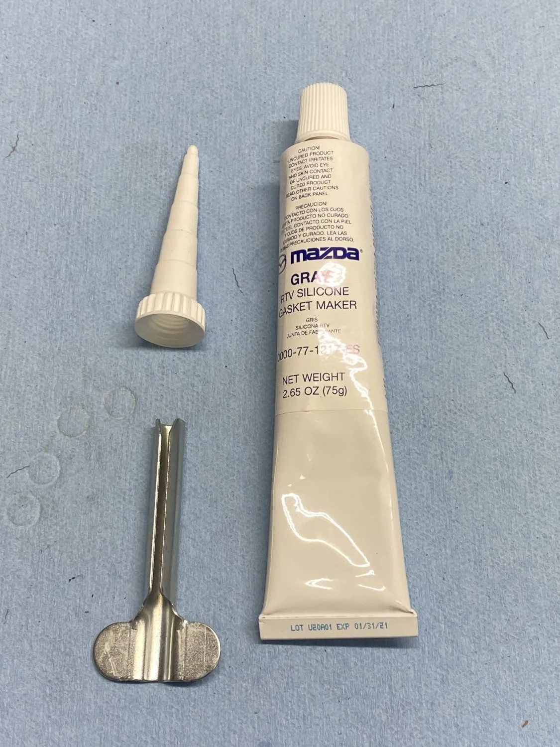

Just an FYI to you younger folks (I am 66) that are amazed at the "key" to squeeze out the RTV sealant. They've been around for decades and were commonly used, at least in my "always use everything to the last drop" household, to get all the toothpaste out of the tube!
You can get a https://www.amazon.com/dp/ (commissions earned) on Amazon for cheap! :cool:
Yeah I figured it was nothing new and figured they were available on Amazon. I’ve just never seen one before. When I opened the package it took me a couple of minutes to realize what it was for. Then it hit me and I was like ohhhh dang that’s cool! :ROFLMAO:

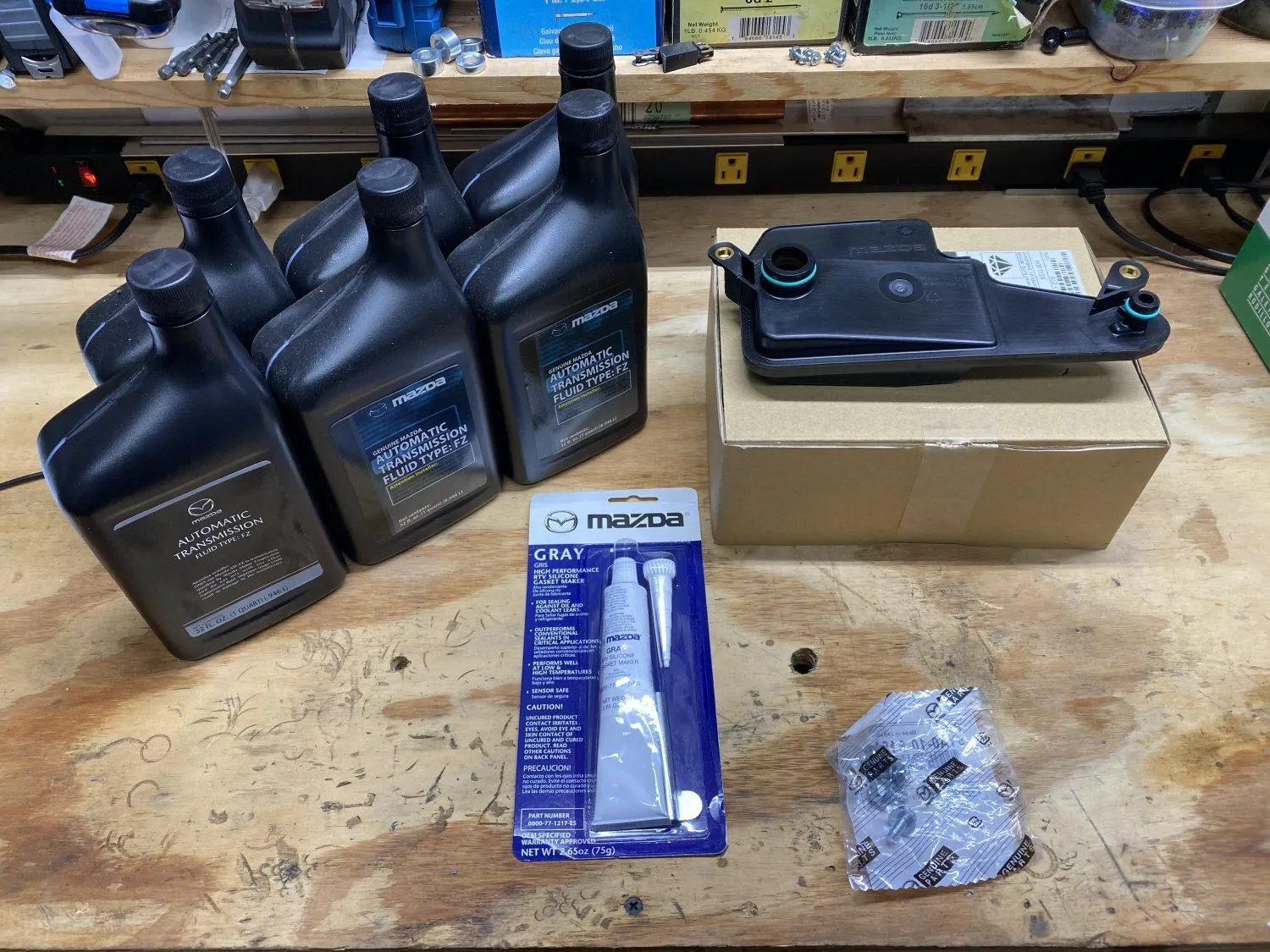

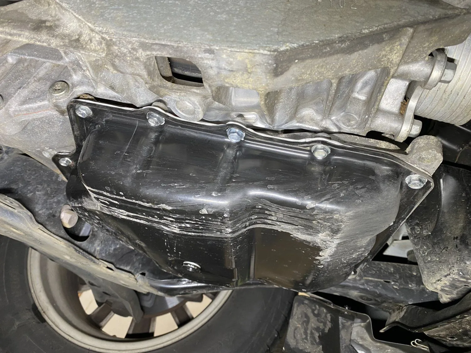

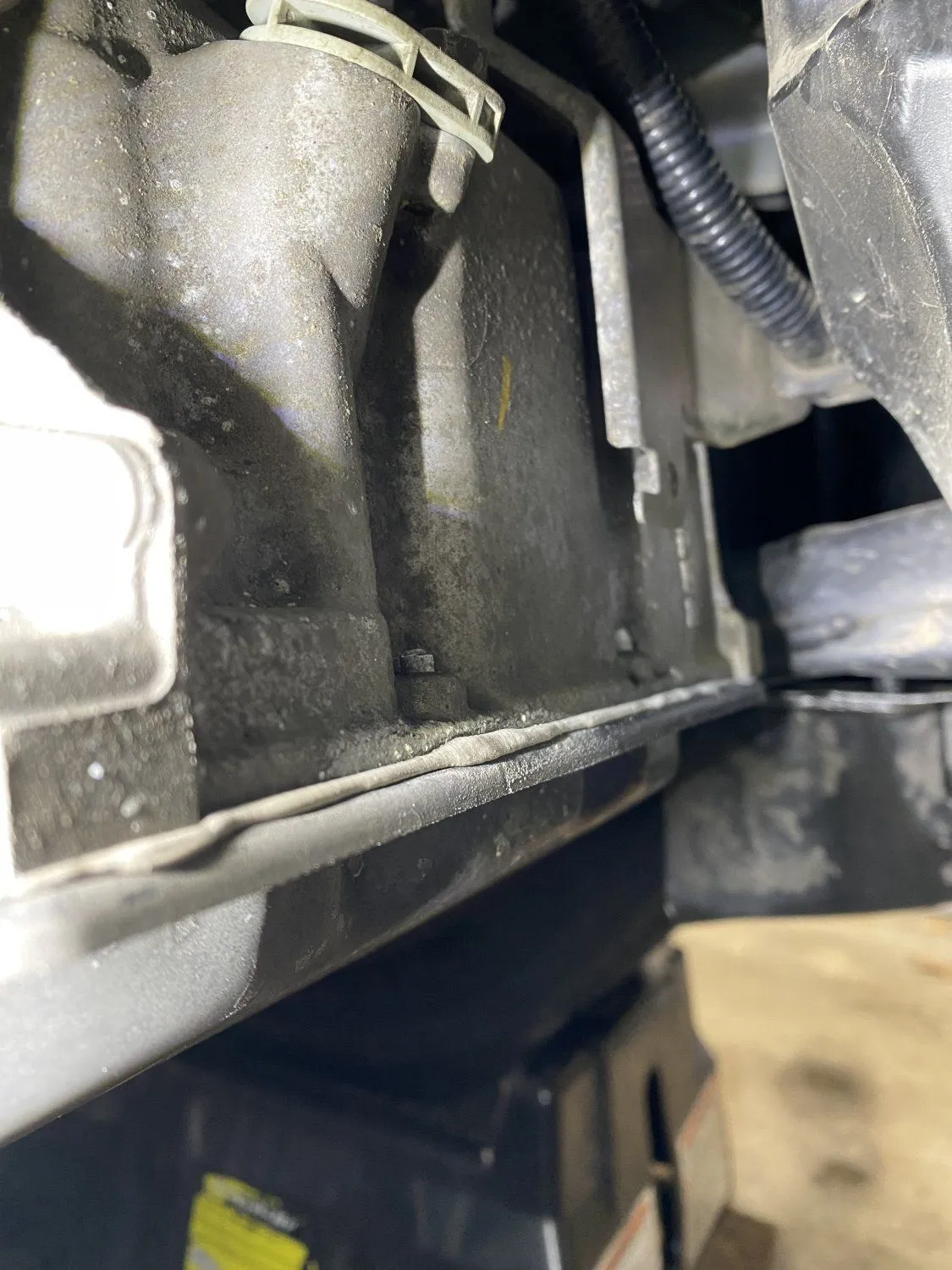

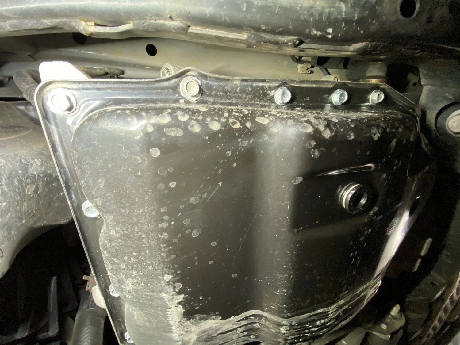

Have you actually double checked the condition of new OEM sealant on ATF pan? Any sign of ATF leakages?
Do you plan to get OCV from partsouq in United Arab Emirates for much better price?

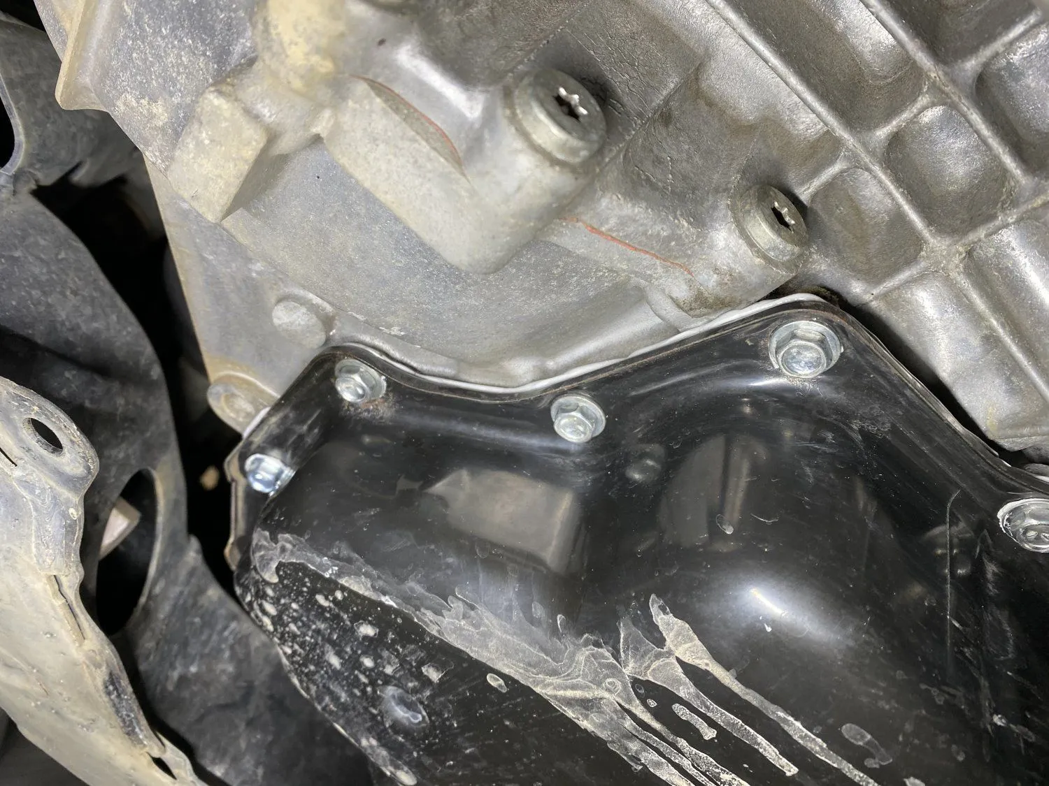

No, haven't had a chance to put it on ramps yet and remove the lower cover. We got back in town Sunday before last just before the ice and snow hit and the car sat in the garage for a solid week until this past weekend and I was too busy this past weekend.
Just checked it out, dry as a bone! Looks like I have a perfect trans pan seal. We’ve put about 1,200 miles on the car since resealing the pan 3 weeks ago.
What rtv did you use?
check out the previous page. I went with the OEM Mazda sealant, which looks and smells exactly like Permatex Ultra Grey RTV sealant. I followed the Permatex directions of going finger-tight on the bolts, waiting about an hour, then torquing them to final spec, and then waiting until the next day (18-24 hours) before starting the car.
The little tube key that helps push the sealant out, that came with the Mazda sealant, came in really handy.
Just noticed that the expiration date on your Mazda OEM silicon sealant is 1/31/2021, but you did the ATF pan sealing job on 2/6/2021 ⋯ :rolleyes:
