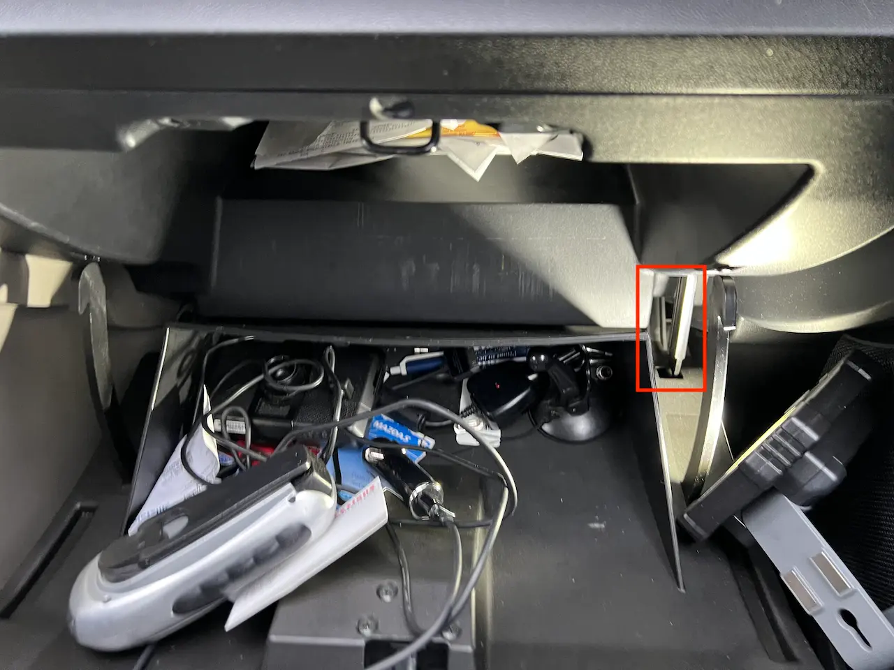

This post says the glove box can be removed in seconds. I tried, unsuccessfully. The side arms come out fine, but the "little arm at the bottom that does the soft [close] you need to remove that little arm from a little ball that's on the glove box side." isn't working for me. I can't get the little arm off the ball. I tried pulling left and right, up and down, jiggling it, and it isn't moving. Below, see my photo with the little arm in the red box. What am I doing wrong?

(Photo of glove box)

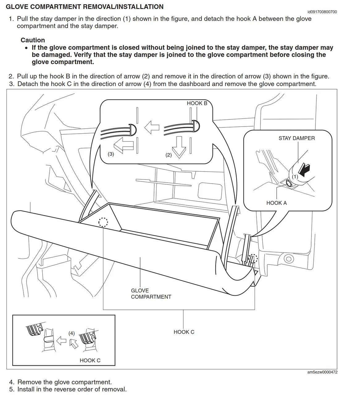

This is for a Mazda3...but it looks about the same:
Does that help?
I should have mentioned that I used that video to guide me on my attempt to remove the glove box. The Mazda5's is a bit different, the little arm on the right is on the outside of the large arms. but I still was not able to get it disconnected,
