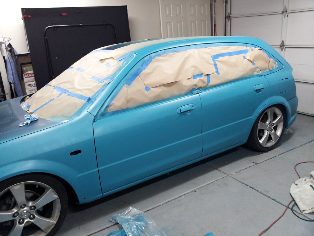

How far did you disassemble the car? Did you remove door handles and everything? Did you paint it with the bumpers and hood on the car? Or how much of it was just carefully taping off window trim and what not? I am curious about the paint, since you said it went on thick, did you have issues with small spaces and it clogging, particularly creases between door handles etc.

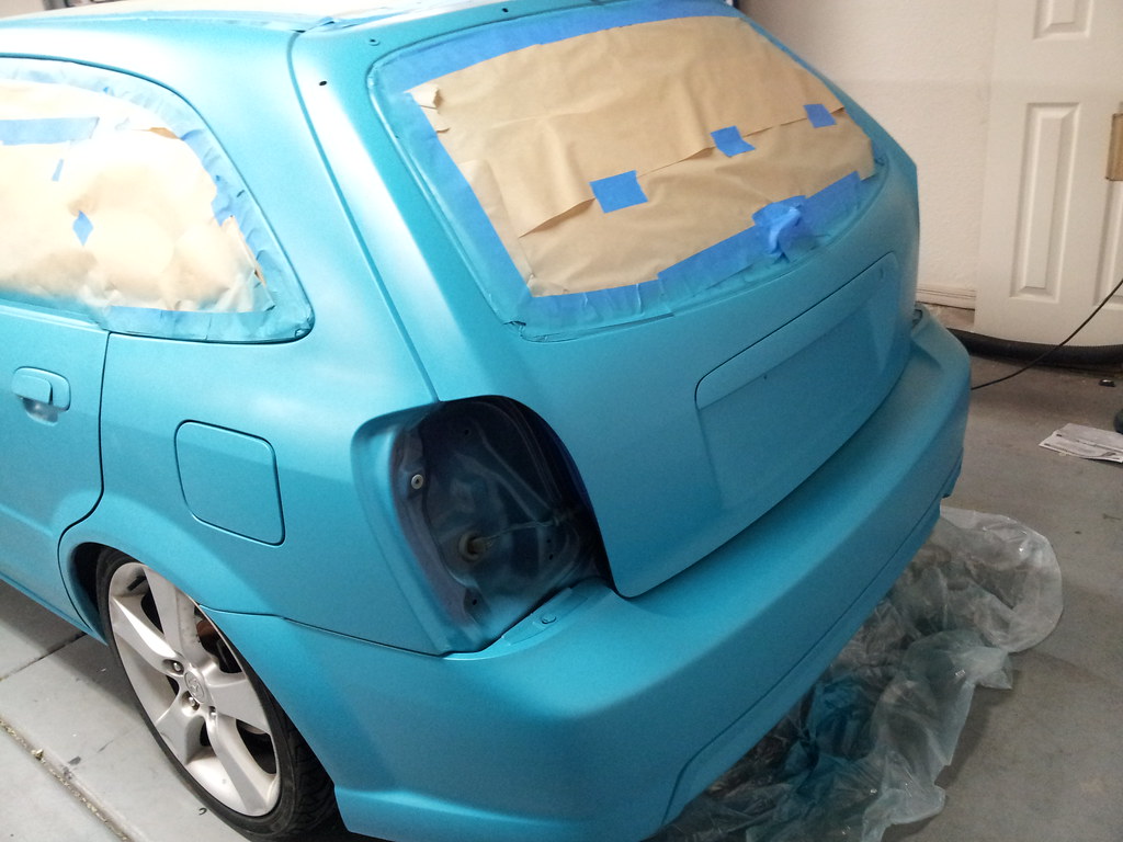

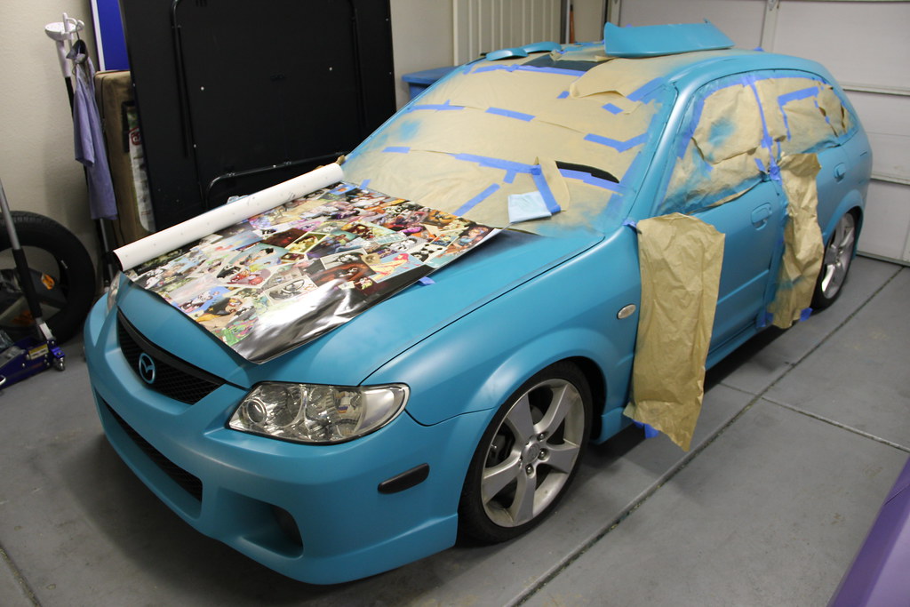

I removed my most of my interior panels so that I could remove my headliner to unbolt the 12 nuts that hold the roof rack on and to remove the FM antenna. Pulled the roof rack off. Removed the front bumper and all bumper lights, removed the headlights, removed the taillights, removed the wipers, removed the cowl, removed the rear spoiler, removed side mirrors and mirror caps, removed one side skirt (but broke every single dry-rotted plastic clip that holds it on so I left the other one on for paint.) Removed the front inner fenders... I carefully taped off and papered the windows and window trims. for the door handles I just wedged small nuts under them to hold them out on a near 45 degree angle so that I could paint every part of them and so paint didn't build up in the cracks. When I painted the doors I would tape and paper each door individually so that I could focus on a smaller area. Trying to do the whole side at once will never work good with a rattle can. I tried it on the 1st can. Overall the best way was to paint the car in sections. I also covered the entire engine bay with a plastic drop cloth. same thing with the ground in whatever area I was painting. I also cut open big black garbage bags to make covers for the wheels and tires.
I also pulled my hatch emblems and decided to have a friend weld up the holes and help me bodywork over the shaved holes. Used some high-build primer and sanded, used primer and sanded again then again a 3rd time so that the body filler didn't soak up the paint when I sprayed it.
Another thing to take note on is that I never intended to paint the roof or the main center of the hood. Those are also the 2 hardest parts of a car to rattle can and get an even finish because all your paint dust is just falling straight down onto the rest of what you just painted. I took a lot of time trying to find the right angle to spray the hood in the areas that I did spray it but since I did the 2 sides of it and the center front as sections it came out pretty good after a few tries.
Here are some mid work pics to show some of the masking. The finish was not ready yet so you can see some blotchiness on parts that I had to overcome with additional coats. Any spots that look blotchy were fixed before I de-taped and put the car all the way back together. (DON'T SPRAY AT NIGHT AND DON'T SPRAY WHEN ITS RAINING OUTSIDE) You'll just be wasting your time. Cold and moisture don't help.
