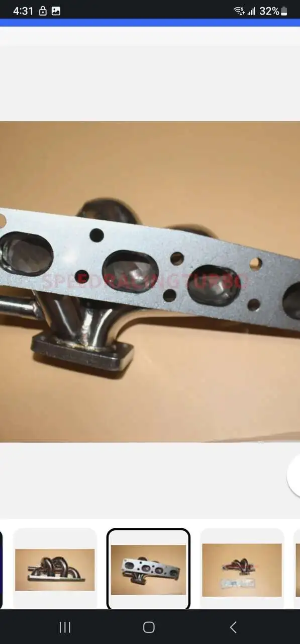

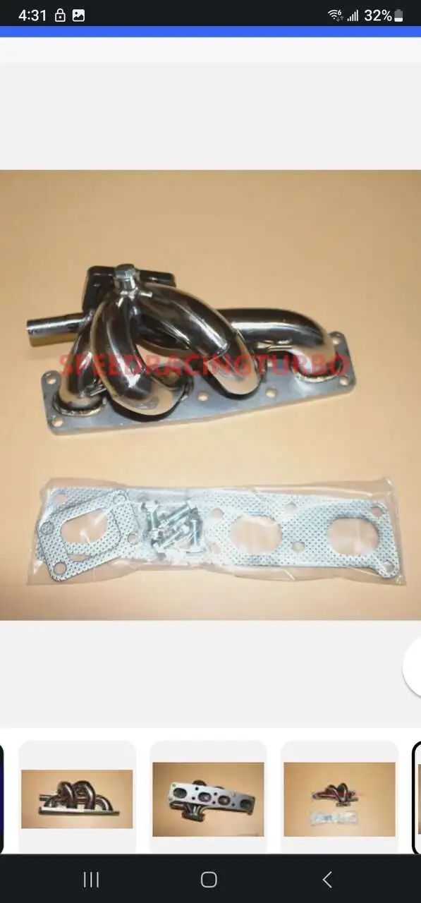

On top of this I want to get a header because the oem calaway manifold is cracked and a down pipe as well
Questions I have

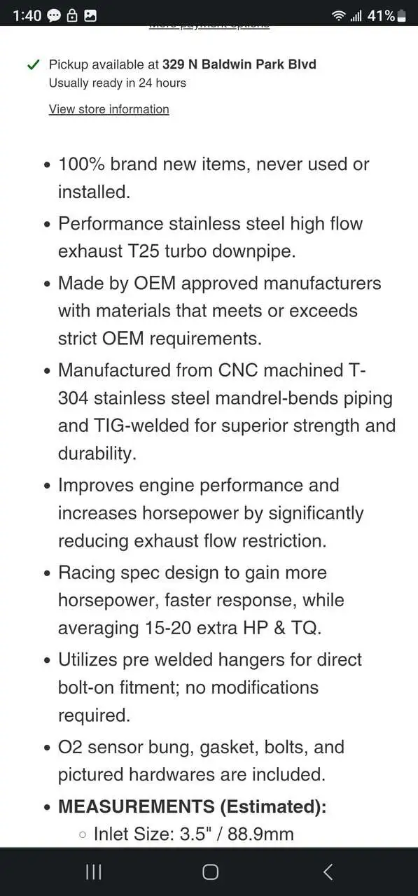

Is the oem turbo with calaway manifold and downpipe a t25? Because there's a downpipe that's says it's for a t25 turbo
Wanted to see if it will fit oem turbo
Also header I found for cheap but will be reinforcing it with welds and brackets
So wanted to know if these would fit it
That manifold and Downpipe are direct fit for the MSP Turbo. Just be aware that those cheap manifolds are prone to cracking. I bought one years ago to turbo my miata, every 2-3k miles there would be another crack, this was after reinforcing it and making a custom bracket that supported it to the block. I ended up make a duplicate of it using schedule 40 stainless pipe, never cracked again. I purchased that Downpipe for my MSP. I haven't gotten the time to install it yet, quality is definitely MEH but with the proper tools to modify it there is potential for the price. You would most than likely have to modify it a bit to be able to get a nut on that middle bottom hole on the 5 bolt flange, its tight.
