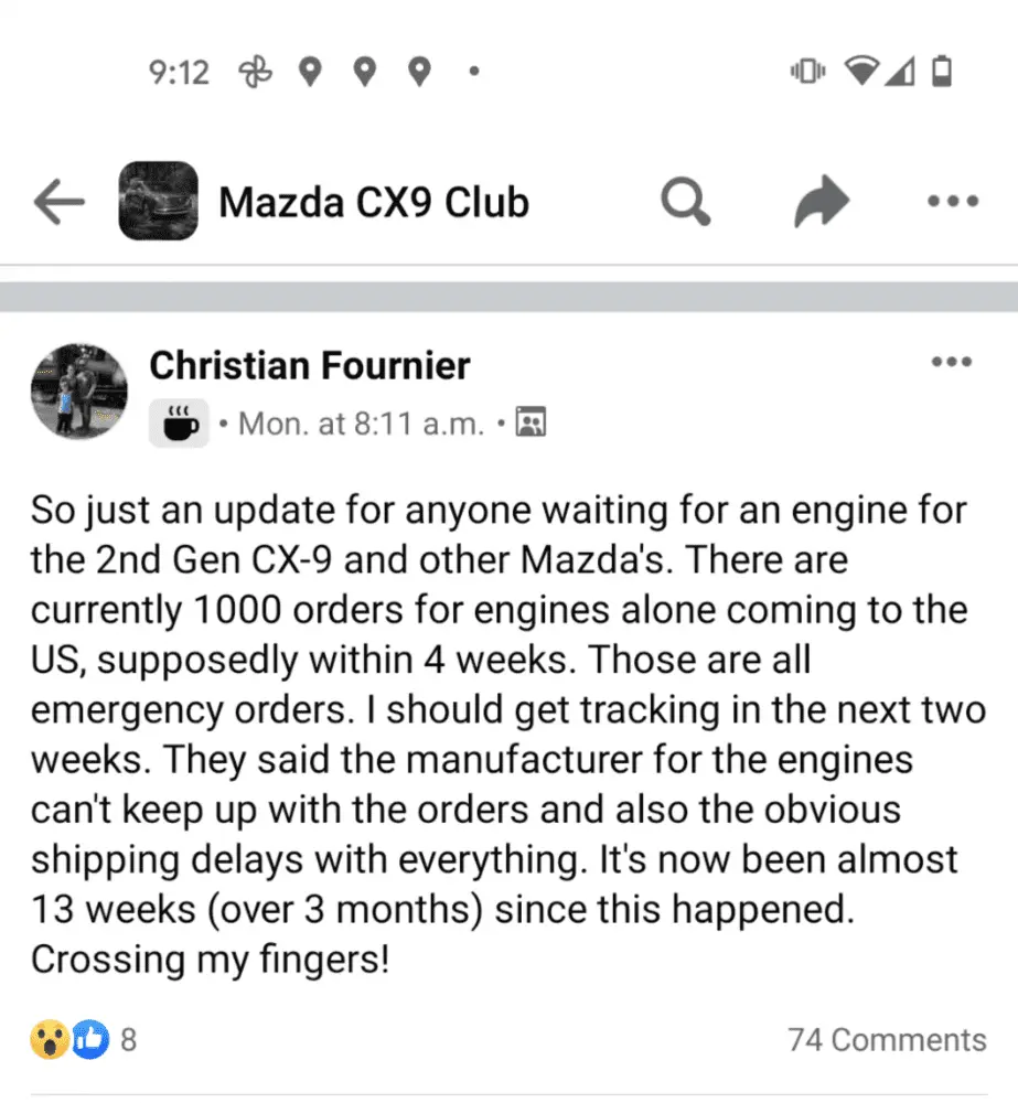

Saw this on Facebook
Without some sort of verification from Mazda or a lot more people that are supposedly receiving those 1000+ engines, I wouldn’t trust a FB post. Who is this guy? At any rate, let’s say they are correct and this is the second half of all the engines that have been replaced, that’s still 2,000 out of 145,019 sold from January 2016 to July 2021. That gives a failure rate of 1.3%. Even doubling that to 4,000 engine replacements is only 2.6%. While it does suck for those that need to get their engines replaced, and I do feel bad for those that have to go through it, it still doesn’t seem to be widespread enough to really worry about. Keep some healthy awareness that it could happen, but I wouldn’t expect it to just be a matter of time. Maybe in two years I’ll eat my words and the vast majority of the pre-reinforced engines will be replaced, but I just don’t see that happening.
