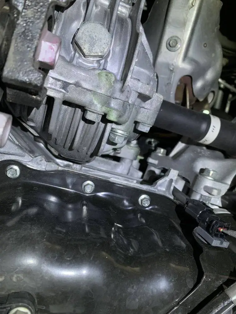

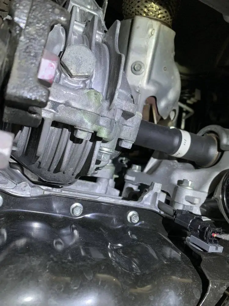

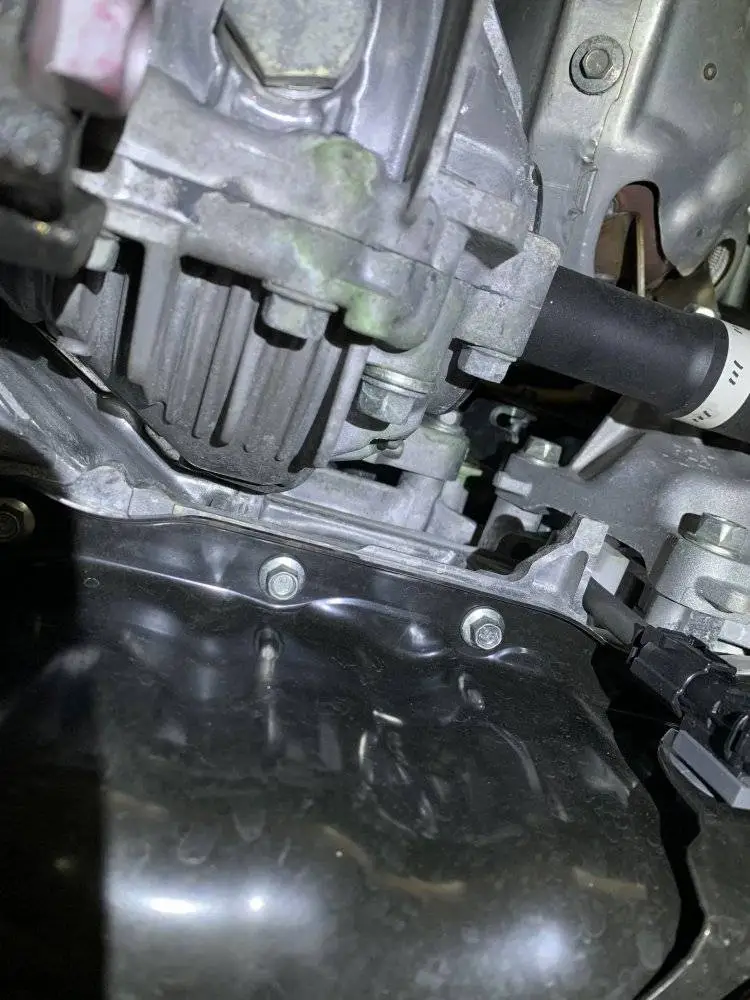

Hey guys, I started intermittently smelling coolant after driving but I never saw anything on my garage floor. This has been the case on and off for a few weeks. I finally got time and crawled up under and pulled the skid plate. Im attaching what I found. I’m asking for your opinion if I need to take this in or if I’m trying to make a problem of something that isn’t one. I see dried up green on the transfer case and one other place. I don’t see anything wet, but the car has been off for a few hours and so I’m wondering if what I see could be from the environment around me. I live near DC, so it’s humid in the summer and snow/ice chemicals in the winter.
EDIT: I can confirm I do not see this same green on the rear differential, so that makes me think it’s not from my driving environment.
I have a 2018 GT AWD with just over 40k on it, and I’m the only owner.

I would be bringing it in to a local Mazda dealership. Let them know you've been smelling coolant. They should put it on a lift and investigate further.
Better safe than sorry.
That’s what I figured. I don’t love my local dealer but if they try to run me around, maybe I’ll just trade it and get something else. I’ve had a lot of issues with it in the last year and I’m losing patience.
There's definitely a leak somewhere. Press them with an explanation because a 40k mile engine shouldn't leak anything. If they give you the run around, contact corporate. Good luck.
I’ve been in touch with corporate once before. They weren’t very helpful either at the time. Their solution for my misfiring was to offer me employee pricing to buy a new Mazda.
