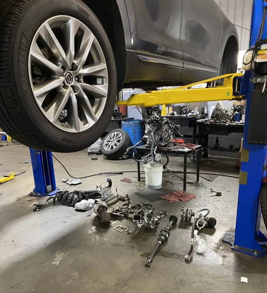

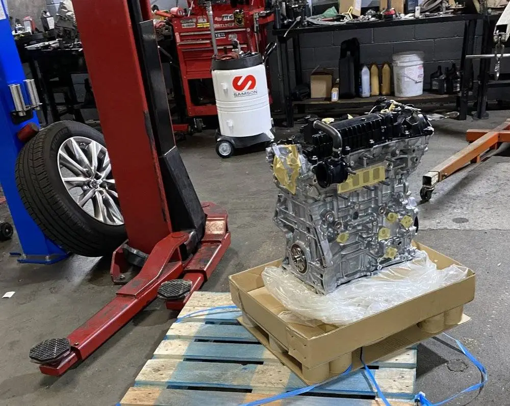

CX-9 engine replacement update: I got a call from my service rep at the dealer and looks like the engine is going in and I will get the CX-9 back late Tuesday of next week. Attached are pics of the new engine and another showing everything pulled off the old engine, tranny on the bench. 3 months in the making, finally. Will be glad to have her back!
