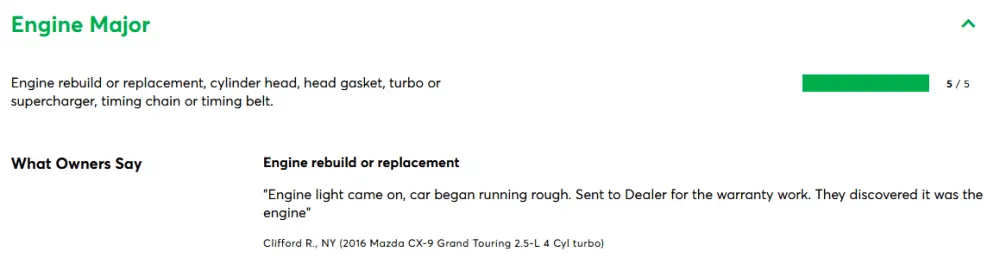

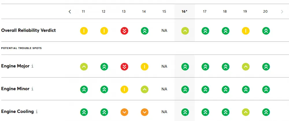

You have to wonder how many people came to this forum only because they had the leaking coolant issue in the first place. This will greatly skew the numbers in one direction. The only real way to get a feel for this is to get a list of CX-9 owners and randomly select a group of them and ask them this question. That's not really gonna happen though. The next best thing would be to get a dealer or a (former) dealer mechanic or Mazda staff to discuss this. Also not likely. I'm gonna go see what's being said over at Consumer Reports. I have a membership. When I bought my CX-9 back in January of this year, there wasn't much chatter of engine failures for any model years from 2016+. Maybe that's changed....
So possibly one report so far on CR (is warning light something people are reporting alogn with the leaks?) Whatever it was it didn't seem to have affected the overall rating and who ever posted that still gave it a rating of 5/5? Or am I misreading that?!?
I think Cr suffers from the same thing we are, low feedback numbers. There could be 5 people that filled out a CR survey for this for all we know. Ugh.

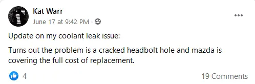

Someone posted this on the Maxda CX-9 Club group:
So, that seems to jive with what people are saying, that the block itself cracks. You gotta wonder what could cause a block to crack though, and why it seems like Mazda has no preventative steps in place. Is it just a manufacturing oopsie that will just affect a small random group, or is it a design flaw that could potentially affect everyone. I would have expected a change in the head bolt torque spec or something along those lines. Not cheap, but you'd think it's MUCH cheaper than replacing even a small handful of engines.
