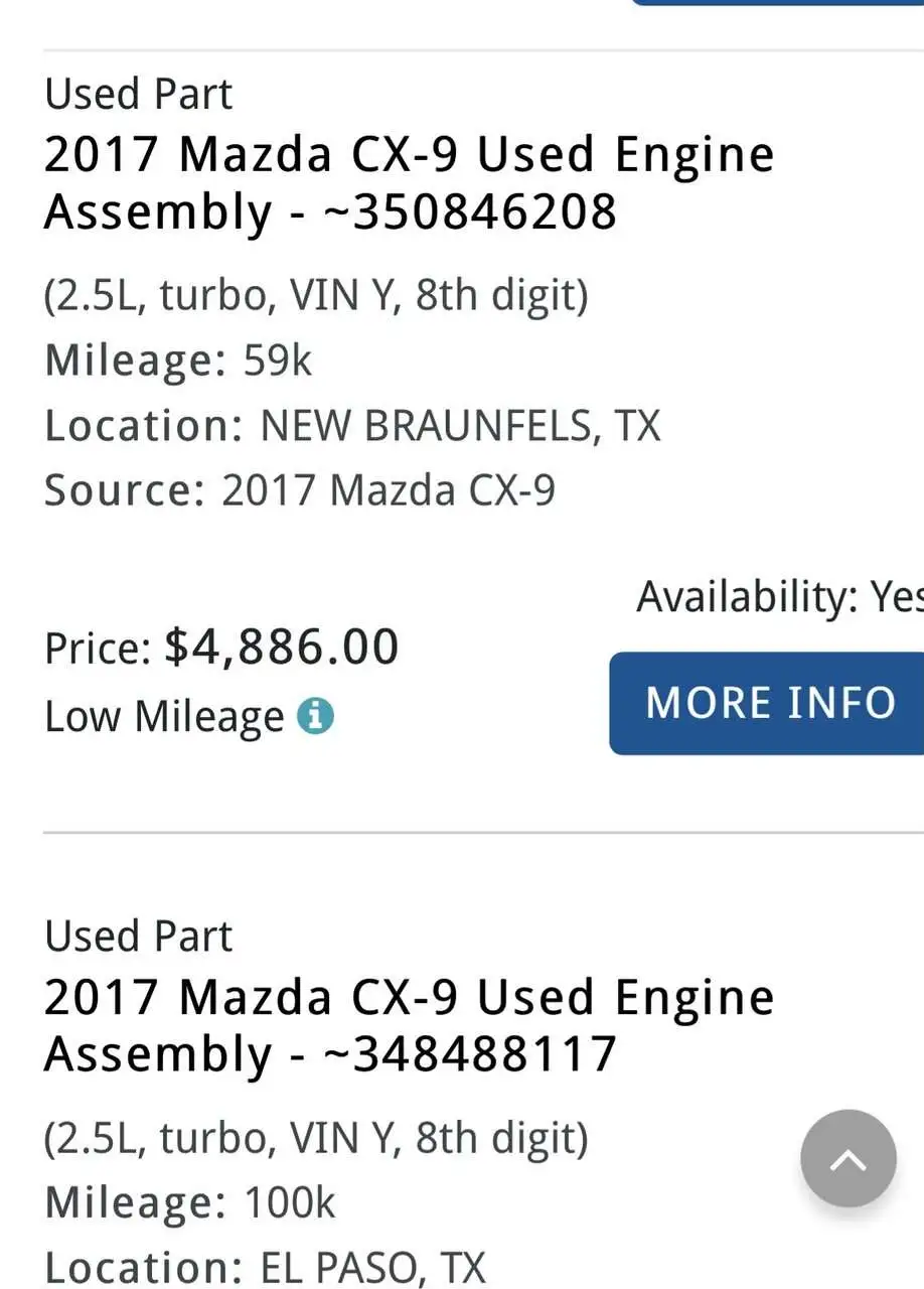

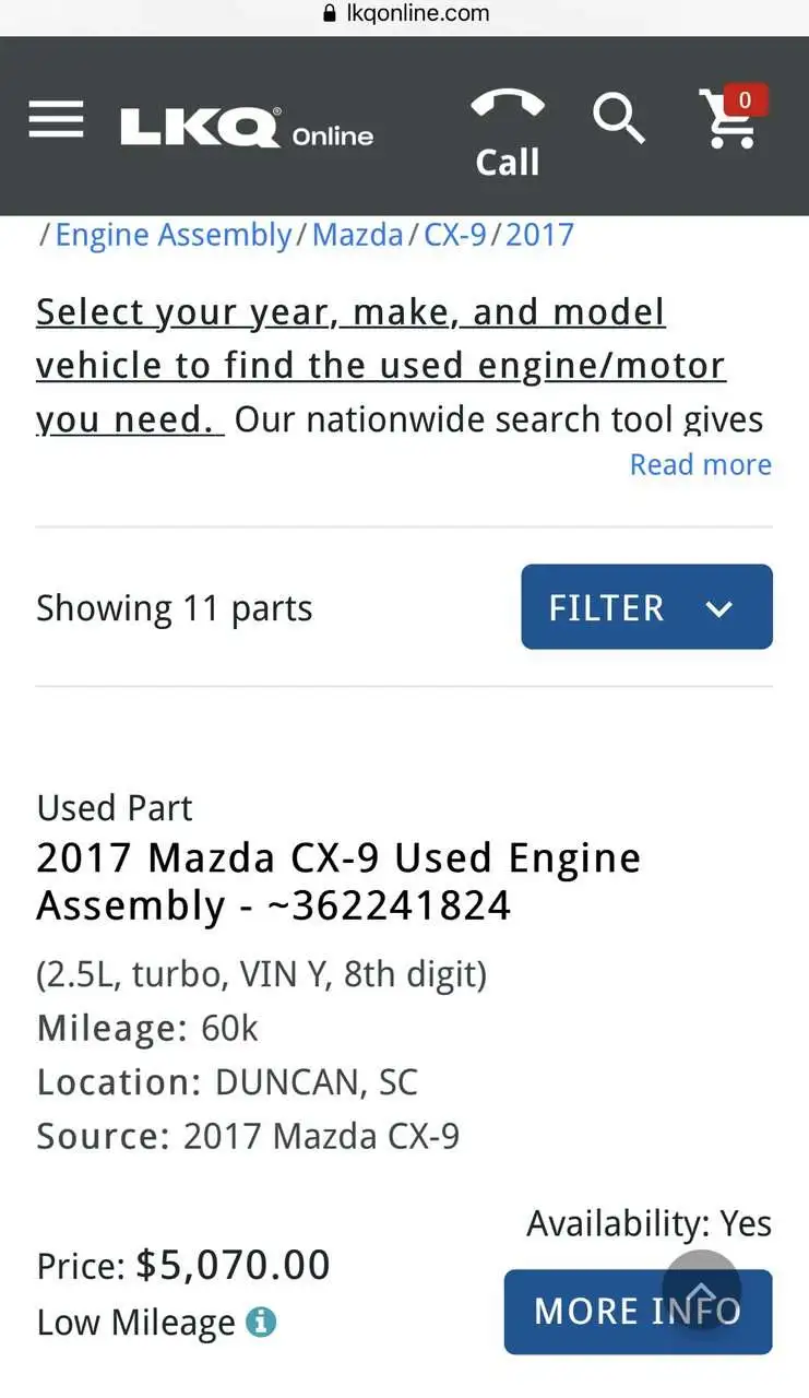

You don't have to pay $8k, you can source a used engine, or buy the required parts outlined in the TSB and then have a reputable independent shop replace the engine or replace the cracked cylinder head. You might pay half of that.
I used to suggest getting a used engine to replace the damaged one under this unfortunate situation. But boy how the thing has changed after pandemic with the crazy inflation! It used to be $1,000 ~ $2,000 for a good used engine, sometimes I even saw hundreds, now it’s $5,000 and more!!! With additional labor charge from a reputable indie shop, it could be very close to $7,000 nowadays to go the used engine route. I can longer suggest this route unless the price on used engines drops to the pre-pandemic level.
The only cheaper way to get out of this unfortunate situation is what @AutoDesignR has done, buy all the parts listed in the TSB for $1,000, DIY to remove the engine, and replace the cylinder head and exhaust manifold gasket with the updated ones. Try to find an indie shop to do this for labor may be an alternative.
Sorry for the difficult situation @Mazda_petal has encountered and looks like there’s not much she can do but take a big loss.
Whatever you decide to do, document everything with receipts and paperwork. Class action lawsuit is still available as I believe more owners will experience this failure over time. A good attorney or pressure on Mazda from NHTSA when someone gets injured or killed in an accident that results from engine failure could result in reimbursement from Mazda.
Need to do a $25 oil analysis to see if coolant contaminated the oil. Also scan for overheat codes. If no to both you could do a head replacement with a new updated head assy. The parts cost about $1200 max, the rest is labor. I think book on a head replacement is 17 hrs. Best to drop the engine out on the subframe. Find a REAL mechanic. Not a dealership
So an engine with 60K on it is $5K. But a new engine from Mazda6 installed at the dealer is $8K? Not a chance in hell I'd ever do the used option. Installed, that used engine is probably $6,500-$7,000? That's insane.
