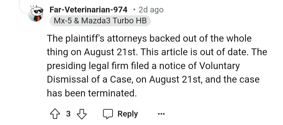

Doesn't sound like it is.
I am not 100% sure this is the case, because there are multiple different lawsuits. Does the reddit article confirms exactly which one is being cancelled?f. You might be right, but i still have some hope. Examples:
