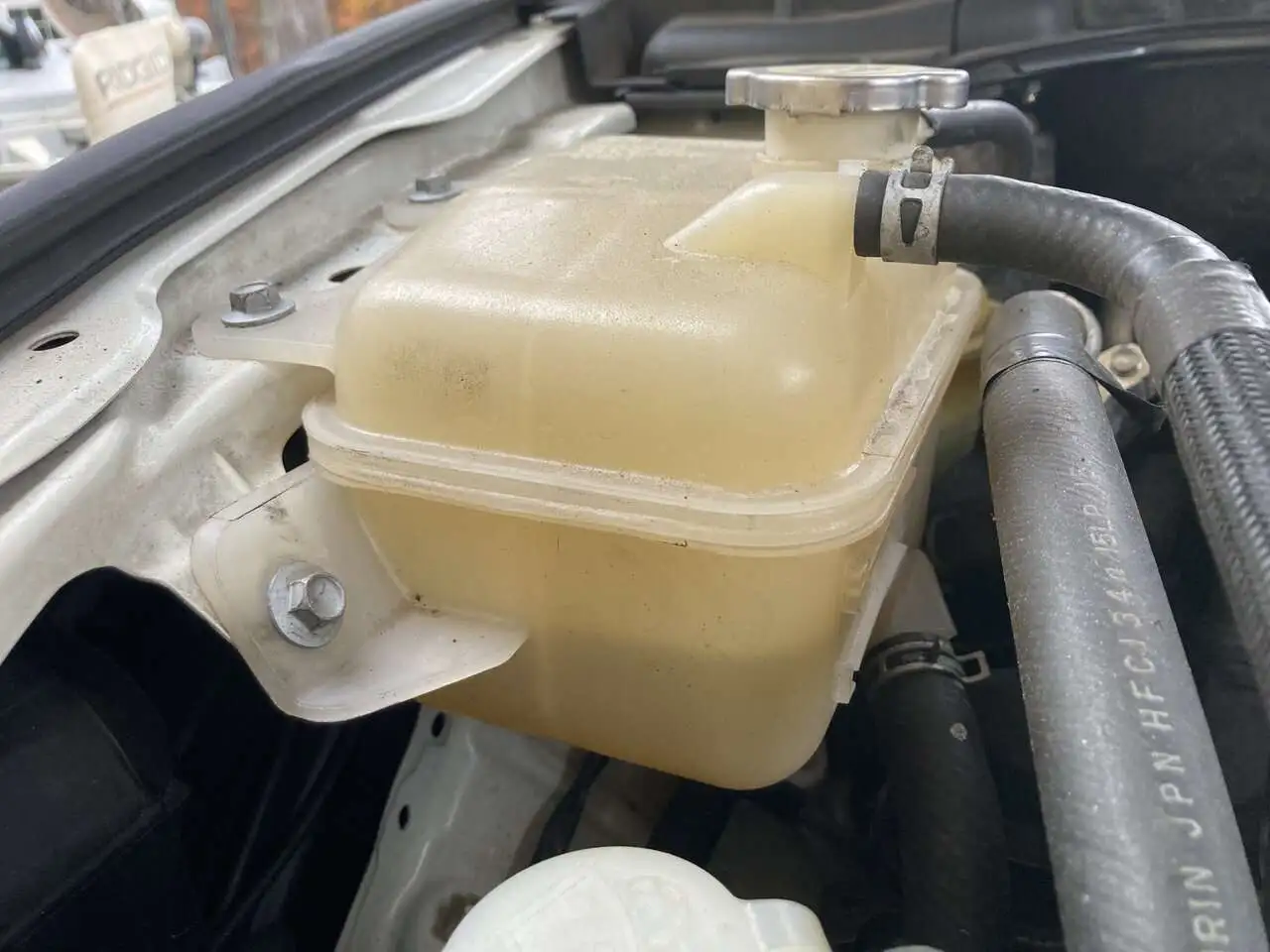

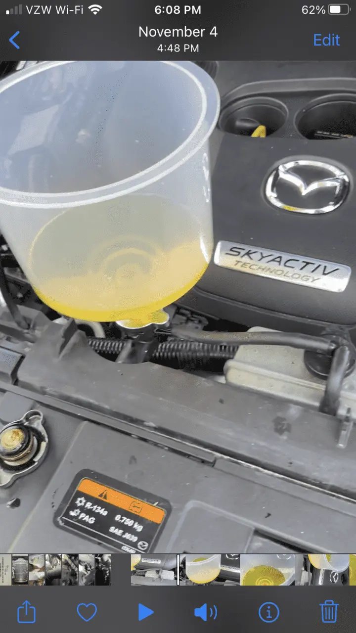

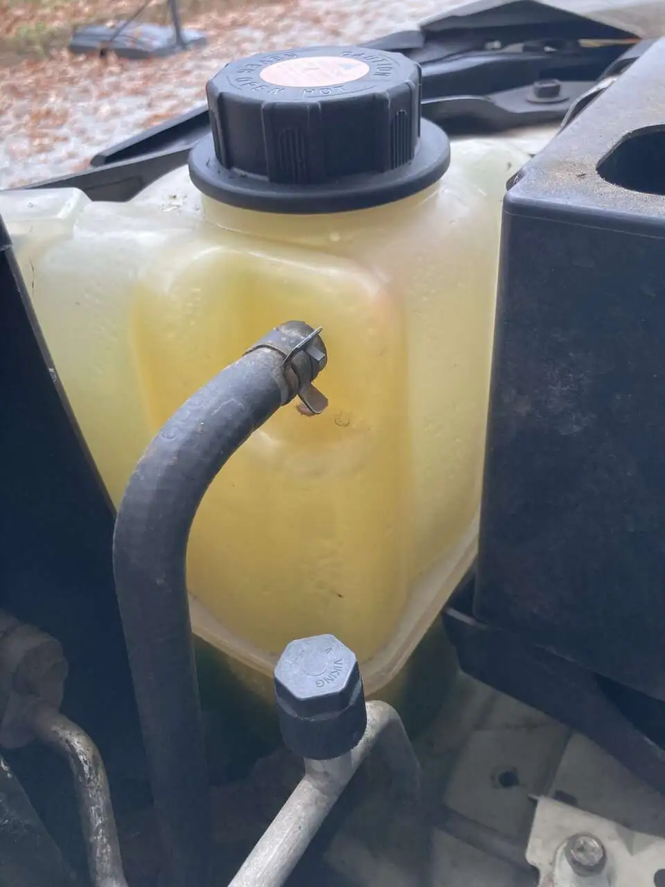

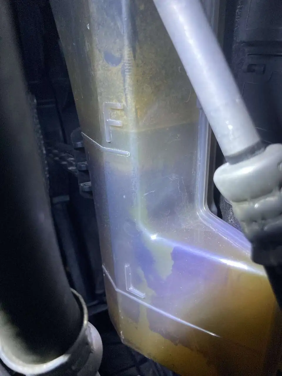

Something hit me late last night that I'd like to get everyone's opinion on.
When I did the coolant flush and fill after we bought the car, I thought the coolant overflow tank was excessively "gunked". There's a brown film inside the tank that I was only partially able to clean due to the odd shape of the tank. Since discovering the coolant leak at the rear of the engine, I'm thinking the coolant has been getting exhaust gases in it for some time now. The film in the overflow tank could very well be an indicator prior to the crack/head gasket leak growing to an external coolant leak.
Has anyone else with the coolant leak at the rear of the engine observed this brownish, caked on film in their coolant recovery tank? Might also be a point of proof to the Mazda "Stealership" that the issue was there before the warranty expired.
That film in my coolant recovery tank is not normal. Gotta believe it's related to the leaking coolant issue. Any thoughts?
I checked the coolant overflow tanks on my 2005 Titan with 170k+ miles - tank is clean. 2011 CX-9 has a clean tank with 195k+ miles. 2016 CX-9 with less than 115k miles has “exhaust” film in the tank. The video is the Skyactive 2.5 with a radiator fill funnel in it. Once the engine warms up and the thermostat is open, the coolant starts to burp exhaust gases. My theory is this has been going on for some time prior to the leak showing up. The film is above the Full mark indicating there has been a dirty “gas” in the coolant tank.

That’s my point. The tank is so nasty, you can barely make out the coolant level.
I use Peak antifreeze in all my vehicles, so it’s yellow. Every manufacturer “sells” their own special spec fluids and they all claim you have to use their stuff if you expect them to honor their warranty. I’m well past them honoring any warranty so I get to choose my fluids now. The Mazda Stealers make a ton of money selling their fluids to folks who think they’re getting something special.
